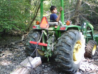

Picture of my son pulling logs out of the creek......yes we did use chains on the 3PH draw bar raised up, but this allowed us to clear all the stones etc. that would have snagged the logs and caused problems.
If the safe/correct way is to hook onto the lower draw bar, how do you keep the leading edge of the logs raise to prevent them from digging in and causing a problem?

There is no substitute for understanding what you are doing and the forces involved.
If the tree(s)/log(s) you are skidding are quite small compared to the tractor then raising the wood above the ground is a good thing and you won't hit a stump or rock and get into trouble.
It is when the log(s) are getting to the size/weight which require so much pull from the tractor as to constitute a realistic threat to safety through a backwards flip that extra analysis and caution are so very healthy.
Many of the arguments presented are involving "edge of the envelope" scenarios which are better avoided. B U T if you do find yourself there, try to be reasonable, go slow and be prepared to abort if the log is just too big for the conditions you find yourself in. Pulling from below the level of the axle is THE RIGHT WAY.
I like the garbage can lid idea, sort of... An extension of that idea, a little purpose built "travois" made of scrap pipe could be used to keep the end of the log from plowing dirt and hitting stumps and rocks. The sloping front of the travois would help climb the log over obstacles as well as keep it from plowing. Could take a couple dollars worth of scrap pipe and a few minutes cutting and welding.

Logging arch. Logging winch. Sled for the log nose. Several tools to choose from. At least you have a ROPS on your tractor. :) Make sure you always wear your seatbelt.;)
   / Where to connect a chain to pull trees/brush #48
Champy is doing it the right way. Hook the chain short and use the 3PTH to lift the front of the log. This will prevent it from digging in and in turn transfers weight to the rear wheels for traction. Or, just pull from a clevis in the stationary drawbar. Go slow and avoid driving over stuff like stumps and large rocks. If you have a gear tractor, avoid the lowest gears. Run the engine RPMs at half throttle, or less. Half throttle also applies to a HST. That way you will not have enough power available to pull the front end up. The engine will stall if for some reason the load stops moving. Most of the time you will not have enough traction to lift the front end, anyway. The rear tires will spin in all but the most extreme situations before the front end comes up. I can imagine that a lot of accidents occur because someone was in a low gear and at WOT. 3 mph at half throttle is a lot safer than 3 mph at full throttle. That power can get you in trouble fast if you don't know what you are doing. In spite of what you may hear, tractors are pretty safe when used as intended. Go slow, be cautious and have fun. Good luck.
