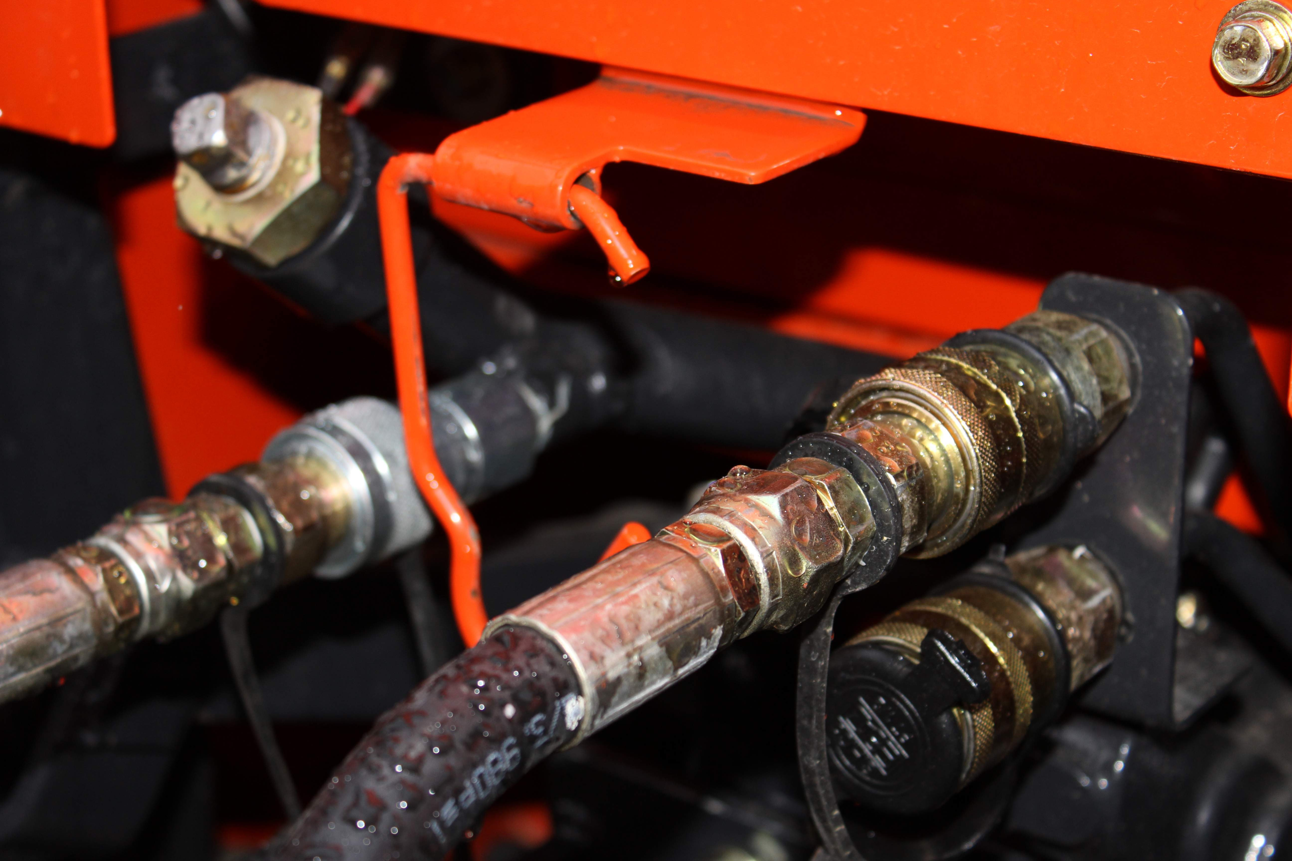

The scan of the page and the pic should be more than enough to ensure we are all on the same page. I would go and look over the manual and show them what I was talking about if it was possible but with the hours I have been working I wont be able to get there till its time to pay the balance on the machine and take delivery. So being able to call and direct them to this post for a good pic and all will be a big help.

This is what the dealer put on mine.
   / where to do hydro oil #45
That's the right one for CK series. DK's have the fill port on the right side and no 'Y' to plumb into. The DK series uses a slightly different setup and the return line plumbs directly into the fill port and then one uses the included QD to remove the fill port threaded fitting to allow for filling hydraulic trans fluid, as needed. Basically the big red breather cap is removed and replaced with the 'kit' pieces, and the new breather, small, gray and shaped like a Shepard's crook, gets installed on the left side of the trans up high, replacing a plug that gets removed to allow for the new breather.
It's overall a very simple fix and provides a lot of benefits toward keeping the hydraulics cool and better flow too.:thumbsup:
