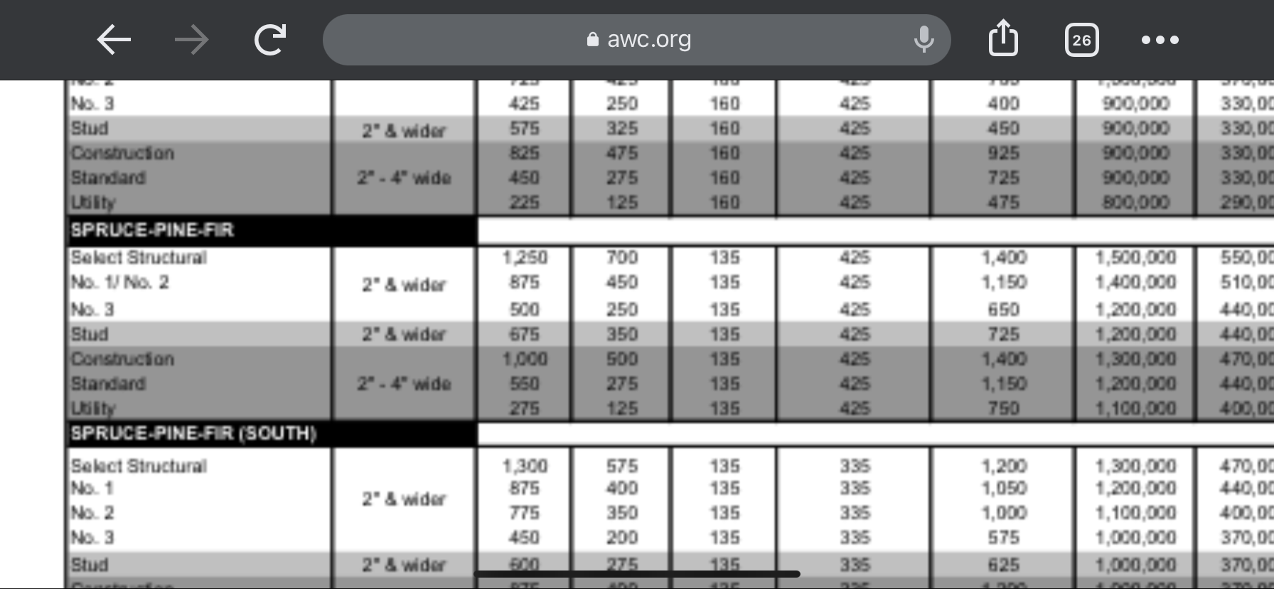

Where are you finding those Fb values? My NDS supplement gives spf #1/2 as 875psi and syp #2 as 1000psi (both for 6” wide lumber). E values are the same as you note.
I’ve used that calculator as well, and it does support use of SPF for both my girt and purlin spans … but I’m just trying to get my head around why we are seeing different design limits.

Not sure. Lumber grading has changed quite a bit over the years.
I never give much though to the Fb or E values. I just input my information.....and it tells how far it can span. If I want to span farther, I try other options....like closer spacing or upsizing the boards.

Back to the original topic, based on earlier advice I’ve managed to source SYP from Menards in Tridelphia. Sincr I’ve already posed question of SPF go by building designer, I’ll wait for that answer. If possible I always prefer to buy local, and SPF is a lot lighter and easier to work with.
BTW LD12, I figured out why we were misaligned with our figures. The AWC span calculator shows adjusted Fb values, which take into account factors like size, spacing, and use cases to modify the base numbers that are in the tables. So based on that, you’re totally correct that for certain size (particularly 2x6 and 2x8), SPF does have a higher bending strength for grade #2.
