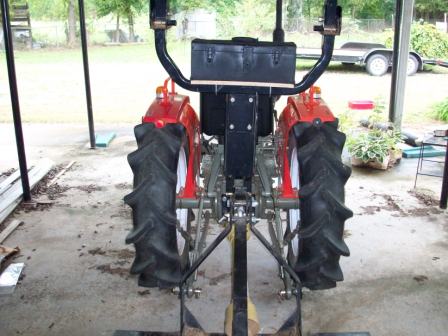

i have a VN ROPS and there more of a flat spot that on Scotty tractor. I took and old metal toolbox and mounted it on top of 3/4" plywood I put under the tool box for stability and put a piece of plywood inside the tool box so the bolts would not rip through and u bolted it all to the ROPS. Its right behind the seat. I keep a few wrenches, sockets, huge cresent wrench (for lift pins etc), bungee coard and extra pins. I also have the small maybe 1.5" tall toolbox on the bell housing. Which is good for pins and maybe the most common wrenches for the tractor like 10,12,14,15,17,19mm but not much more.
   / Where to mount a tool box? #12
Here is a pic, I had to look back through my previously posted pics

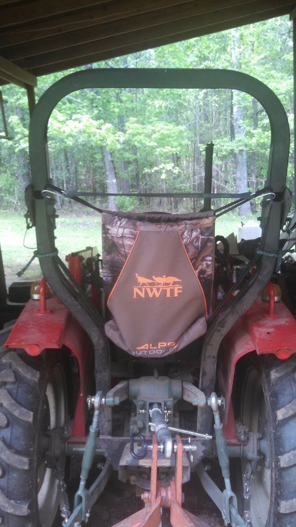

Thanks for all the replies, and especially the pics. I'm more convinced now that the best place is to tie into the back of the ROPS system in some way. I had a backpack type bag that a NWTF guy had given me, and decided it was just the right size for a hanging tool bag. I had in mind it being temporary when I attached it, but it works so well that I may just leave it on there. It has plenty of room in main compartment for all the tools I need, and also has a couple of side compartments. I keep the little metric wrench for tightening the nuts on the 3 pt hitch chains in one of them and its real handy. Here is what it looks like:

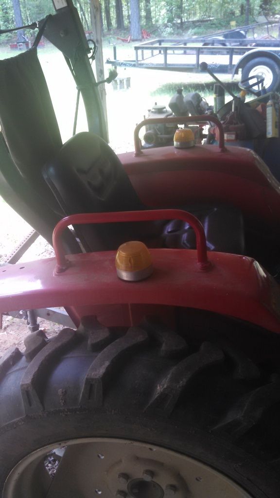

I think that's the best location for a rigid tool box if I decide to install one. I was thinking of putting one on this side before asking you guys:
I would have to remove the light and the grab handle to put it there, and a tool box is really more convenient in the rear anyway. I don't really need the light, but I do grab that handle often, especially when getting on the tractor. Glad to hear that others got some ideas from this thread.

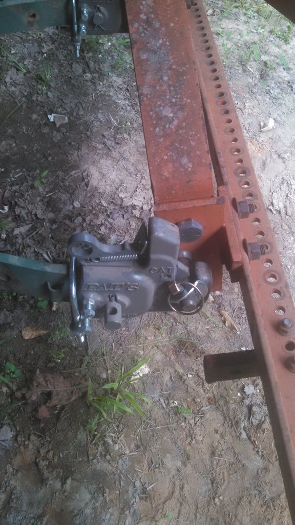

Another thing I added to the tractor that made life much easier was a Pat's Quick Hitch system. I tried to get by without it, but its so hard for me to line it up by myself. I have back problems, and trying to turn around and line it up just right every time I changed equipment was a big hassle. I had used a Pat's system on my JD5075 before, and didn't really like it because I have some type 2 equipment and some type 1. I finally bought a telescoping link system for it, but the Pat's works fine on the Yanmar since all the equipment is type 1. It made almost everything work better since it shifted the equipment 4" back. I was having trouble using my cutter and the disc without it, but the Pat's device solved those problems in addition to making it so much easier to change equipment by myself. Here is what it looks like if you have not seen one:

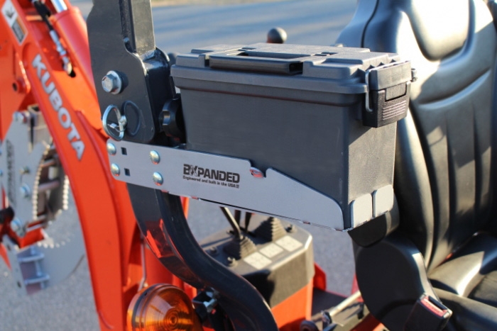

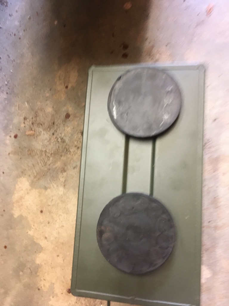

Rather than trying to build one, here is one we make that comes with all the hardware and mounts on the ROPS. Many people purchase the extra ammo can so boxes can be swapped according to the task at hand. Takes about 5 minutes to install the bracket and can be placed in almost any direction on the ROPS. Here is a link: BXpanded Tool Box
