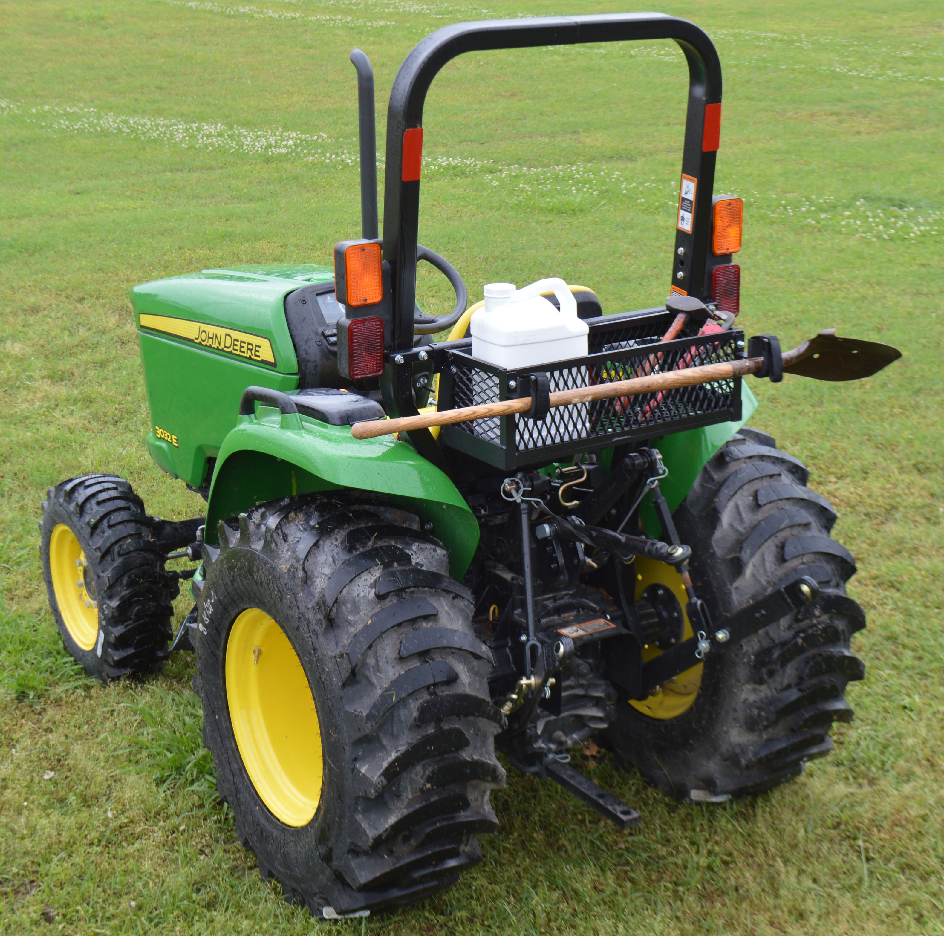

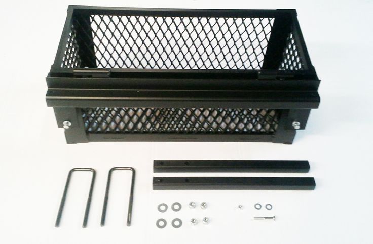

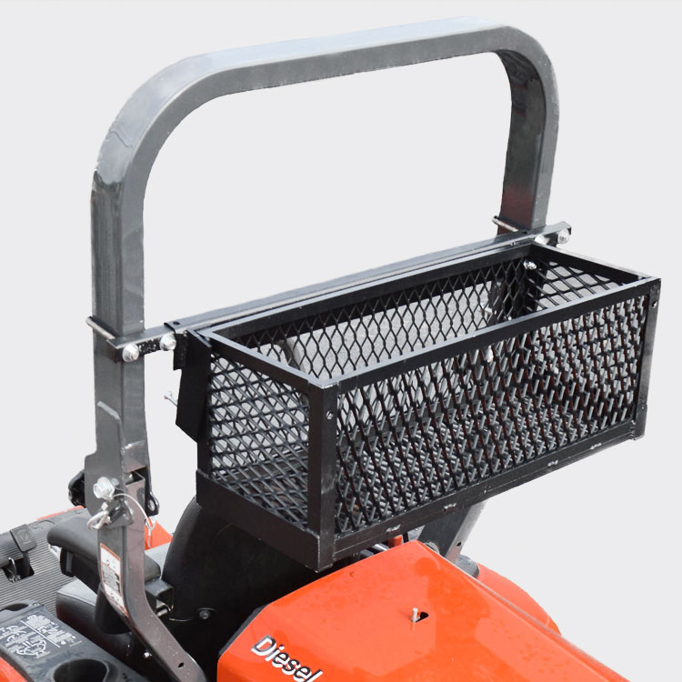

One caution about applying heat (welding) to your ROPS, this is intended to be a personal safety device. By applying heat to any metal, you are likely to change the strength and brittle factors of the metal.
In real life terms by welding on the ROPS, you may be causing a break point on the ROPS. Instead of supporting the tractor weight in a rollover, it may snap near the weld point.
If you read about things to not do to ROPS, you find 2 big ones. 1) weld to it and 2) drill holes in it.

When I first read about the welding to the ROPS I thought the same as Coy and JT.
It will probably be fine, and you hope it's never tested. But me personally I just won't take that chance. That's why I connected mine with u bolts, that go AROUND the tube and not though it.
   / Where to mount a tool box? #35
I can totally agree with hope it is never tested. But how will you feel for the rest of your life if it is your child or grandchild that test it and it fails at the weld you made or hole you drilled?
Personally, it just is not worth the risk even for someone I never knew to test it!
