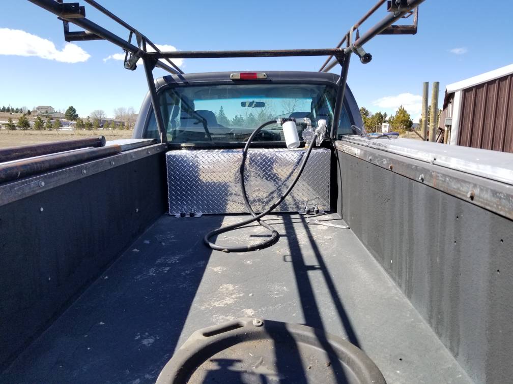

Recover partially tilted. Plenty of room under the deck for the spare.
Tank & pump before I removed then from the F250. 20191002_143926.jpg20200308_124653.jpg

Another vote for the trailer for the same reasons. Also, 36 gallons of diesel weights about 250# plus the weight of the tank, is that going to cause problems with tongue weight/balance with the trailer?
I don't think so. I have a weigh safe hitch with a scale built in. It's really handy for verifying your ballance & tongue weight. I glance at every time after I load to make sure I'm at 1,500-2,000lbs of tongue weight or so. If not I adjust the load. I might have to park the tractor a hair further on the deck.
