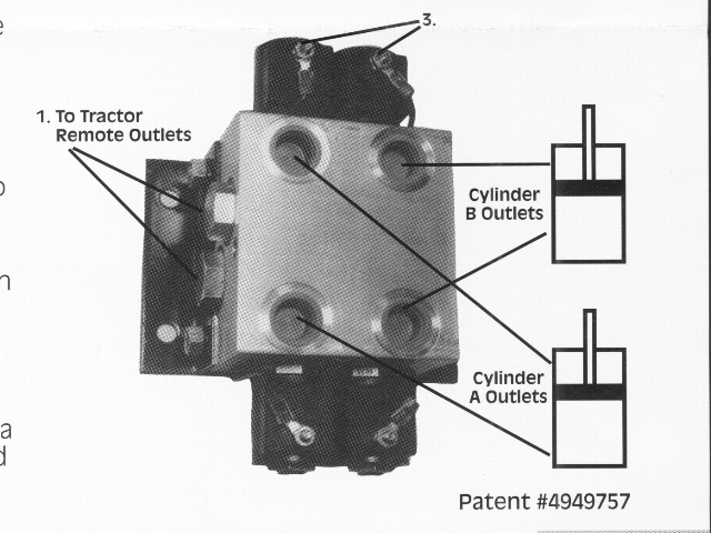

Here a picture of a V&M valve. This is for 2 cylinders, cylinder A (top), cylinder B (tilt). On the left side of the valve it says to tractor remotes. This could also be your loader joystick or you could plumb it from your power beyond port with a return line. If you were to mount it on the joystick you would only need to hook it up to one funtion dump/curl or up/down. I think the dump/curl option would be better. While you would be using the dump/curl for your top & tilt you could still move your loader up and down.
The valve I was looking at is a three outlet (attachment is a two outlet) measures approx. 8" wide, 6" tall, 4" thin. Your two outlet valve will be not as wide but the still 6" tall and 4" thin. V&M will put in an orifice to control the speed of the cylinders. I would look into that. My three outlet valve was quoted at $550. I would call them 1-605-332-4335 and ask for Mark. Explain your problem, he will give you suggestions, really nice guy to take to. Mention TBN to him.
I could not post the spec sheet, file to large. I made the file smaller and you couln't read it. I could e-mail it to you.

Glenn, the V&M is just a valve block that is electrically controlled. Mark C has the same setup on his tractor only the solenoid valves are separate and not in the same block. Are you with me so far?
Lets say you've got the switch in the off position, then flow is going to the hydraulic top link. Push down on your lock switch and push in button. This changes flow from the top link to the side link. In doing so it locks the toplink at that adjustment and then allows adjustment of the side link. Are you with me so far?
Now you push off the lock button and go to position two. This puts flow to the lets say rear blade angle cyl.. Works same as above.
With anystyle valve you can only do one cyl at a time. Unlike the loader control that allows you to do two at a time.
You must have at least one remote to start with to use this valve body. You could use the loader valve but, then the flow restrictors would really come into play to keep from having the jerky responses.
I just wanted to say I'm really thinking hard about getting the V&M valve body. Advantage all your stuff in a small package. Not a bunch of stuff hanging off the tractor, or a bunch of hoses running every which way. The down side if the switch or one of the solenoids goes bad. Usually only the coil all you have to do is drop another one in. Unless the valve itself is leaking by. So my only concern is the weather.
Think of it as your gear shift in your car. you can only be in one gear at a time but you have the option of three or four gears. OK?/w3tcompact/icons/smile.gif
Tried to keep it simple as possible
Gordon

Gordon, let's forget the set-up where we use the loader joystick. I understand you can operate only one cylinder at a time. Maybe my understanding of the terminology is fuzzy. I'm thinking of the valve as the "enlargeable/contractable" opening that controls the flow into the cylinder to make the piston move out or in. I'm thinking of the big handle as part of the valve--or the valve assembly--ie, the thing that opens and closes the valve to control the flow into the cylinder.
As to the V&M product, using my perhaps incorrect terminology, I thought you could electrically do two things. First, that you could choose which cylinder to operate (as you describe). Second, that you also could control the flow into the cylinder with an electrically operated rocker switch. In other words, there is no big handle opening the valve manually. Some sort of electric motor apparatus opens and closes the valve in response to the length of time you hold down the rocker switch.
Do I have this right? Partly right? Demoted to Kindergarden?
   / Where to Put Rear Hydraulics Levers #30
Your ready for high school. Yes your correct on the s/v directional it can be ran "hot" from the pump. Now all you have to figure out is where your going to get your supply and return from. Also be aware of your pump output if you have to much flow going through the valve it can overheat it. Something you have to consider when running the valve with a constant supply of fluid.
So it looks to me like your ready for your final exam Glenn./w3tcompact/icons/smile.gif
