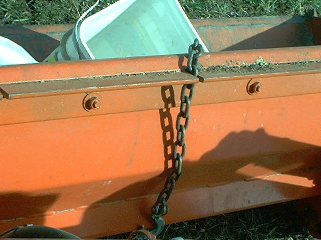

Ok here is a view from the front of the bucket. See pic above.

jdrotert, there was an attachment of a drawing. The following is what I was referring to...
<font color=blue>I'll take a pic tomorrow to show everyone what I am trying to convey. In the meantime, a quick drawing will have to do. </font color=blue>

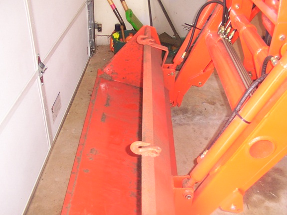

/ Where To Weld Hooks? #24
Gerard, Thanks. I saw what must have been yours some time ago and used your approach.............chim
/ Where To Weld Hooks? #25
Gerard,
It is absolutely yours! I even remember the picture. /w3tcompact/icons/smile.gif
The only potential negative I see with that method as opposed to weldable clevis hooks would be that it appears as though the hooks might be less likely to lose the chain if the bucket is tilted forward (dumped). Have you had any experience like that (or are you just better at not dumping your bucket by bumping the SCV than I am?).

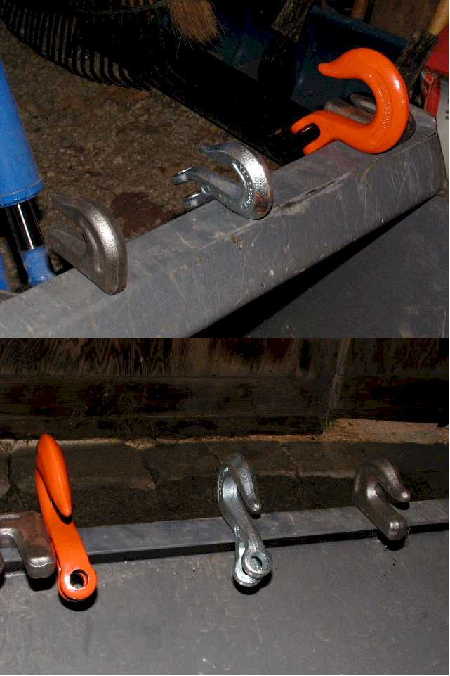

Mike,
Did you get your hooks welded on yesterday? How did they turn out? Any pics?
#29
Brad,
Yes, I got them welded on. (I'll post a picture tonight) They turned out well, 'cept the funky yellow paint the mechanic sprayed on the hooks and the area on the lip near the hooks /w3tcompact/icons/eyes.gif. I'll have to buy some gray paint next time I am at the hardware store. Although, I don't have to 'look' for the hooks, they stand out pretty well. Had I told them, they would have brought some steel to box in the lip. However, since they are probably going to have to come out to replace the bent MMM mounting rods (see <A target="_blank" HREF=http://www.tractorbynet.com/cgi-bin/compact/showflat.pl?Cat=&Board=nhown&Number=171815&page=0&view=collapsed&sb=5&o=0&fpart=>this</A> post), I will ask them to do this add'l welding then. As it was, the mechanic welded on the hooks, then used a nylon strap and the center slip hook to hold the deck up while he removed the blades and sharpened them. So, at least he trusts his welding capability that much. /w3tcompact/icons/laugh.gif

Attached are some pictures of the hooks.

/ Where To Weld Hooks? #31
Looks good. /w3tcompact/icons/smile.gif
Is there a reason he used yellow paint? /w3tcompact/icons/crazy.gif Was it all he had or does it have a purpose?
--Brad
#32
<font color=blue>Is there a reason he used yellow paint? Was it all he had or does it have a purpose?</font color=blue>
I think it's all he had. Although I'm not sure why he painted them at all. The one in the center was painted red/orange when I bought it and the grab hooks were unpainted.
#33
I found some spray enamel at True Value that is almost an exact match for the gray on the FEL bucket. So now everything looks 'Boomerish' until they box in the lip.
/ Where To Weld Hooks? #34
He may just have been trying to get some paint/primer over the fresh, uncovered weld right away. Better yellow paint than brown oxidation, right? /w3tcompact/icons/smile.gif

Nice looking job on the hooks. Guess they told you to be careful until they box in the lip. Did you ever get a chance to look at the pictures I posted on this thread? My bucket lip is pretty much the same as yours.
Gordon
#36
Thanks, Gordon. I did see your pictures. I have no plans for using the hooks before they get back to box the lip in. Boxing the lip in is such an obvious thing to do, I wonder why they don't do it by default.
