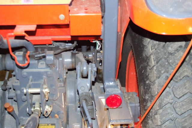

<font color="blue"> What I'm interested in finding is the one to the left of the differential when viewed from the rear as shown in the manual. Can't find it. Could only find 2 on the rear of the machine - 3ph lift arm linkage and right arm leveling crank.
</font>
Those are the only two I have found also.
<font color="blue">Sure enought, the clutch and brake zerks are a little tought to reach. </font>
The picture is of the grease fittings tied into the brake linkages. There is one on either side of the tractor. With the FEL mounting brackets there is only about an inch clearance for these two zerks. I think the grease fitting you referred to as the clutch fitting is actually the grease fitting for the brake linkage on the left side. I've found a right angle grease coupler gives easy access to these two grease fitting.
In the picture you'll see the grease fitting tucked in behind the FEL mounting bracket, just about centered in the picture. One grease fitting on the left, the other (not pictured) on the right side.
Don

Question #4.
Who can tell where this grease fitting is located?
Don
Incidentally...the owners manual calls for greasing every 50 hours.

Question #4.
Don
/ Where's this Grease Fitting? #51
Re: Where\'s this Grease Fitting?
I greased all that I could find on the tractor frame after just a few hours of use. I greased those on the loader and backhoe about every 10 hours or so. But, those on the tractor frame really didn't need much in the first 50 because about 30 or so of those hours were spent sitting still on the backhoe. Only a little steering, wheeling, or 3ph work going on in the break-in period.
That third zerk sure has me stumped - just worried I'm missing something here. I hope the manual is in error. Could it be unique to HST's????
Tom
Front right steering ram. Every 50 hours? Wow, I hit these ones every other day. I do a lot of steering and these joints are down low.

HB, Front right steering arm is correct.
Question #5
This should be an easy one to identify the location.
Don
