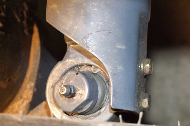

Please don't tell me that you waited 50 hours to grease your tractor for the first time.
I can't place that last zerc. I don't recognize it. I'm guessing it is up under the dash above the clutch pedal since you can see the smaller power steering hose.
I have gone through several tubes of grease in my 200 hours.

   / Where's this Grease Fitting?
#43
Re: Where\'s this Grease Fitting?
<font color="blue">That looks like it's on the front end steering.</font>
This is not correct
<font color="blue"> What I'm interested in finding is the one to the left of the differential when viewed from the rear as shown in the manual. Can't find it. Could only find 2 on the rear of the machine - 3ph lift arm linkage and right arm leveling crank.
</font>
Those are the only two I have found also.
<font color="blue">Sure enought, the clutch and brake zerks are a little tought to reach. </font>
The picture is of the grease fittings tied into the brake linkages. There is one on either side of the tractor. With the FEL mounting brackets there is only about an inch clearance for these two zerks. I think the grease fitting you referred to as the clutch fitting is actually the grease fitting for the brake linkage on the left side. I've found a right angle grease coupler gives easy access to these two grease fitting.
In the picture you'll see the grease fitting tucked in behind the FEL mounting bracket, just about centered in the picture. One grease fitting on the left, the other (not pictured) on the right side.
Don

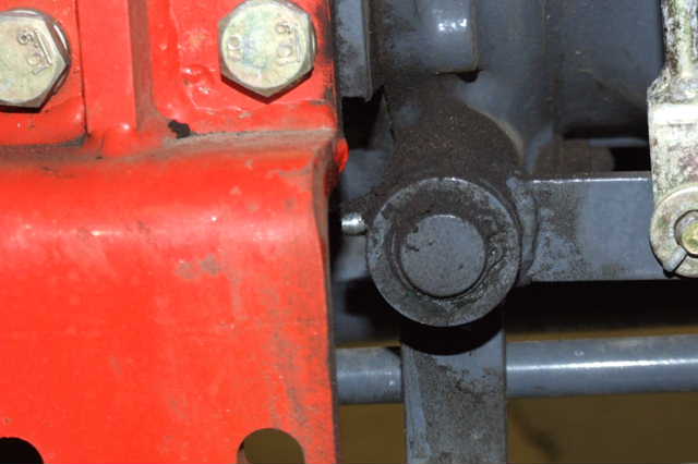

#49
Question #4.
Who can tell where this grease fitting is located?
Don
Incidentally...the owners manual calls for greasing every 50 hours.
