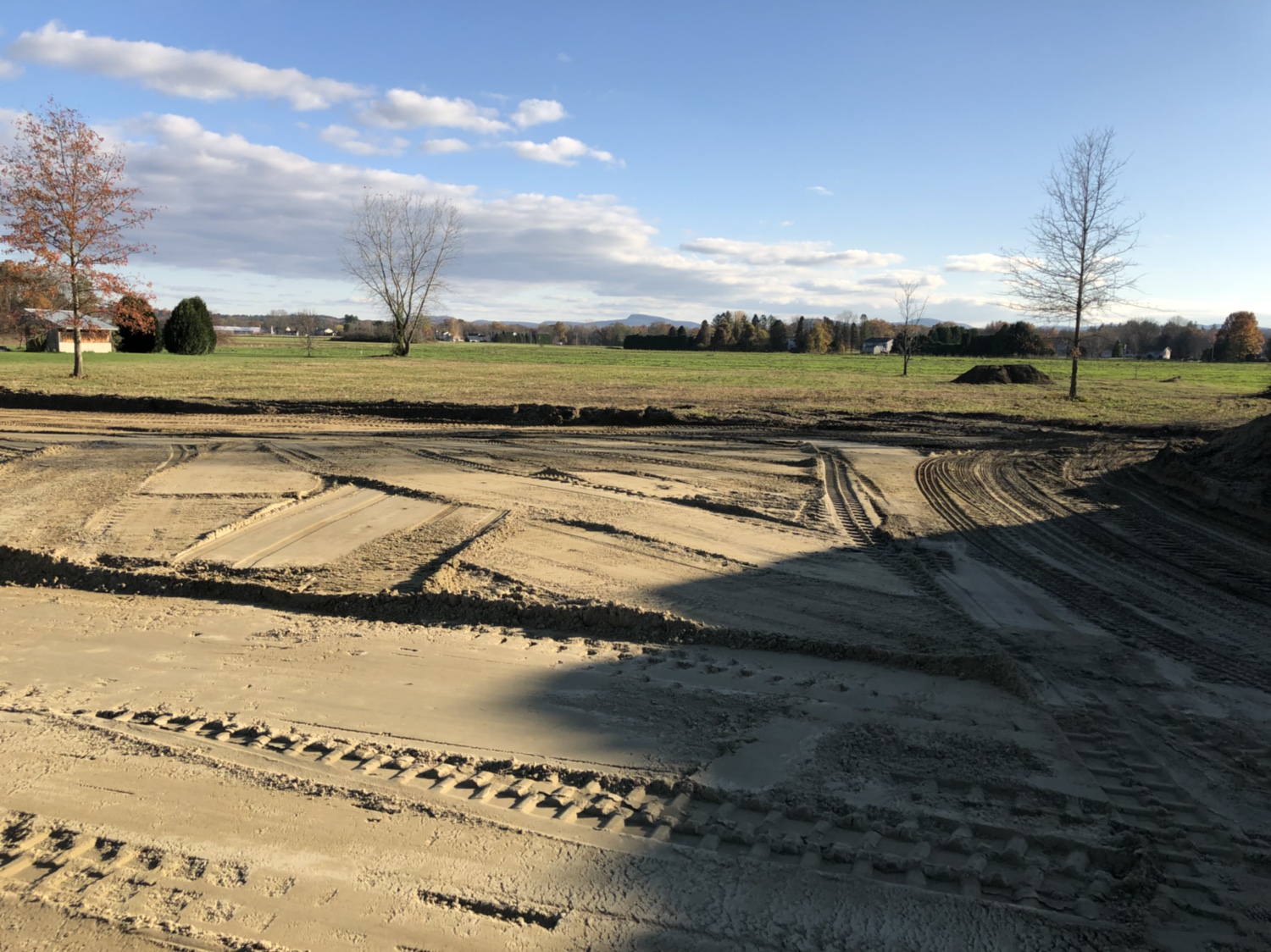

I have a Kioti CK3510SE with loader and am looking to turn some land into nice lawn. The two acres or so directly behind our house currently under construction was wooded until last winter the rest is all open farmland as you can see from the pic. We clear cut it and had a contractor come in a pull the stumps and rough grade with a bulldozer. We’ve been mowing the area all this year (basically mowing weeds).
What I am looking to do is turn the area into a nice lawn. To do this the soil definitely needs to be turned I think as well as deal with some minor roots that may be in the ground still and level out the area as much as possible. No issue there with rocks just nice loam a little on the sandy side. I am leaning toward a Harley Rake based on what I have been reading although a buddy says just buy a tiller and till it up that way. So what is the best attachment to do this? Biggest bang for the buck? Is there one attachment this will do the whole job?

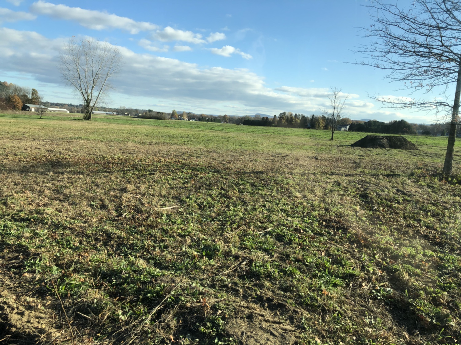

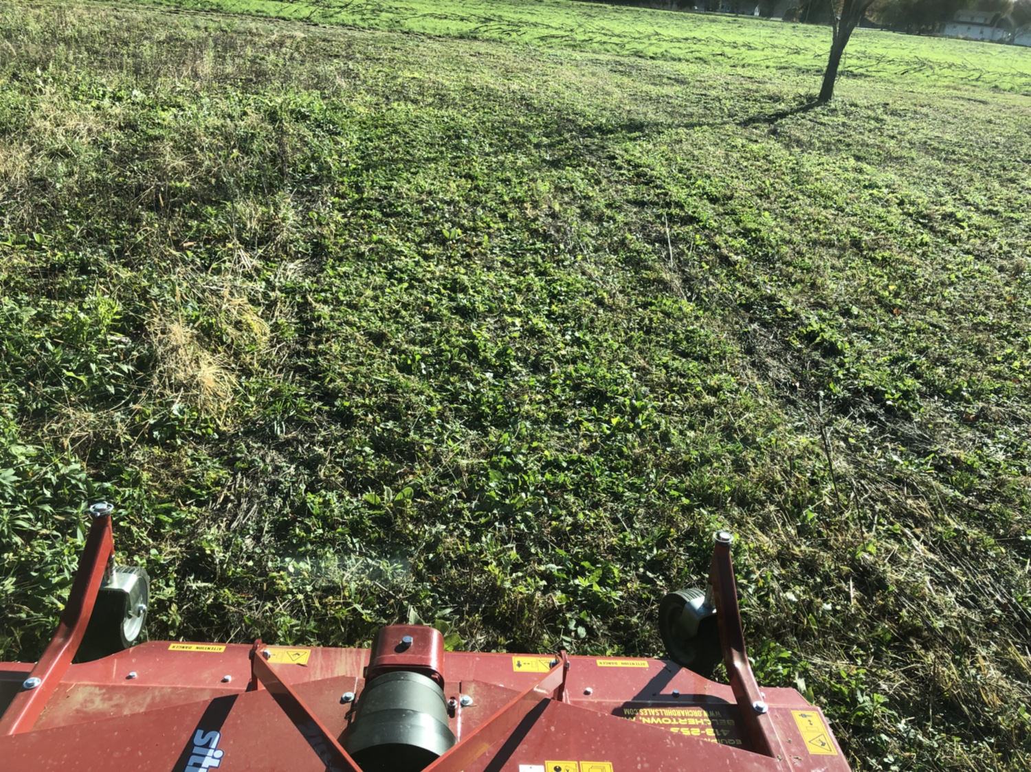

The two acres behind our house was wooded until last winter. We clear cut it, then had a contractor pull the stumps and rough grade with a bulldozer. The rest is open farmland. We mowed the area this year, basically mowing weeds.
I want to convert the area into a nice lawn. To do this the soil definitely needs to be turned I think as well as deal with some minor roots that may be in the ground still and level out the area as much as possible.

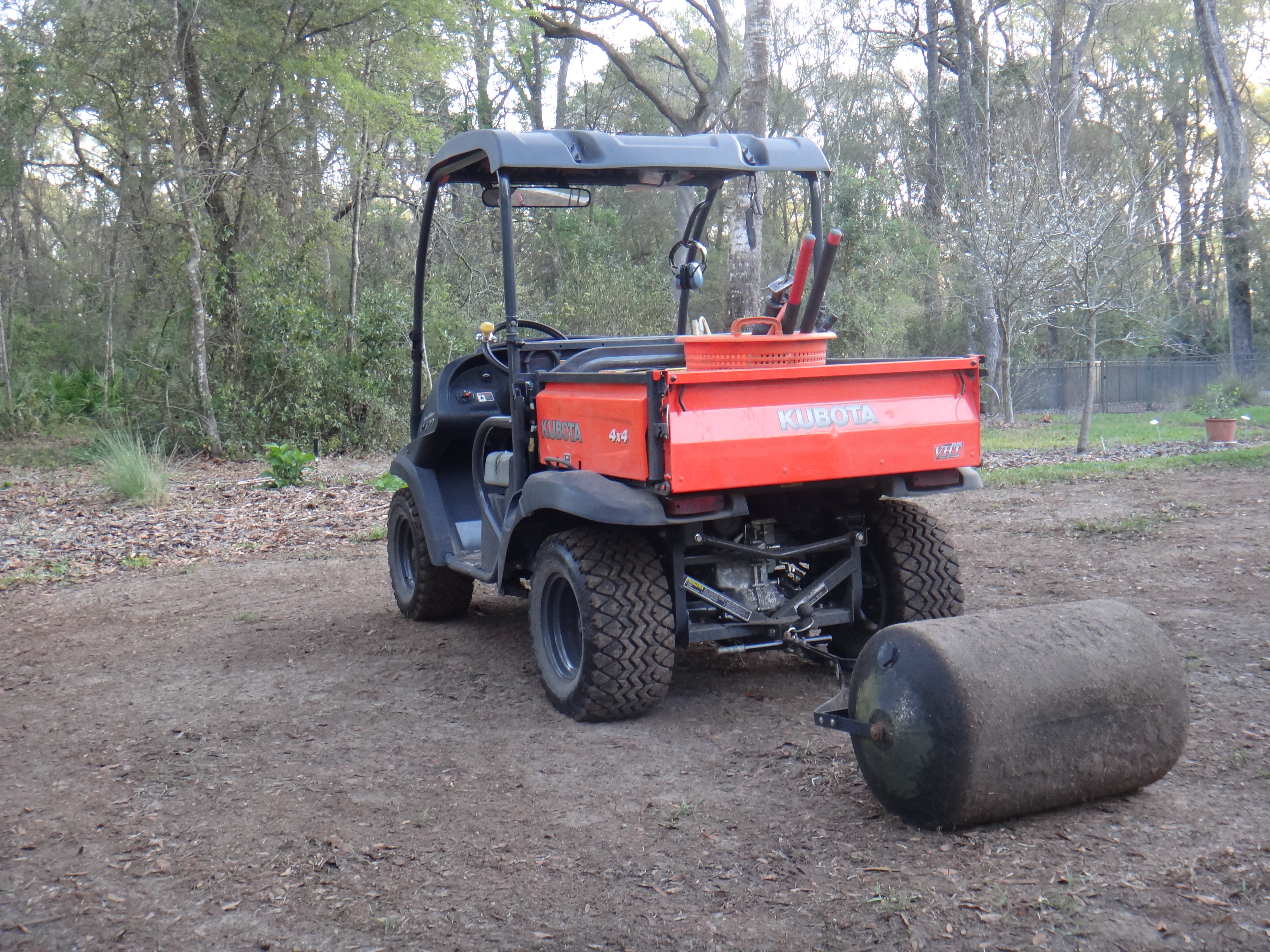

If you plan to seed the land, you will need some type of roller to press the seed into solid contact with the earth. Poly rollers are cheap and readily available from TSC and Big Box store web sites.

I guess I probably don’t need to turn the soil based on what everyone is saying. I was just trying to find the best way to get all the inevitable clumps from the weeds mixed in and broken up.
I don’t plan on adding anything to the soil other than lime as the composition is decent. I did find a good deal on 200 yards of good loam and local contractor was trying to get rid of at $8 a yard I couldn’t pass it up so if needed I can spread that with the loader in areas that might be a bit too sandy or need to be raised up a little.

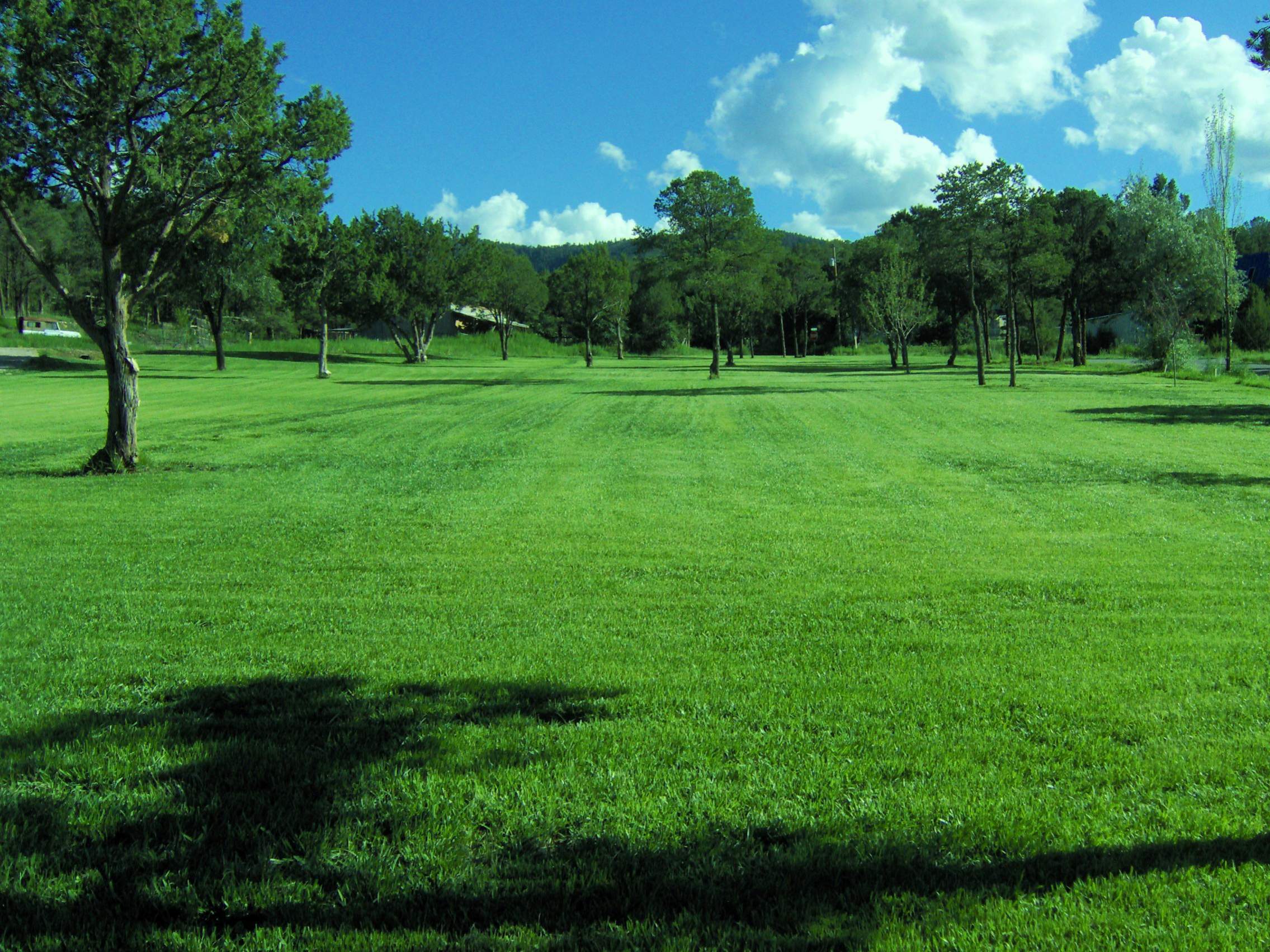

I do a lot of this work and have included a few pictures.
First is using a tiller in a weed filled pasture, first pass at 2.5mph
Second picture is using a land plane grader scraper to smooth a field
Third is a picture of the same field after two months seeded in Tall Fescue
Forth is a picture of my rear lawn

Wow pretty awesome results. Sounds like a good plan if attack I did find a Harley Rake I can rent In the area. No tillers I have found for rent but may be able to borrow one from another farmer and then there is also a landscape rake as well.
