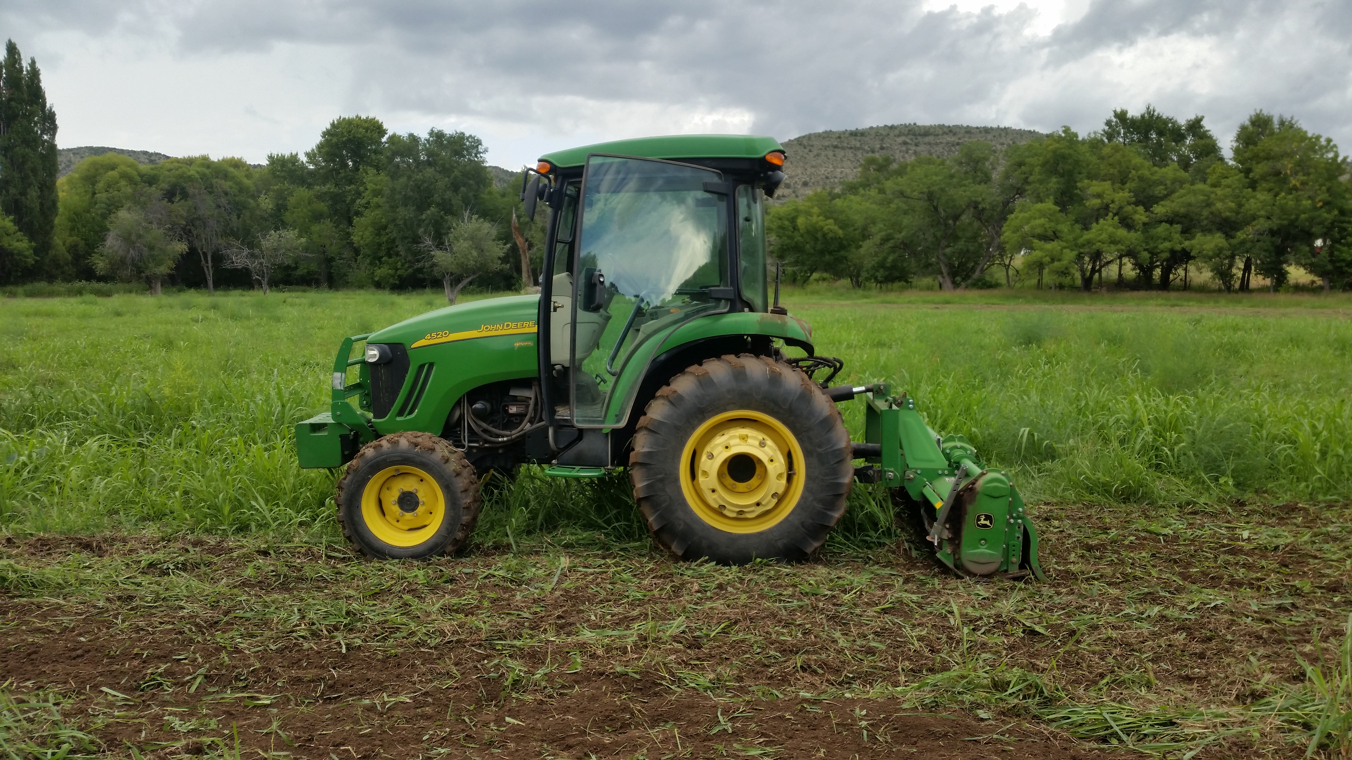

I would check out what is available for rental in your locale and who is available for hire before purchasing equipment. My reasoning is that tilling this with a rototiller in two directions is about a two hour job with my set up. I would not recommend buying a tiller for two hours of work. Same thing for a Harley rake too, not enough use to bother with a purchase.

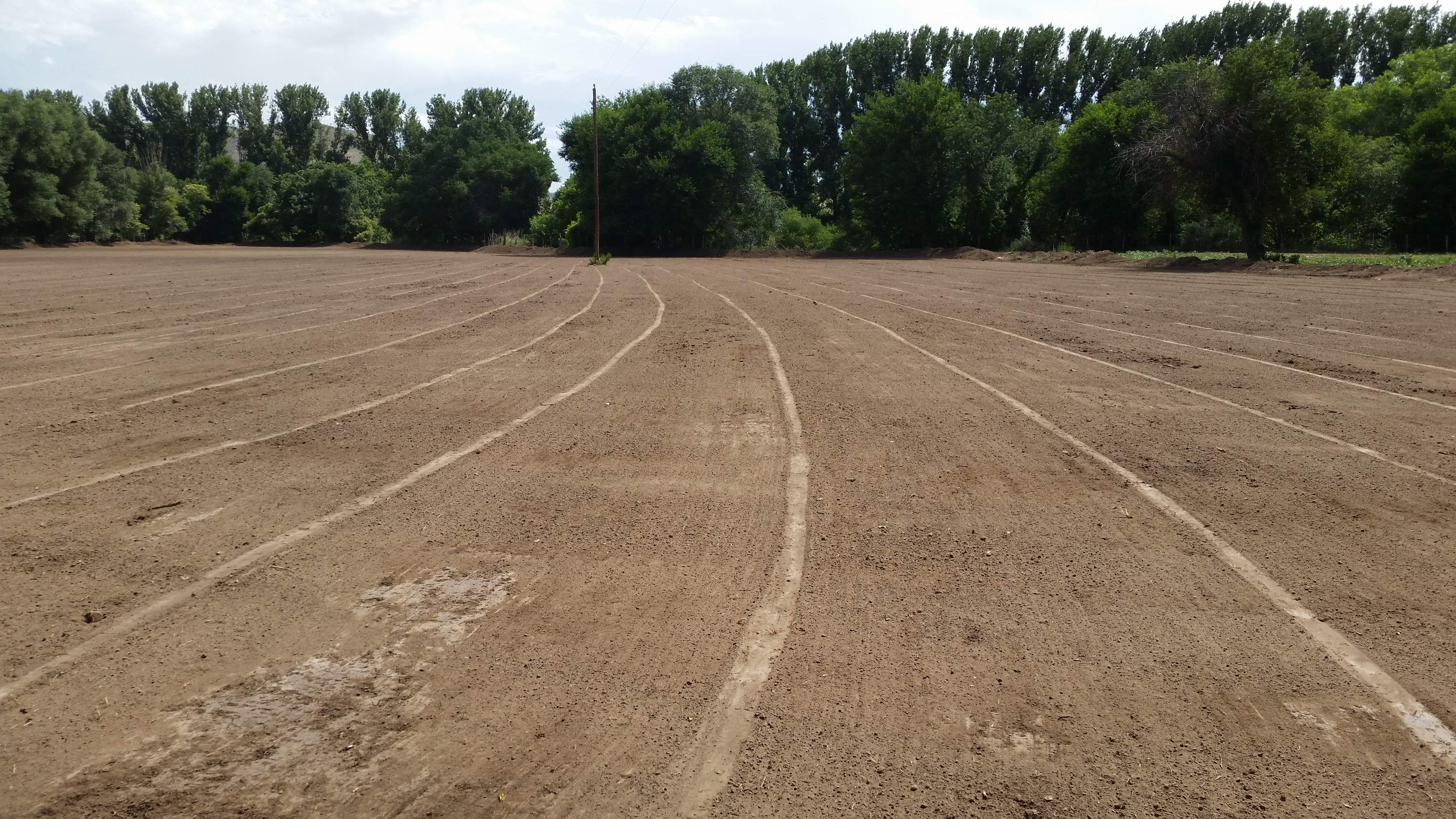

Smoothing for a lawn area can be accomplished in short order too. I prefer a land plane grader blade (wider the better) followed by a section harrow or drag harrow for rougher surfaces. For relatively smooth ground the section harrow or chain/drag harrow will suffice.

First is using a tiller in a weed filled pasture, first pass at 2.5mph
Second picture is using a land plane grader scraper to smooth a field

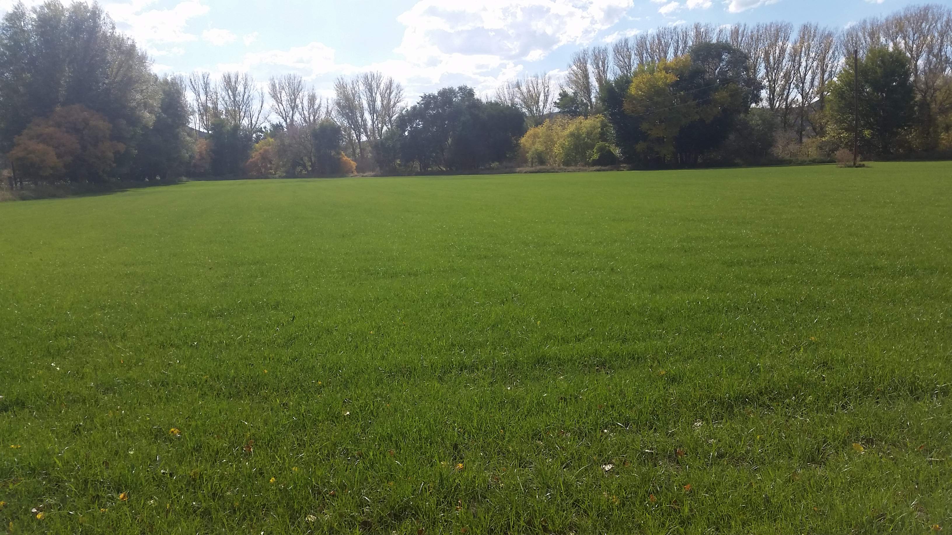

Third is a picture of the same field after two months seeded in Tall Fescue
