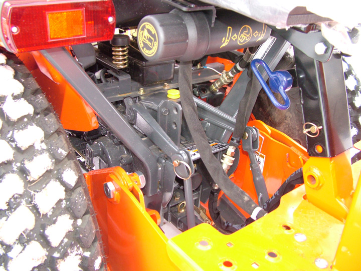

bialecki said:
The heavy mainframe is bolted to the tractor all the way up to the FEL's mainframe. The torque to mount the bolts is high, however occasionally it probably is wise to check the torque, but no different than checking the FEL's mainframe's securement.
I'm with you on this one. I check, from time to time, the torque of the loader and bakchoe mainframe bolts and it happens that a bolt needs to be retightened. It's normal but it could dangerous if the owner don't check that kind of stuff once in a while. It's part of the "have fun and be safe!" using your tractor. :)
/ Which backhoe for B3030? #24
Yeah, getting people to check bolt tightness is hard. I have lost count of
the times I have seen loose bolts on tractors owned by people I help.
My experience is that new equipment, including newly mounted FELs or
hoe subframes need bolt tightening, almost for a certainty.
That said, I am happy to see that Woods has made the trade-off between
fast removal of pinned subframes and tighter mounting of bolted subframes
in their newer 4-pt subframes. They even provide the wrench for the
1" bolts, with a wrench holder pocket. Their earlier pinned-on subframes
had some wiggle to them.

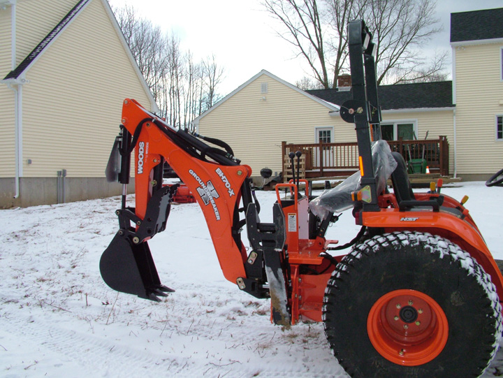

/ Which backhoe for B3030? #25
Attached you can see the Woods BH subframe and how it connects up with the FEL frame and the tractor subframe. The beauty of the design is that I can have the FEL attached, the BH attached and the MMM attached. I can see it now, cutting the lawn with all the attachments on and having the neighbors think I lost my rocker, Heck if the dandelions crop up I can dig them up while mowing with the BH. :D

/ Which backhoe for B3030? #30
Hey Bialecki, what is that grey member just below the arrowheads
in your photo? A MMM mount? A custom-built skid plate perhaps?
/ Which backhoe for B3030? #31
The subframe for my Kubota front snow plow blade, This is Kubotas frame for their front blade, sweeper and front mounted snow thrower. I need to remove this to mount the MMM each Spring, say mid July for us in the North east.
