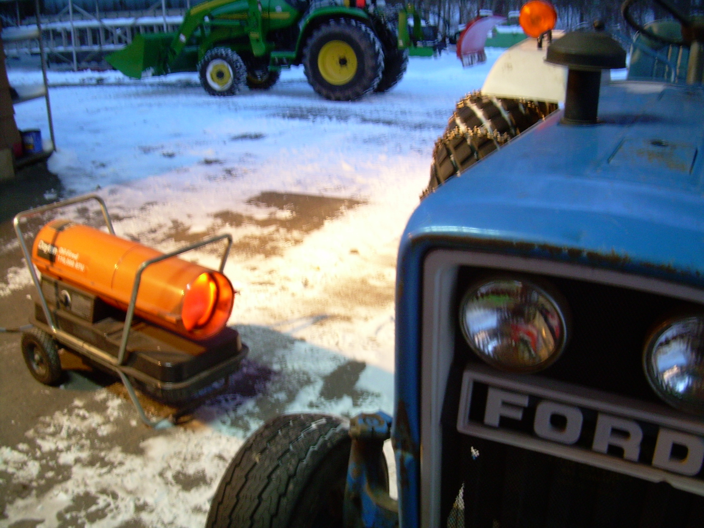

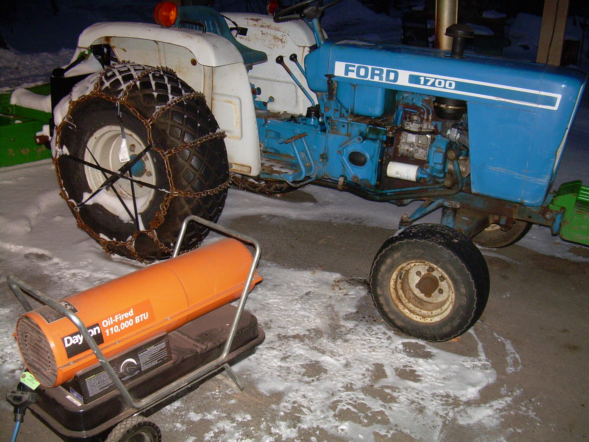

Don't forget that for an even quicker start with a marginal heater you can throw an old blanket or sleeping bag over the hood. (Never hurts to warm the fuel tank and system as well)

I intentionally left the block heater unplugged so I could try this method, after about twenty minutes it fired up nicely, everything was warm, battery, fuel, pump, block, radiator.
This was outside in about 15 degrees, sure it would work better in a shed.
