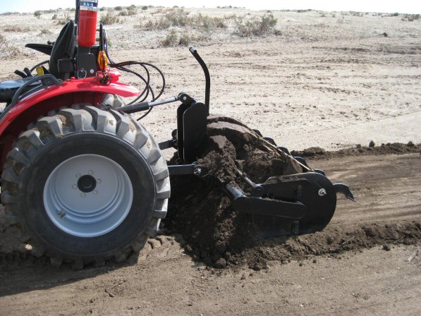

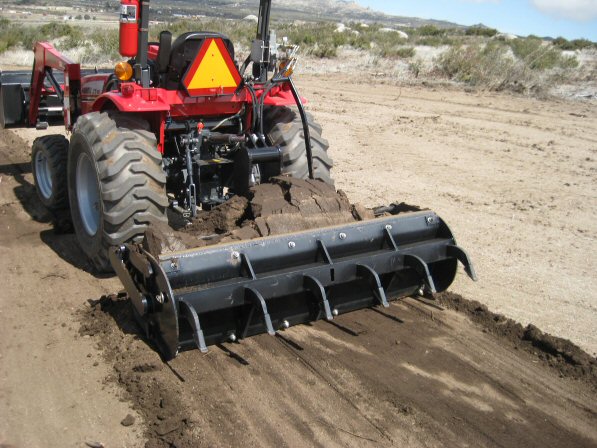

For the OP, a ROBB is ideal for your size of tractor. ;)
Just my :2cents:
Forgot to add that a 60"-66" unit would be the best fit IMO. ;)

Bush Hog and Dirt Dog are the same unit and Eagleline builds a little heavier unit. Those are your choices for new units. Because of the design of the ROBB, there is NO rear mould board to even worry about. I can't help you out on costs. I don't know, I am sure that they are more $$$ than any of the std type box blades. But then it is safe to say IMO anyway that when it comes to NEW implements, you usually get what you pay for.
Good luck with your decision. ;)
