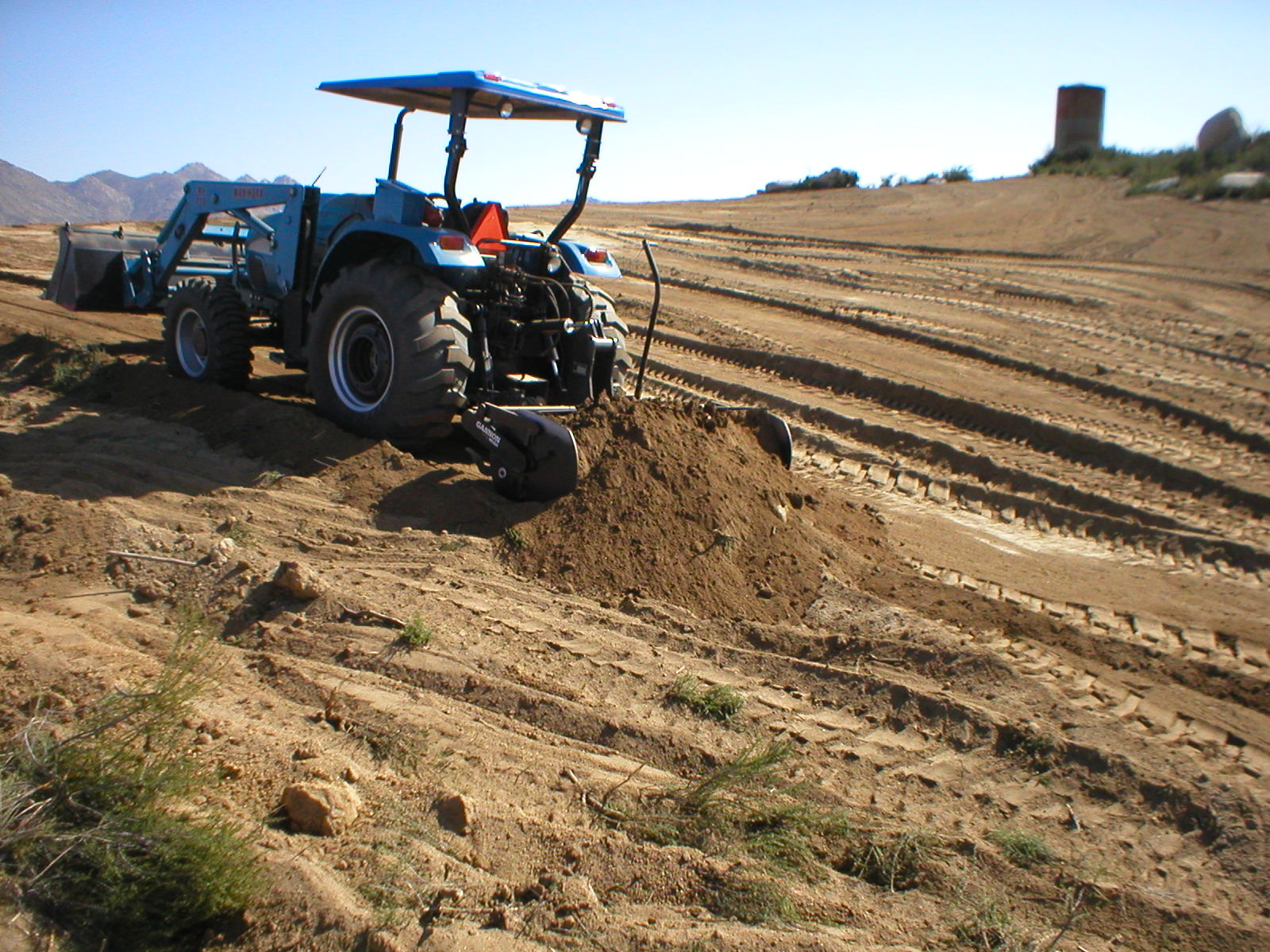

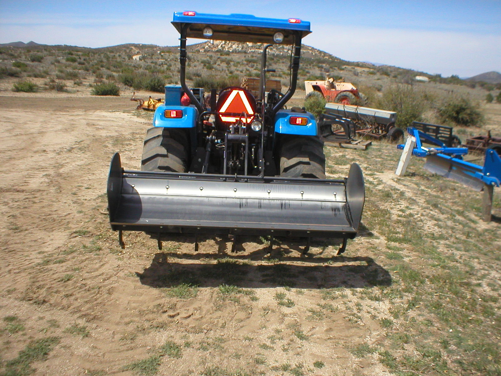

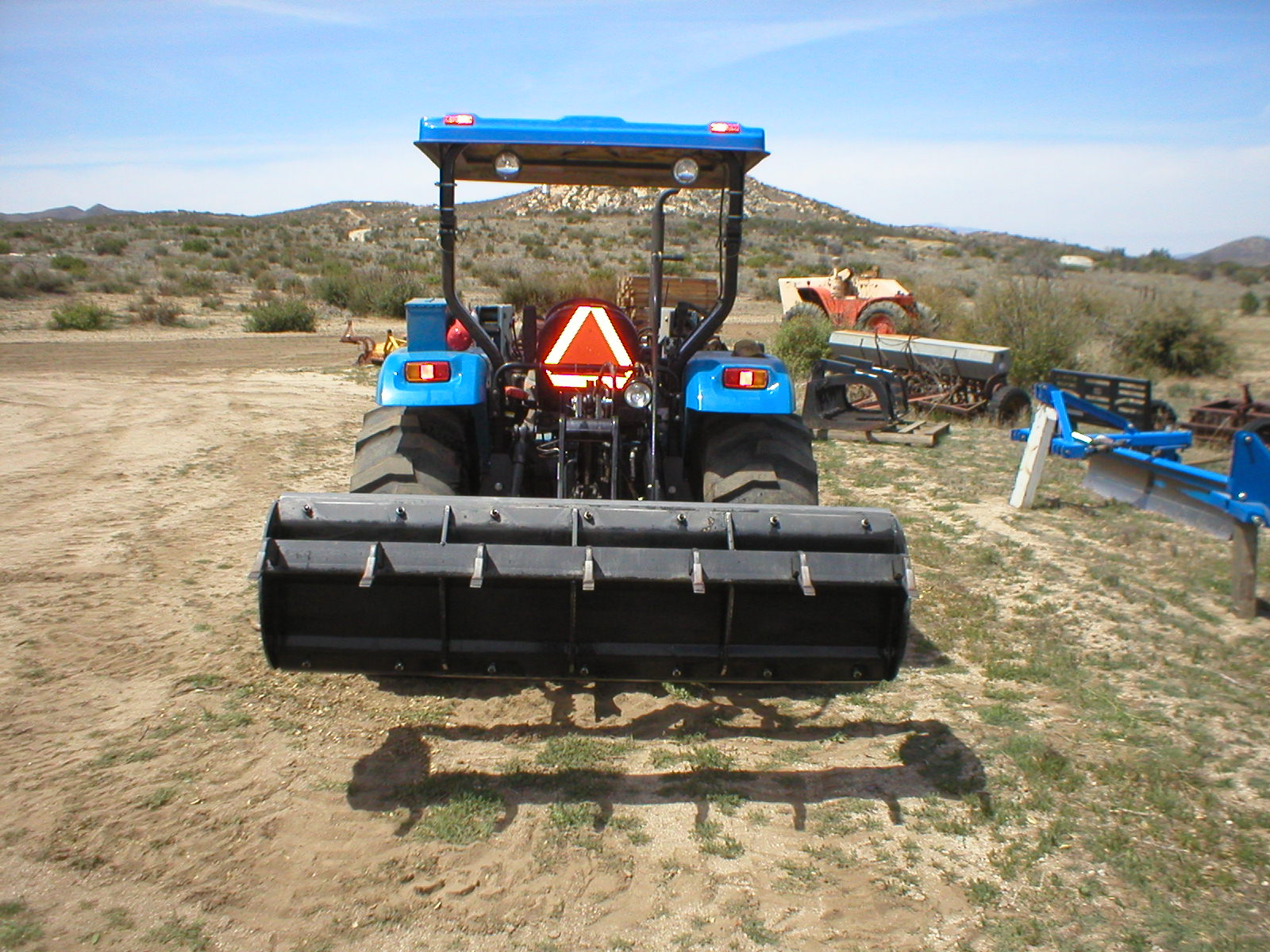

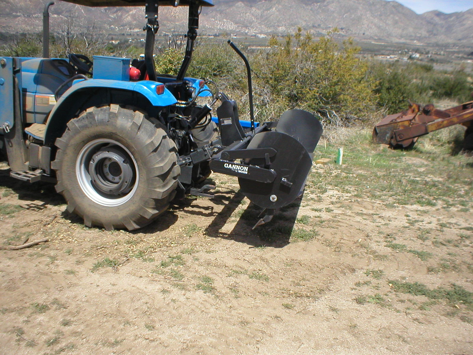

In the pictures with the red tractor, that ROBB is a Gannon, weighs 780lbs and is 65" wide. The red tractor is a 32hp HST that weighs 5000lbs ballasted. I have an 81" Gannon ROBB for my 75hp, 12,000lb tractor also. (shown below) I also have a 36" Gannon ROBB for my garden tractor. (no pictures:eek:) I have had excellent luck with these types of boxes. Mine are all Gannon's, which I have had very good luck with.
These other ROBBs are not Gannon's and are not as heavily built, but my understanding is that they are still VERY GOOD.
I honestly don't know if you should get a 60" or 65" unit. Probably either one would be fine for you. As far as the cost vs convenience, that is your call. :confused3: All I can tell you is that I would not own a box blade that I had to lower each ripper individually each and every time other than for display purposes. But then I do a lot of dirt work and that would get old real fast. This may not apply to you and you would be fine with a std type of unit. They just aren't for me. ;)
