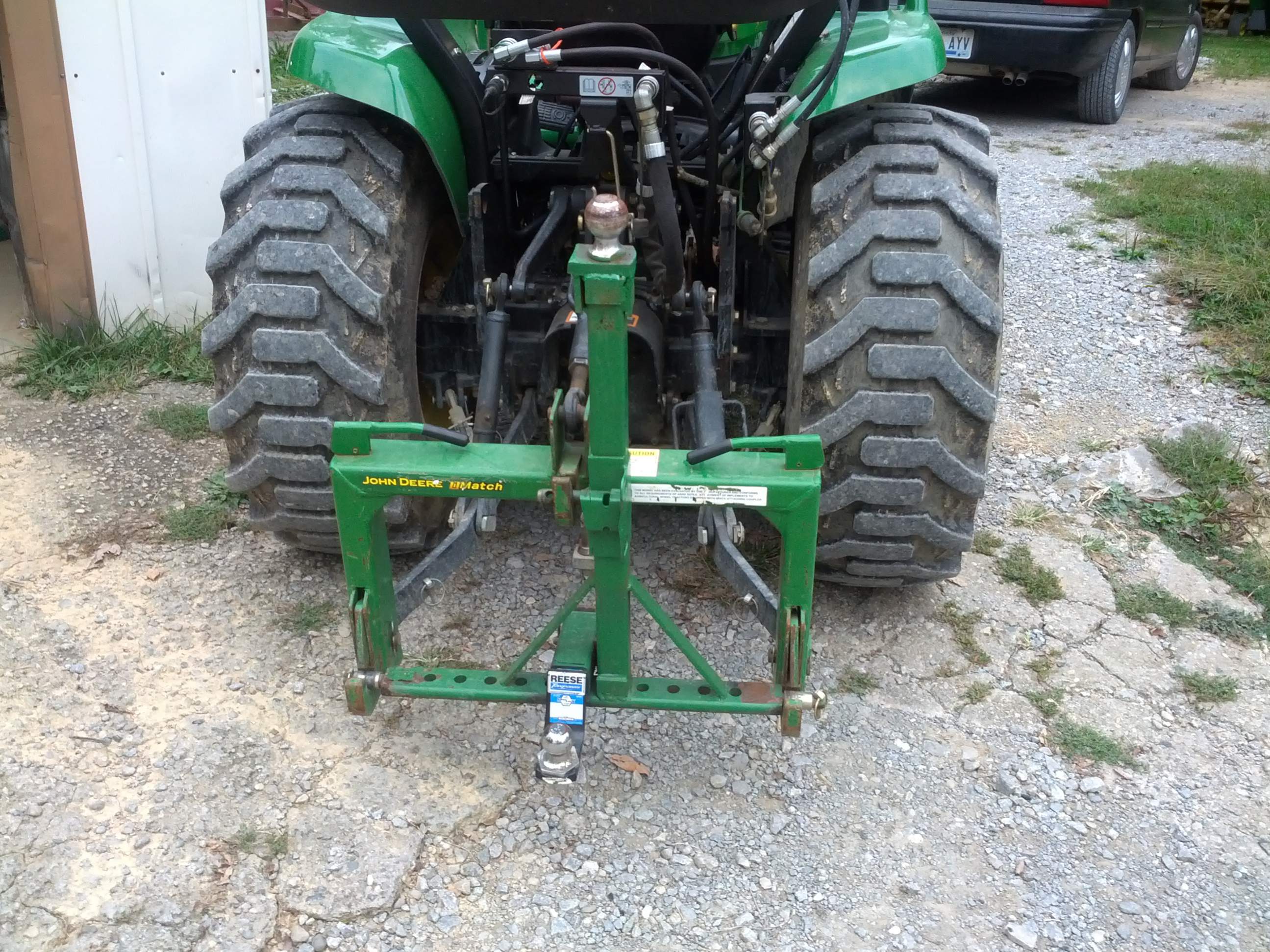

if you had a dolly made, or found one, you could always have it made so it mounts
on your lower 2 links, like a semi mount rotary mower. then you don't end up with
an extra pivot point.
tie that in with a quick hitch and it'd be a sweet setup!

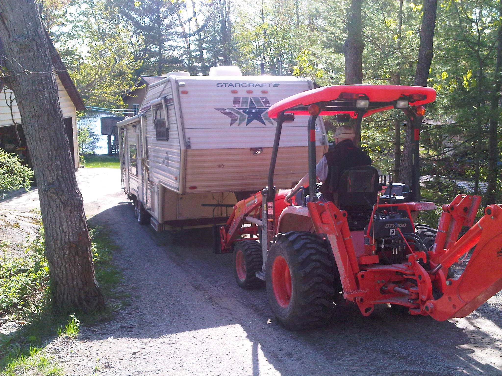

I welded a channel across the top of my forks with a big hole drilled in for the pin and used it on the fel.

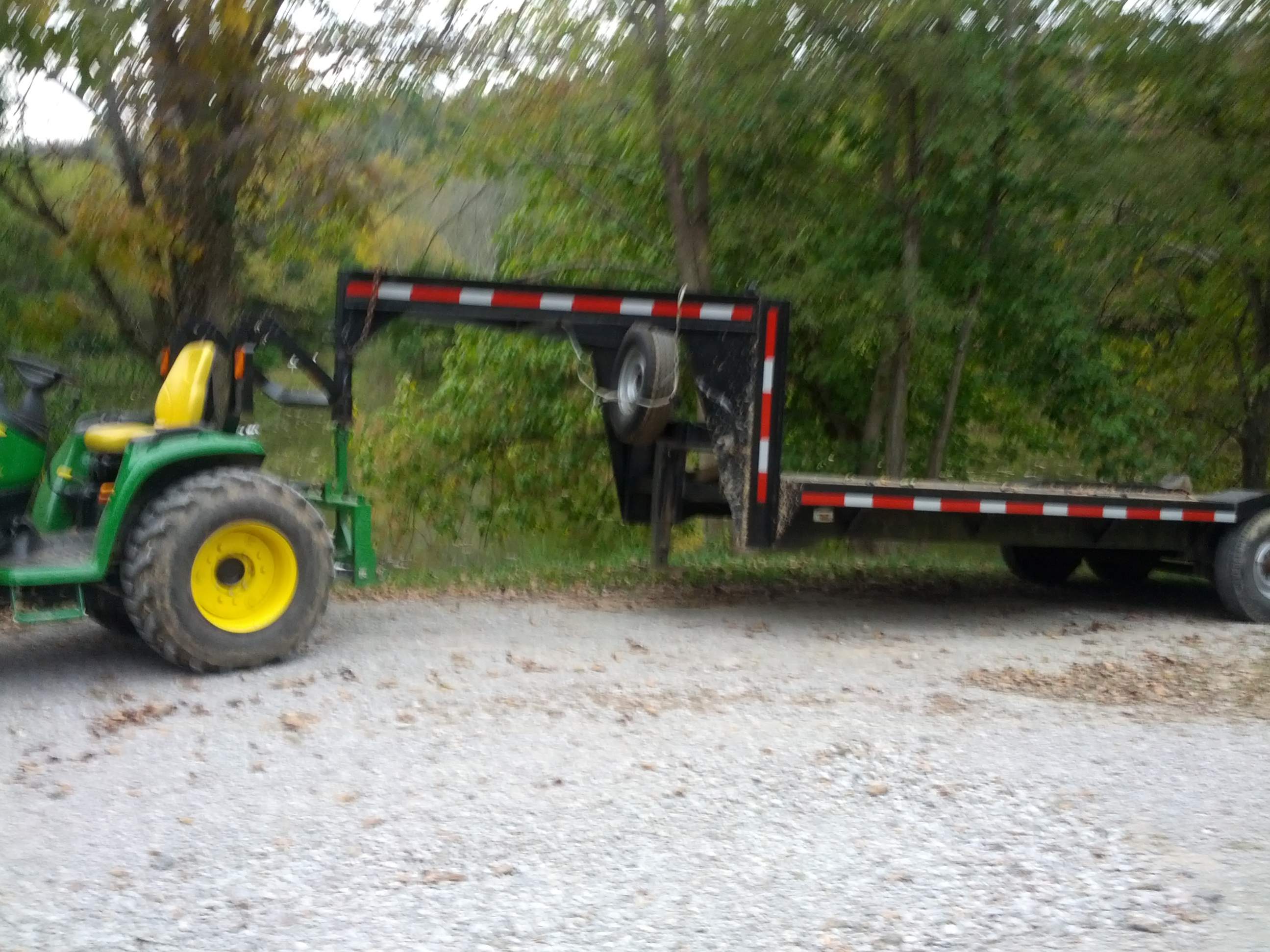

Here's how I move my gooseneck loaded or unloaded. nexuspics 045.jpgnexuspics 046.jpg

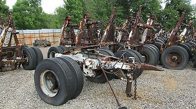

I can get a 5th wheel converter used. They're reasonable. You guys think that will back ok?
   / Which compact tractor will move 5th wheel campers? #18
something along these lines might work for you. have a fabrication shop make it up for you.
I move my 30 foot gooseneck with my front loader...but i have to use a good counterweight.
That looks like fun backing up. Almost as many pivots as backing a hay wagon behind a baler.

if you go with a dolly (which would be what i did first) do yourself a favor and build a hitch for your front end loader, really easy to back it that way.
