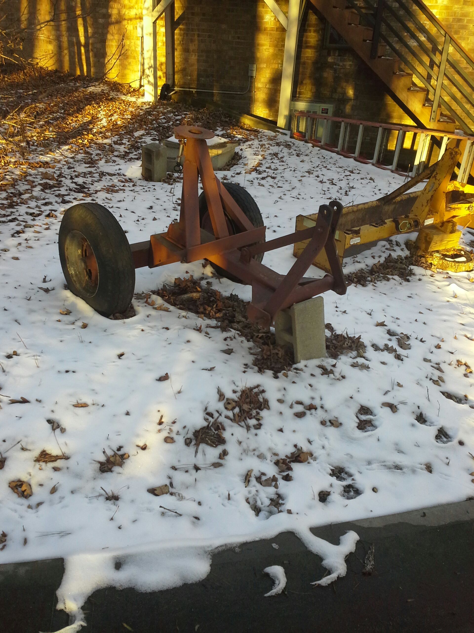

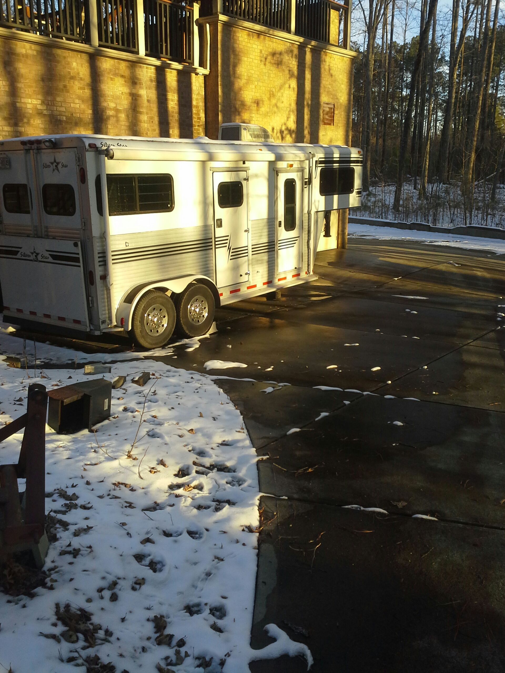

I made a dolly and it is OK. By far not as good as tractor that can handle the weight, But I am trying to move a 40 foot 5th wheel that weighs 17,200 loaded with golf cart and 2 weeks of supplies. My 45 will move the pictured Horse Trailer with ease. 5th wheel dolly.jpgHorse Trailer.jpg

That's what I was considering. A dolly like that, or a larger tractor. Can you back that trailer precisely enough where you would be comfortable going through a door into a building?

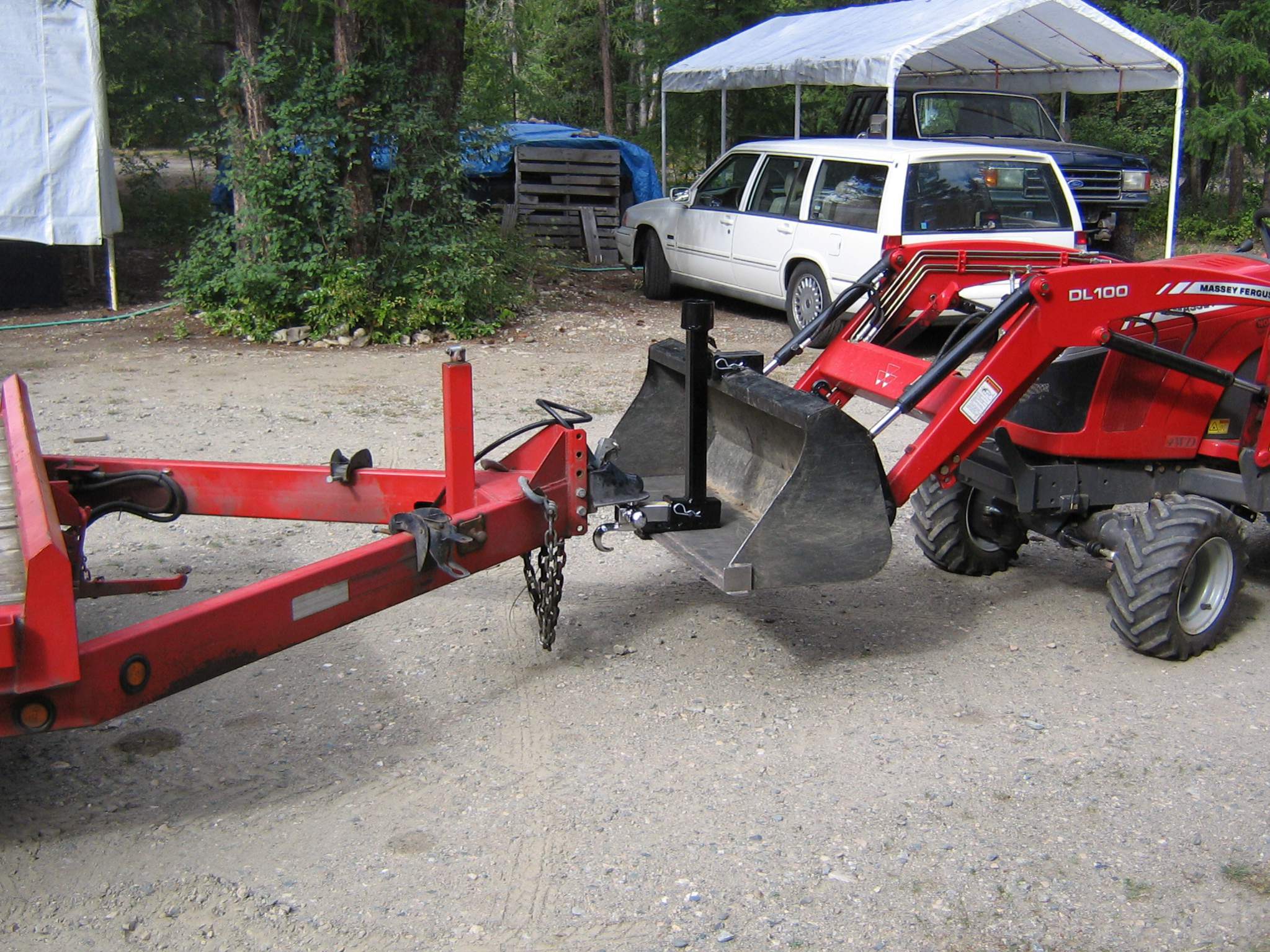

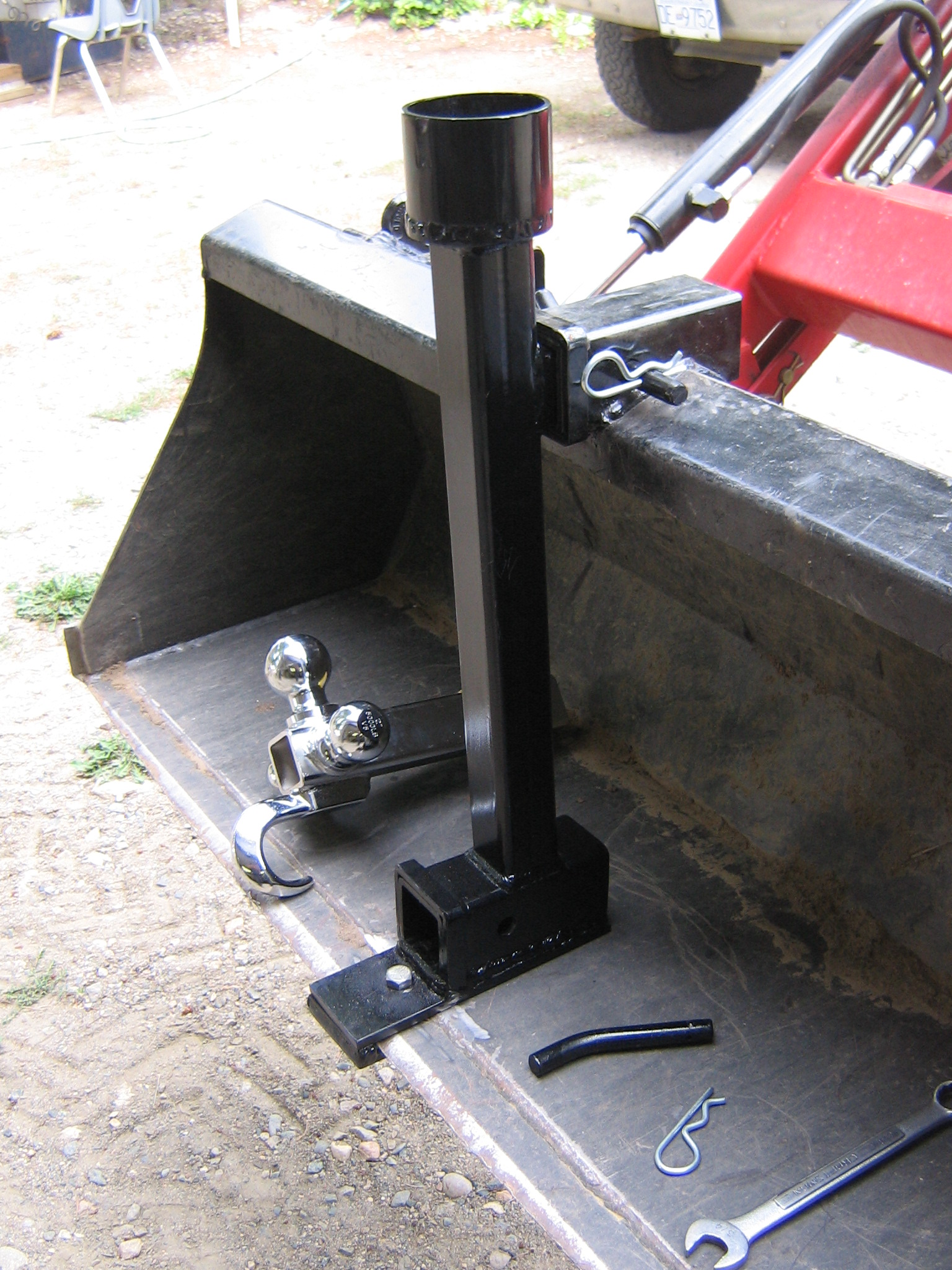

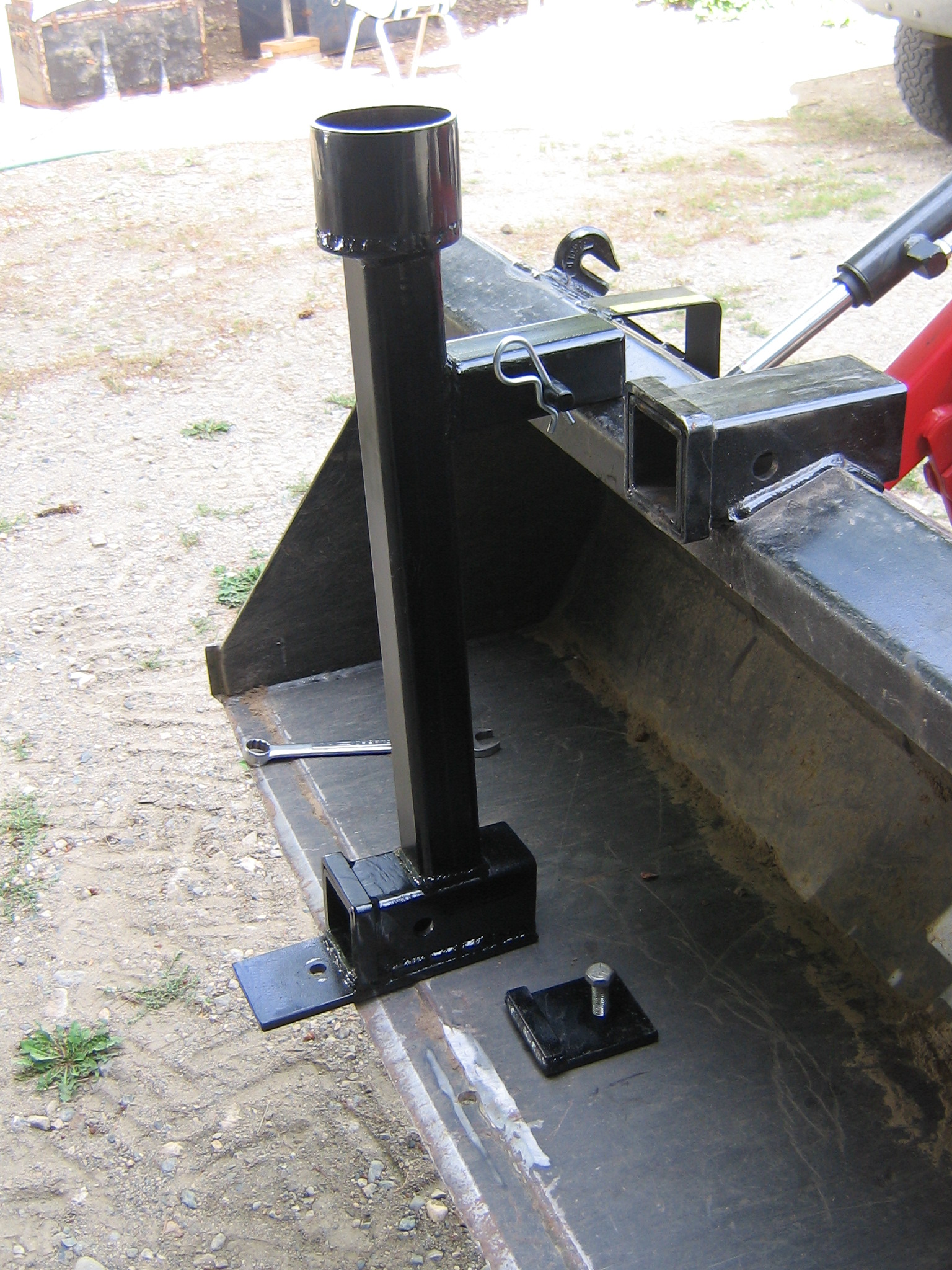

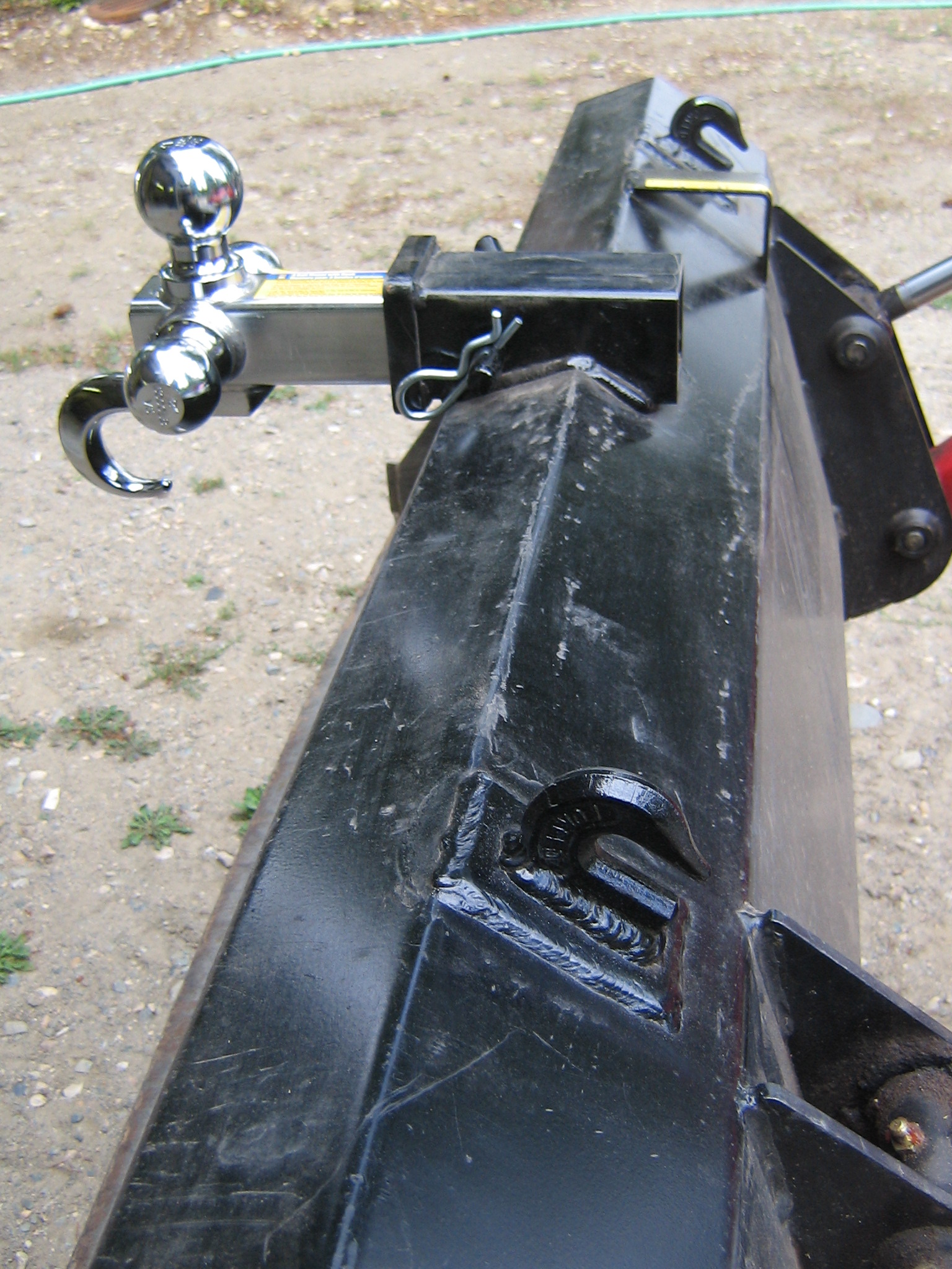

I move my small 5th with my GC2610 front loader. The trailer weighs about 7500lbs. with an 850lb. hitch weight. While my loader will barely lift this, it moves it with ease. I have also moved my bumper pull trailer at over 12000lbs. with the load adjusted for a lower hitch weight. I wouldn't consider doing this on a hill of any size. I have pictures previously posted on a thread titled GC modifications. Unfortunately I don't know how to supply a link and don't have them on my current computer.
   / Which compact tractor will move 5th wheel campers? #24
This one?
I've added some grab hooks. First I welded on a piece of 3/16" plate, around the perimeter and a large button weld. After cutting some hooks to fit, I welded them to the plate. I also welded in a receiver for a trailer hitch to move trailers around the yard. Unfortunately, this didn't go well as I bent the top of the bucket. It was easy to fix, and then
I made the adapter to strengthen the bucket for this task and to lower the hitch. This has worked well to move my trailers around, including my 5th wheel camping trailer using the cup on the top of the adapter.
View attachment 278784 View attachment 278785
Computers hate me. I spent about three hours making the adapter and over an hour to post these pics after taking them, on the 4th try.
I've given up on trying to install the pics throughout the text where I wanted them.
