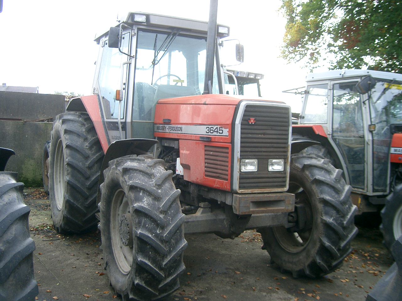

Sorry Mark
I must have you confused with an older model? The 3600 series I am refering too was produced in the late eighties until the mid nineties and ranged in eng hp from I think around the 120 - 190 hp. The 3645 I was refering too was powered by a Perkins 1000.6t series engine. Earlier versions had a speed shift trans and later had the dynashift trans. Both had 40k option (25mph). The Speed shift version was changed by turning planetary gears around in the speedshift unit and the dynashift was done electronically. It did this by locking out C & D speeds when 30k (20mph) was reached.
I,ve just done a quick search and now I see what you are talking about, sorry about that, it was definitely my mistake. This is what I was on about.
Once again sorry. Also cant tell you too much about the new one that you are looking at? I can find out for you if you like, I have a friend working for Agco in the UK.

No problem. Yeah, I was talking about the newer 3645 as seen below:
