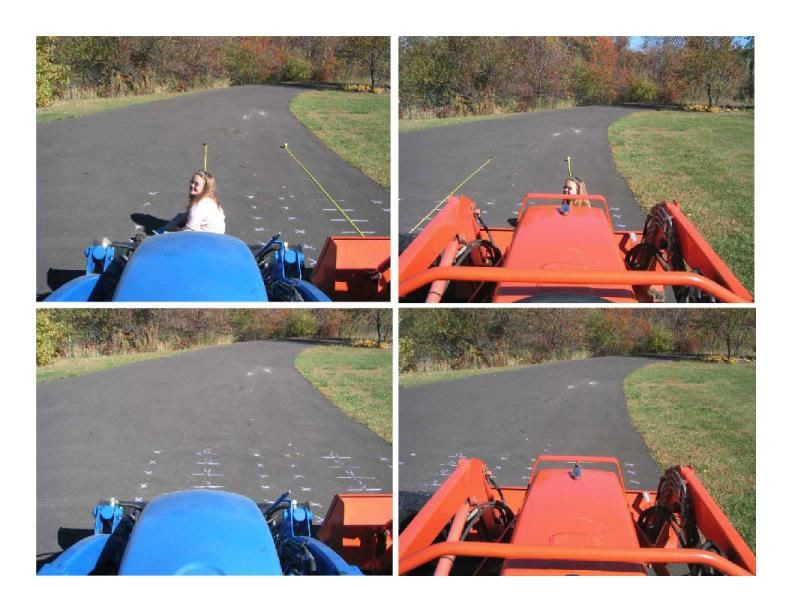

Also, here's a photo from that same thread. I think the style of hood as I stated earlier will have as much influence on visibility as the loader. This photo is from that thread and shows what I mean.
HEY HOW DID MY DAUGHTER GET IN YOUR PHOTO :D
Well I guess that was originally my photo, it is probably 2+ years old. :)
One thing you will notice with the NH is that you can see the bucket corners. You absolulely cannot see the corners on the Kubota. When working up tight against a fence, your wife's prize rose bushus, or building, it is really nice to see the edges of your bucket!
There are 2 key points to visibility. Over the hood and at the bucket edges. The NH hood, on all the new style Boomers (since at least 2000) is sloped. You will get good visibility over the hood with either style of loader arms. However you will only get good visibility of the bucket edges/corners with the curved loader arms.

Should have given you credit for the photo Bob. I thought it was a great visual illustration of the difference in the older and new style tractors. Nice job. Thanks.
