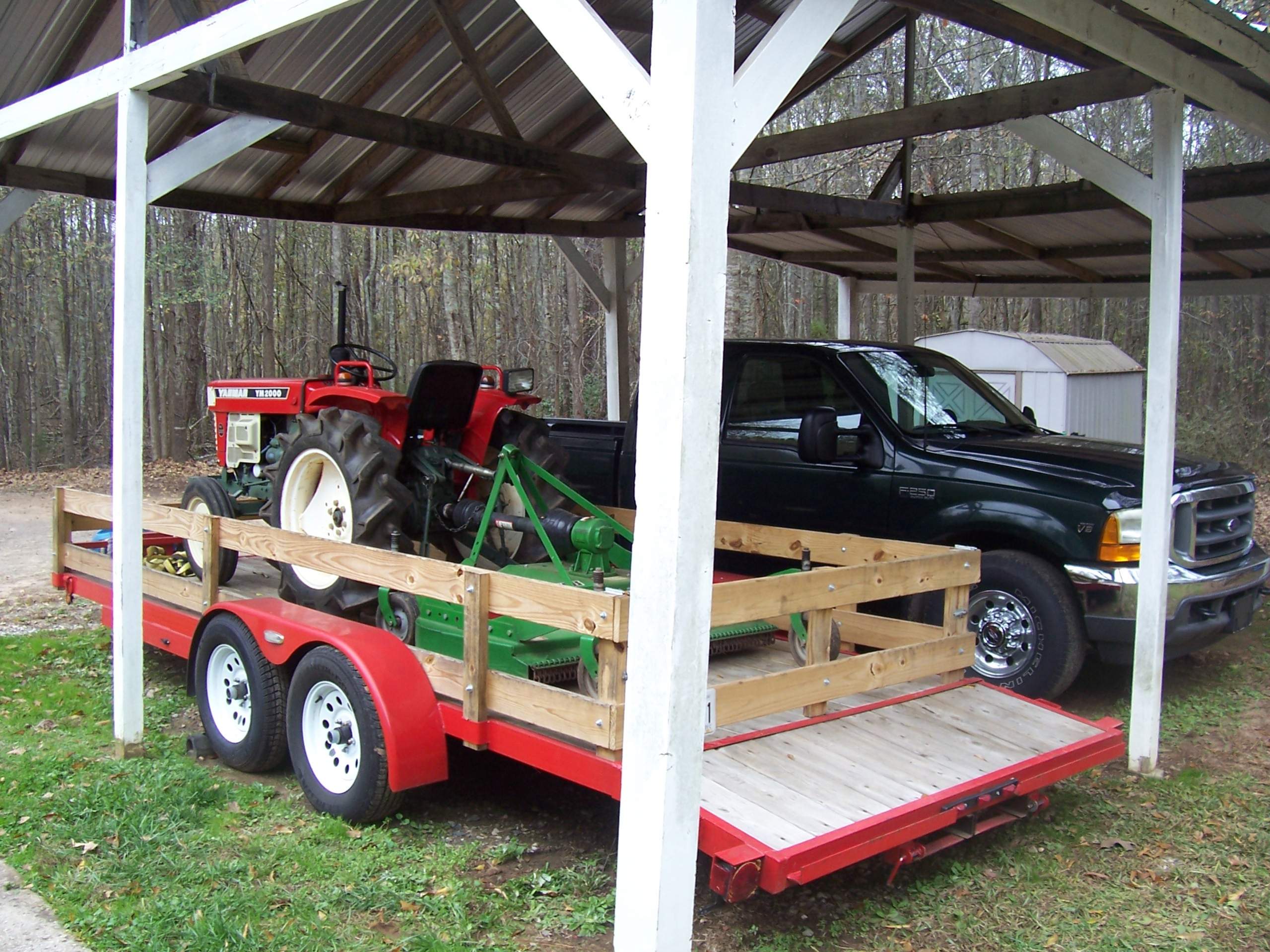

Just happen to have this pick out.I bought this Frontier 1060R On craigs list a few years back for 550.00 and it has been great no problems what so ever.Not sure of yours but I'm just 24Hp or 20pto and pretty much open cutting also.
Carey
