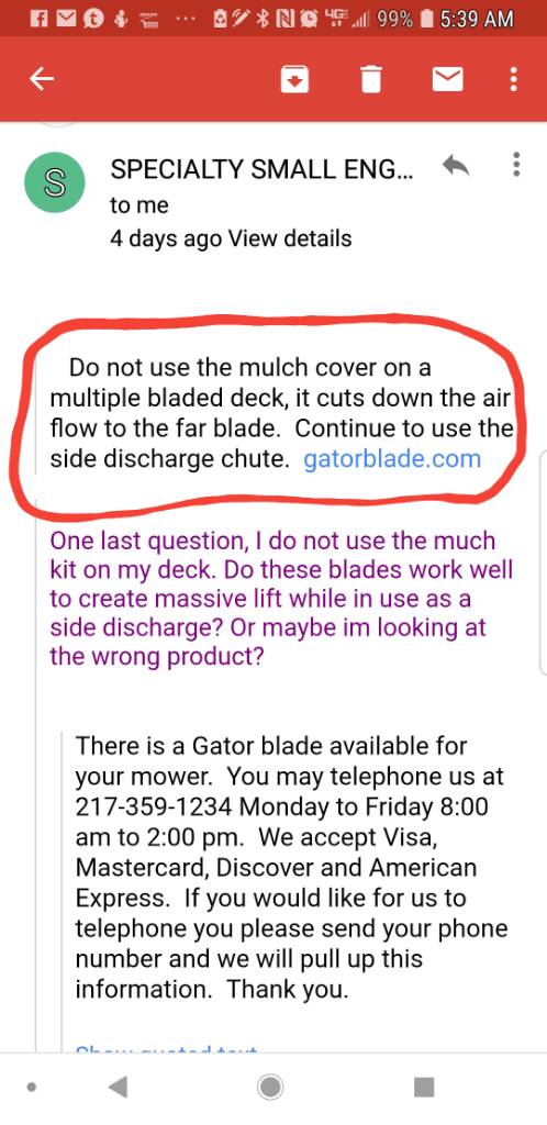

I was going to say it.... but since you did, I will call you up. I emailed back and forth with them about blades for my XT3 GSX that does not have any upwards suction. I explained that I side discharge and they responded that side discharge is what I need to do with their blades.
Straight from the horses mouth...

Thanks for the comments regarding engaging the blades at a lower engine speed; hadn't thought about that, but it makes sense that it would be easier on the clutch. I found today that engaging at idle will stall the engine, but a small increase in throttle works fine.
I got these blades installed today & mowed a small section of grass as a test. So far, they're a big improvement over either the original JD blades or the blades that came with the JD Mulch Control Kit. No clumps or rows of clippings whatsoever.
The section I mowed today was with the mulch door closed. I'll try it both ways tomorrow when I mow the rest of the lawn & see what happens.
