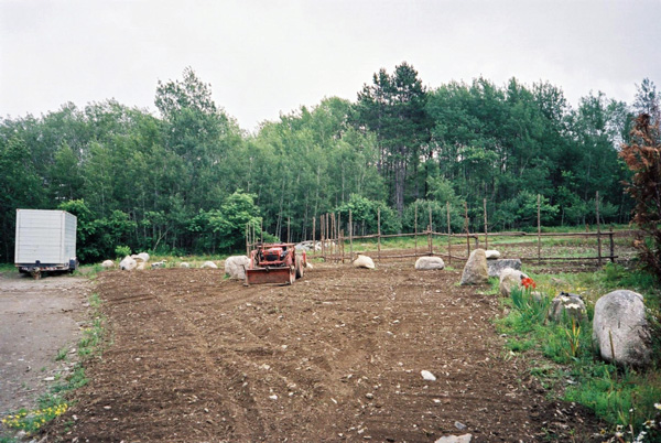

This is from actual experience with a 11? PTO HP tractor and 44 inch rototiller working in 50 year old sod on a clay based drumlin with lots of rocks. :D
Back in another location working in sand there were no problems with the rototiller. Only problem was going to slow and it would dig too deep and require more HP than my Toy Tractor could provide.

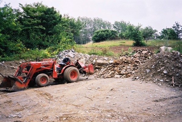

Some pictures of the one field I have rotatoilled and then a picture of a pile of small rocks I picked up off it while tilling. I'd set the cruise and walk along and pick rocks and throw them in the bucket as I was rotattilling.:D
I must admit my experience is not extensive. It involves about 10 acres of tilled up Drumlin with a Toy Tractor.:D

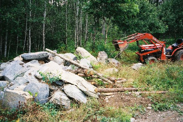

And here is a picture of some of the bigger rocks the tiller found!:D

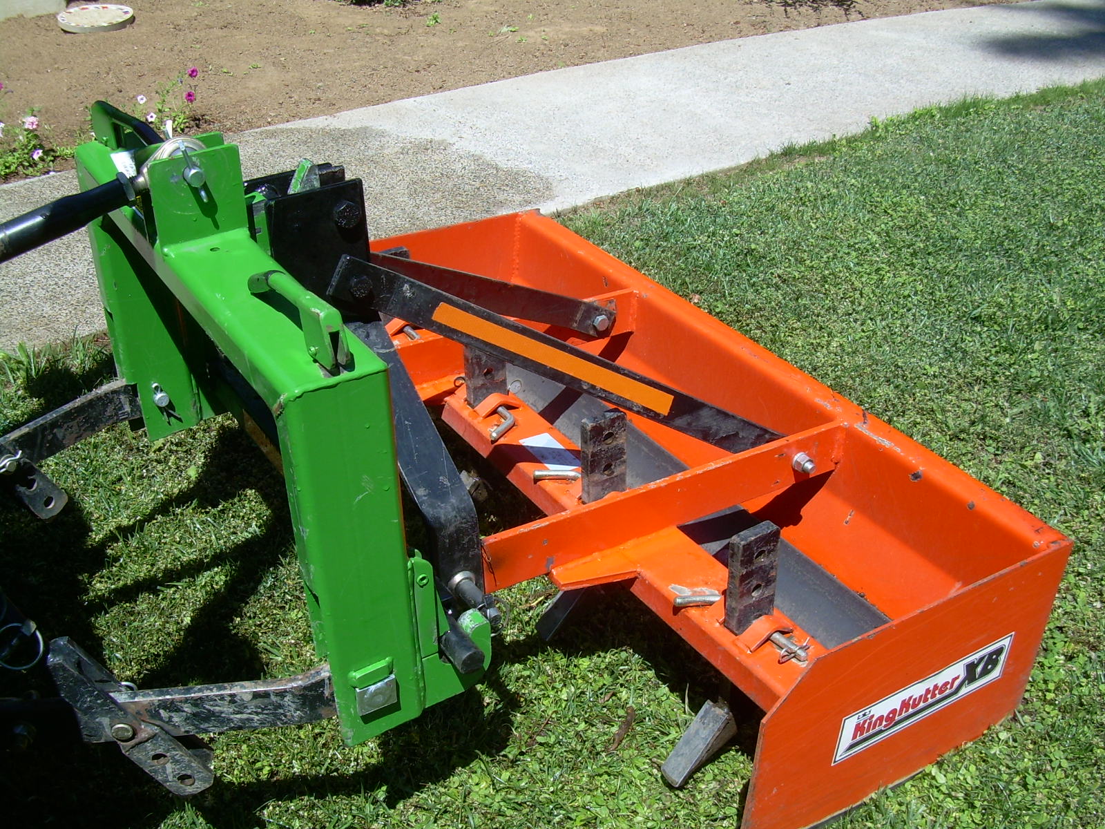

King kutter makes an 'XB' line of implements for SCUT's.. it has a tiller that is only rated UP to 25 hp. I'd guess he'd have to use something like that.. plus suitable low gear / slow ground speed.

When to the King Kutter webiste and called this maunfacturer. Asked about the smallest Tiller (MODEL: TC-48-XB). They said, the PTO minimum is 17 HP and don't have anything for a smaller tractor.
redalrt's PTO is only 13.6 HP. I'm sure you could hook it up, but like in Egon's post, probably too slow.
Maybe redalrt should stick with a box blade (w/scarifiers).
