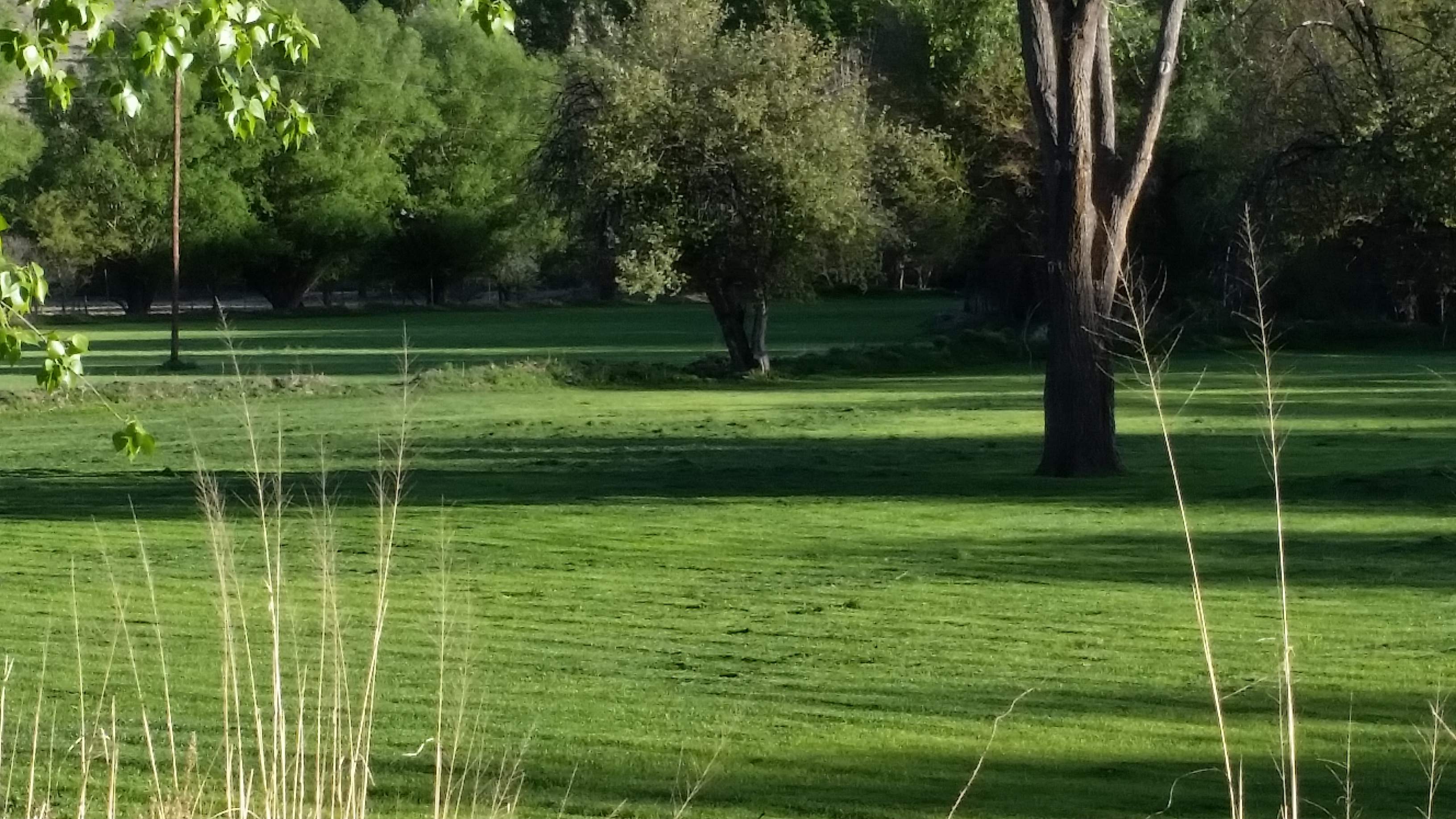

If you have a weed problem then consider tilling and broadcast the seed heavy. If you have enough rain in the fall and winter the fescue should root well enough to choke out the weeds.
Most weeds are not coming back after late September , hopefully by next spring you should have enough grass roots to make it more difficult for the weeds. I would use a root stimulator the first year too.
The first time I planted my lawn in April-May I got a total crop of weeds with very little grass. A friend of mine with NRCS said to let them grow and till them under at the end of August. I did that and replanted and got a weed free stand of Fescue over the winter.

This goes back to my original post regarding using a rotary cultivator on the weeds. Cultivate, broadcast seed\fertilizer and cultipack.

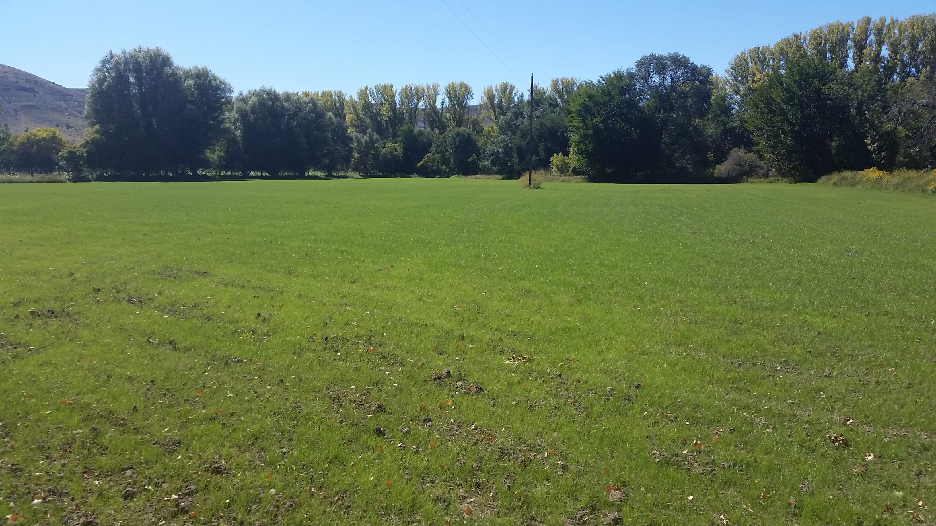

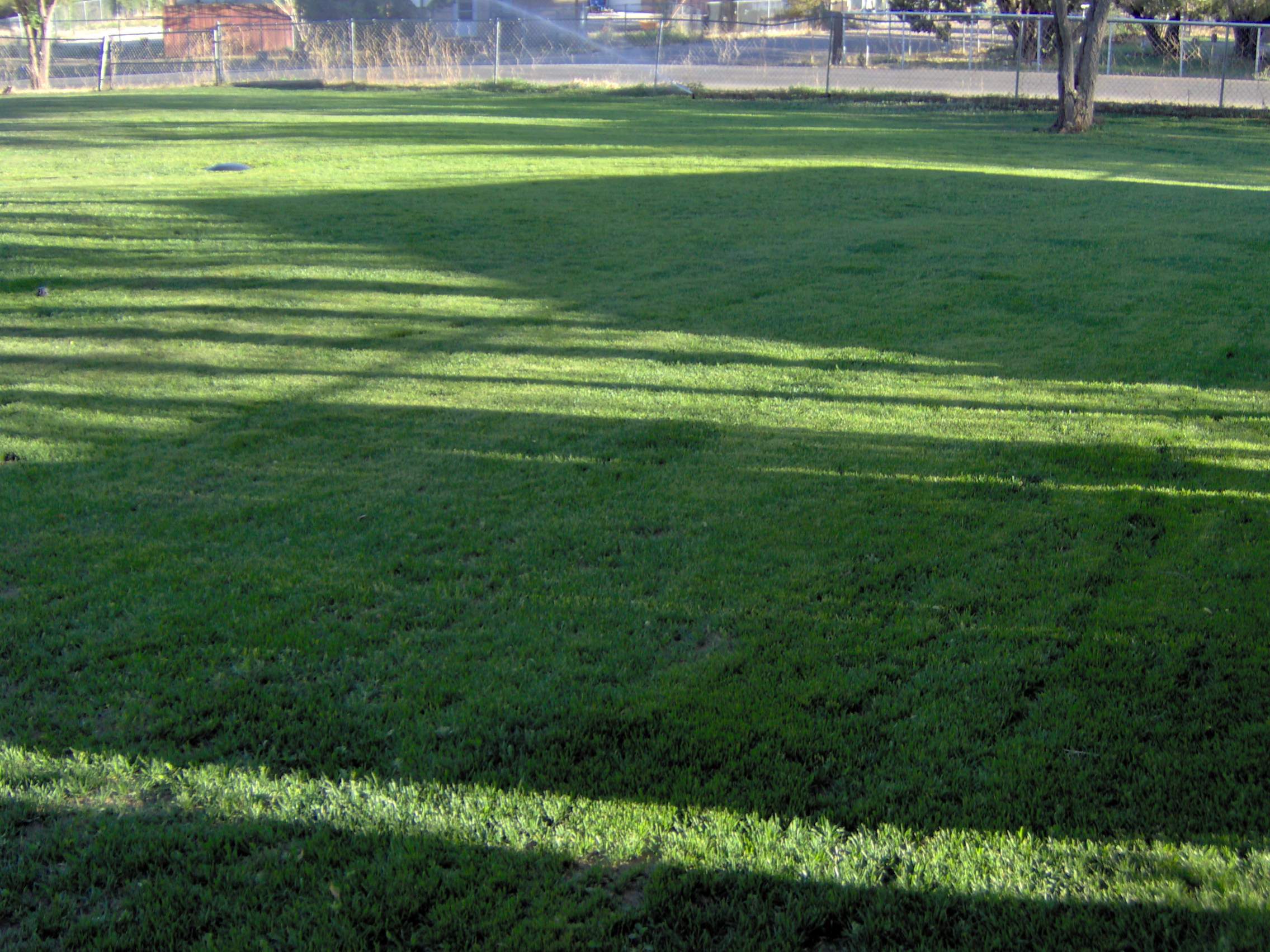

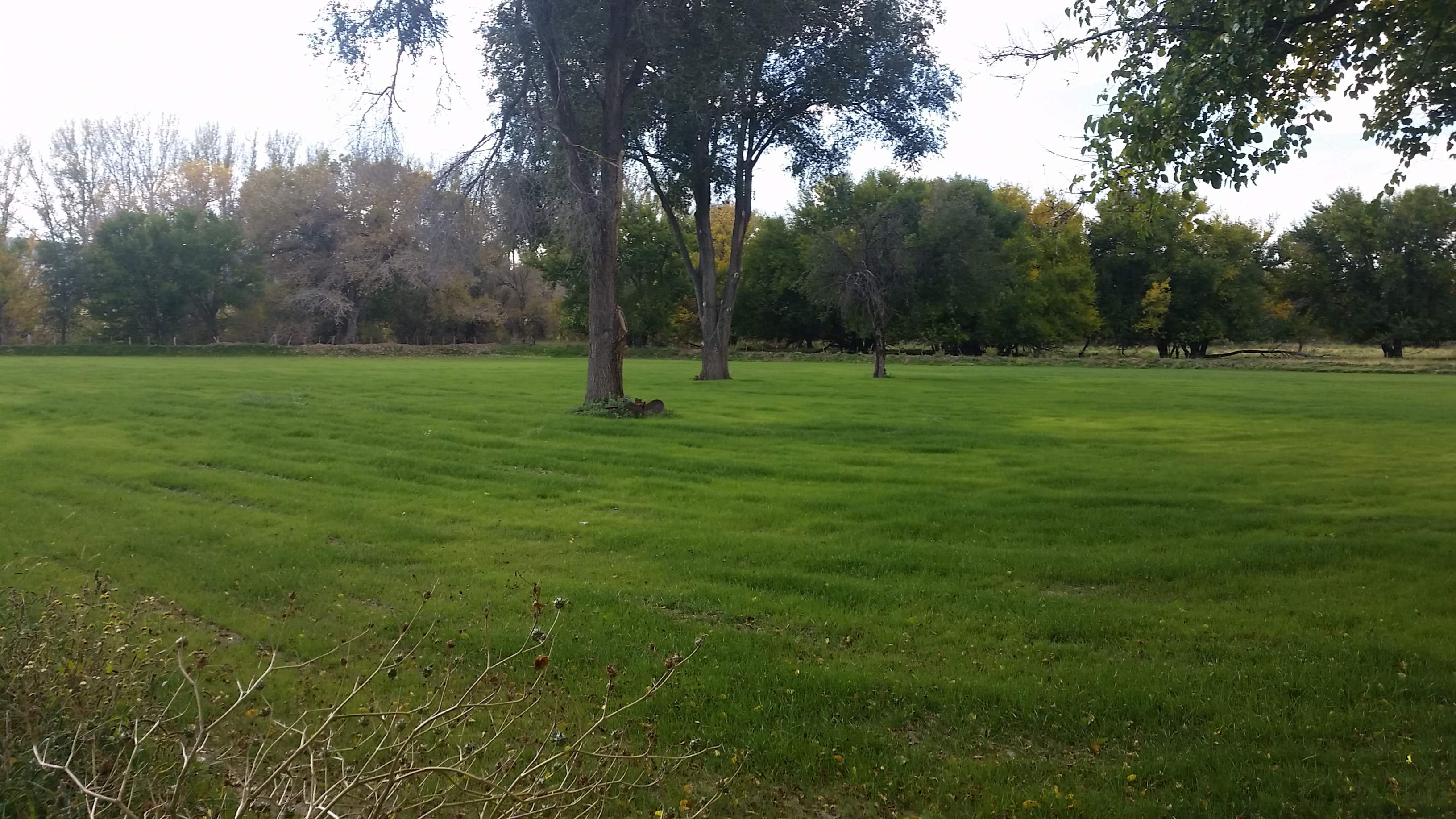

I use a roller but a cultipacker is on my wish list. I use a Deere 673 (73") tiller and like it but would also recommend a King Kutter II as they have a good following here and are a lot of bang for the buck. There are lots of good tillers and I would recommend the 6 tine per rotor models with the larger rotor diameters. With 40 pto hp you should be able to pull a tiller first pass about 1.2 to 1.4 mph and a second pass perpendicular at 1.7 to 2.0 mph. That should take about 2 hours/acre including both passes. So about 40 hours for the 20 acres you mention tilled about 6 inches or better. If you till less depth your time will be less.
Heres a few pictures of jobs I tilled and planted in the last year or so.

The Ford 4610 has a rated 52 hp pto which is probably slightly less under real world conditions. Anyway, I should have sufficient hp for a 60 - 72 inch tiller. I certainly like the results you achieved with your tiller, my goal is results like yours. Having read several threads on TBN about rotary tillers, it seems that most use it for small garden areas or lawns. Am I missing something here? You are using your tiller for large areas with excellent results. Thanks for taking the time to share your expertise.

You should be able to handle an 80 to 84 inch tiller with your tractor and save a little time. I would have bought that size for my 4520 if I had known. I used a 40hp tractor for the example. In most conditions I can till at the same speeds I listed using the epto and reduced engine speed. With heavy sod I use the standard pto speed.
I prefer tillers for compact tractors in most cases because the pto is more efficient on hydro tractors than a constant hard pull. I also like the fact that tillers are more compact than discs and easier for me to transport. A tiller in one tool does a good job of getting the soil ready without a multitude of other implements. Good tillers and good wheeled discs are fairly comparable in costs. Both do a good job and I find there isn't much difference in total time per acre getting a good seedbed ready.
