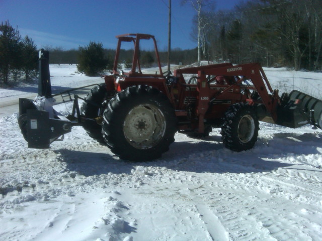

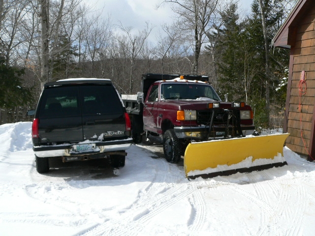

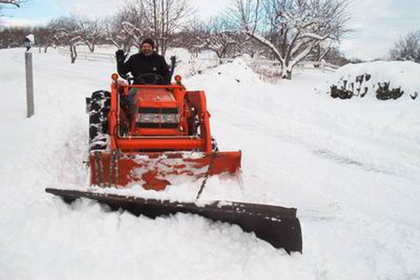

I have plowed snow all different kinds of ways and I say that doing it from a warm cab is the best approach! :)

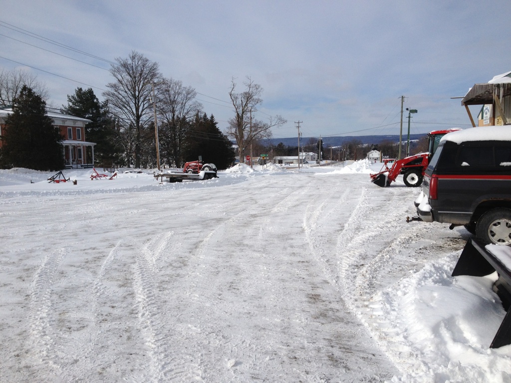

So far this year, once a week at least lately, I'm using the old trusty 72" back blade... And the FEL to make neat little piles. :) Sometimes I push, sometimes I drag. Just depends on how much you want to get in and out. The only problem I have is when it get over 8-10 inches deep, I have to make a couple of passes. backbladeparkinglot.jpg

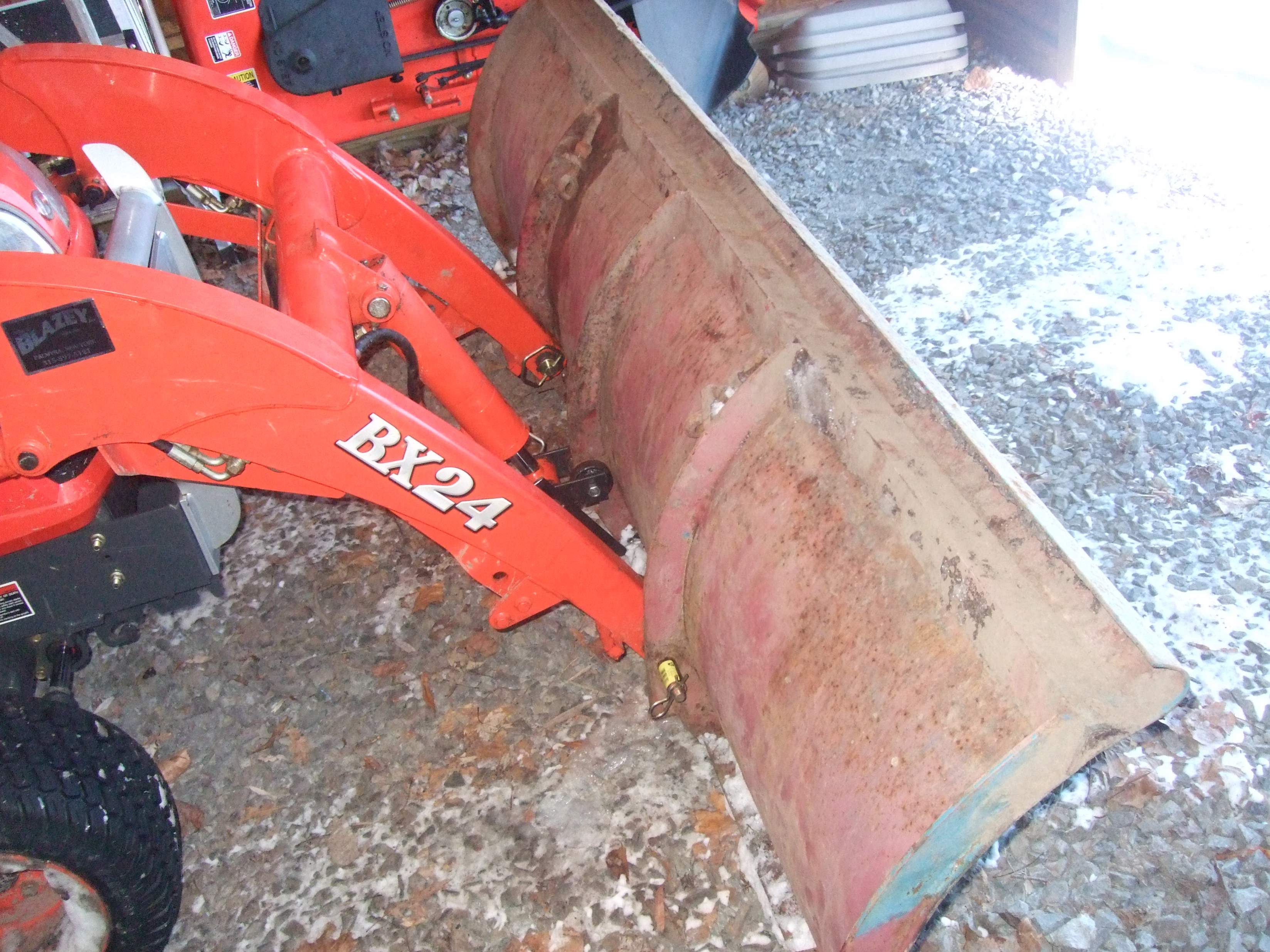

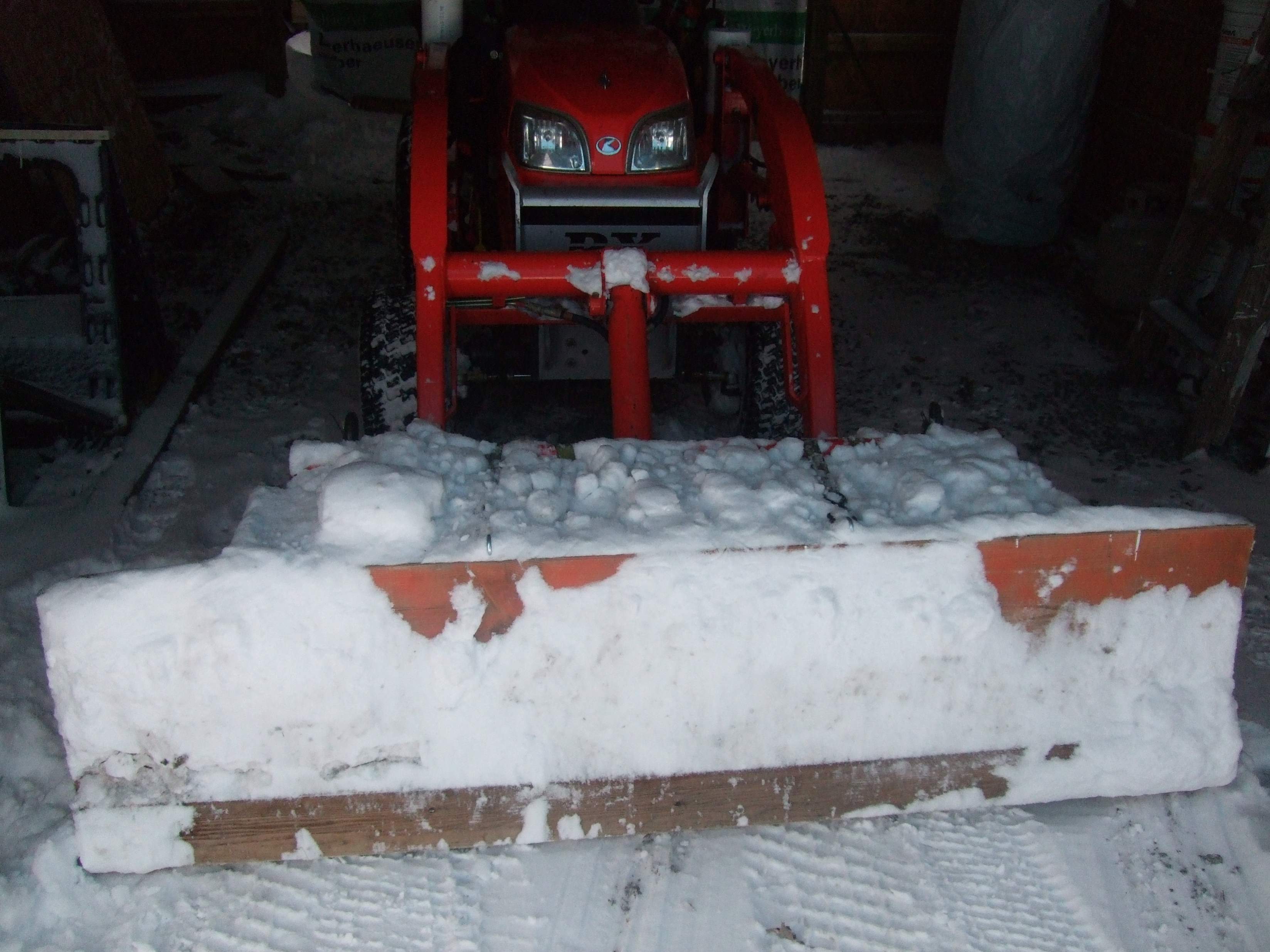

The way I see it, if money is an issue right now and you need something now, You could build a V plow to go on your FEL with whatever scrap wood you have just like another TBN'er did but he did a angled plow. I think in your case you are better off with a V and put it in float. You will get all the traction you need since the tires will always be on cleared path. A front mounted truck plow on tractor FEL is nice, no need to maintain another vehicle IMHO. When I first got my tractor, I had scrap 2X12's and made a poormans pusher and used that for couple seasons then I pick up a free truck plow and modified it for my FEL arms. At first I connected it like a dozer blade as a pusher for one season , then later I modified A frame to go on the FEL so I can angle it the following year and been using it this way since .it been economical this way for me.
