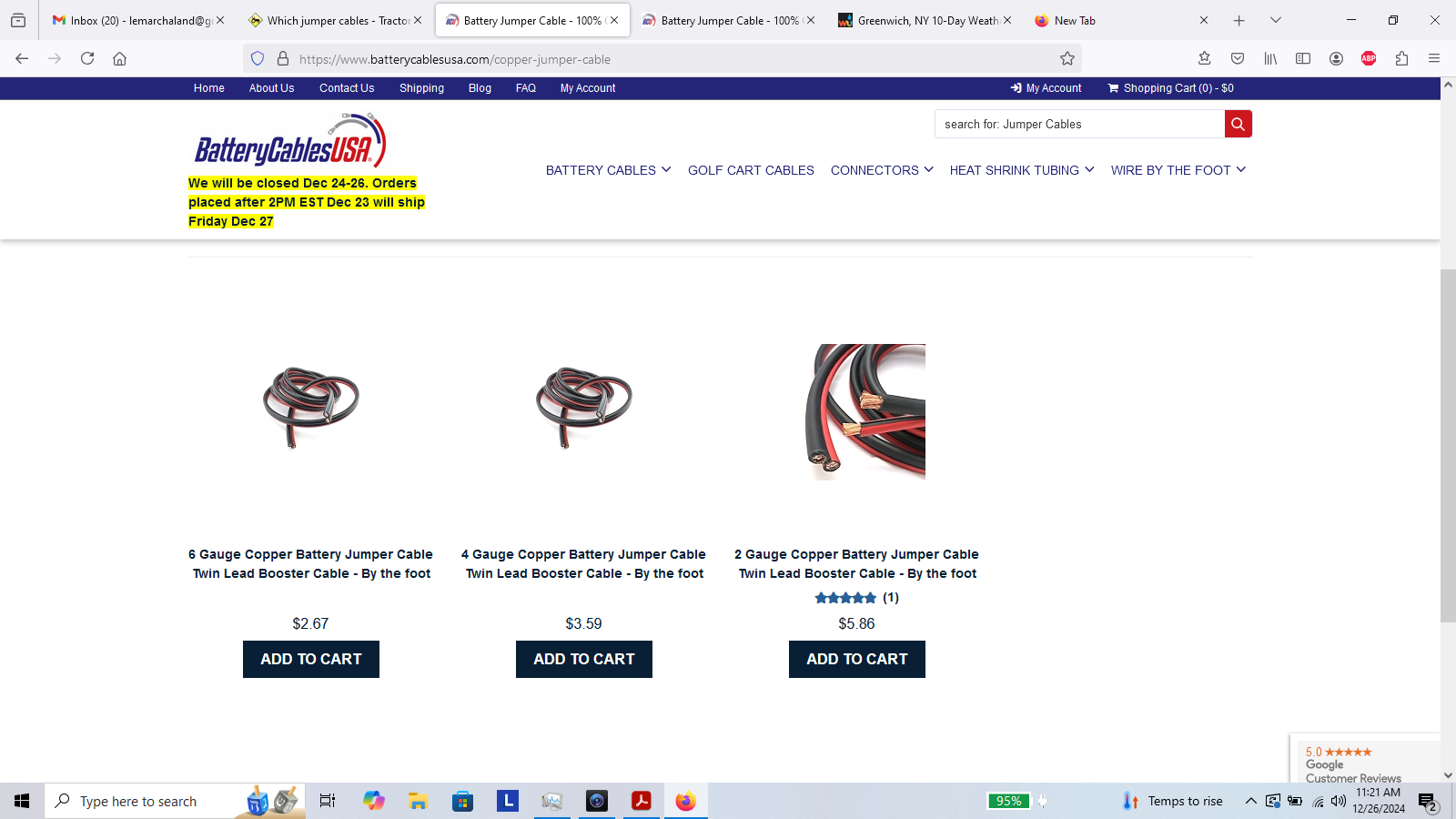

Any of the twin lead cable on this web site will make better booster cables then most you can buy.
Battery Jumper Cable - 100% Copper Twin Lead Booster Cable
Kind of OK, fairly good to real good, of course 25 feet at $5.86 a foot hurts a bit plus the cost of the 500-800 amp clamps to go with it. I like 25 ft cables for those times when you can't get to the front of a vehicle.

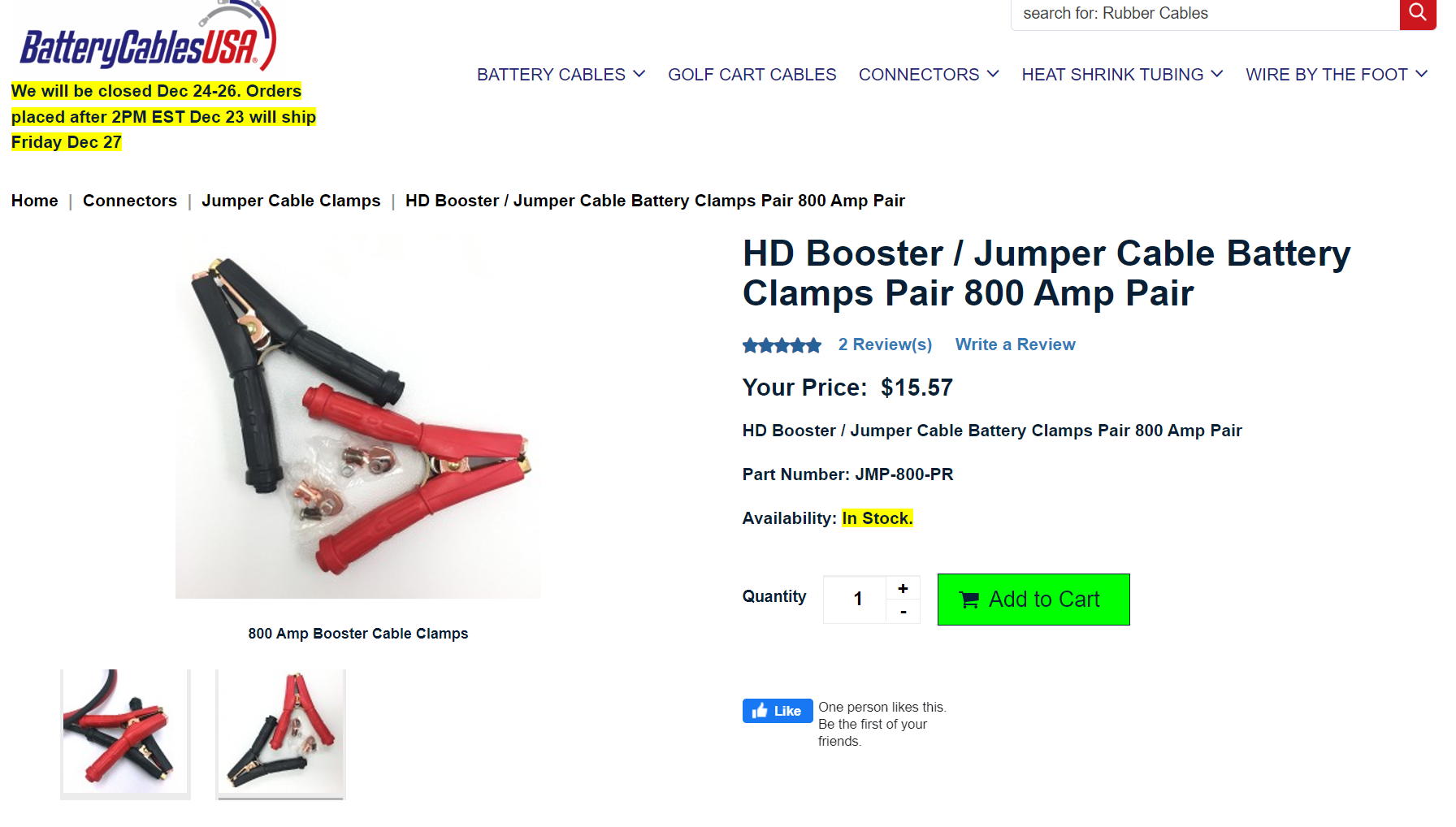

If you bought these clamps how do you attach them to the wire, do you need a special crimping tool?
/ Which jumper cables #9
I had a very nice pair of jumper cables at one time but haven't been able to find them for a while now.
I beleive that they are using an "open" ring terminal for the cable to lay in which can be closed up with repeated clamping with vise grips or in a vise. My preferred method if I don't have or can't find the right sized crimping tool is my vise (using it as a clamp) and I'll often lay a small pin punch in to get a good solid "crimp" I have also used my press but that is getting into a bit of over kill.

In picture looks like comes with wire ends. Attaching to copper wire I'd be sure about 3/4" or so insulation stripped off, wire & connectors clean, flux, solder (60/40) "tin" both then solder together. Hammer clamp ends over wire. You want as low resistance, good tight connection possible.
I'd use some dielectric grease, then screwed onto clamp tightly.
The lower the resistance, the better the connection, the more current it can carry.
