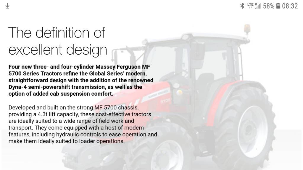

Bavarian, I'm not really into Agco, but Dyna4 and Dyna6 are powershift transmissions offered in base Masseys, and the Dyna-vt option would be what is said to be same as the Fendt. So yes not all Masseys have a Fendt transmission but don't blanket statement it that they're not the same
/ Which manufacturer has the highest HP true HST tractor? #47
Oops, I was not aware of the VT option. In which models is it available. There is a video on YouTube from the Millennium Farmer. He tested a tracked Challenger which apparently had it as well.

Hey no problem, I think the smallest one would be in the 6700 series, and yes you're right plenty costly for most looking for a utility tractor. Deutz likely makes the smallest vario unit that's available in North America that's not classed as a compact tractor.
