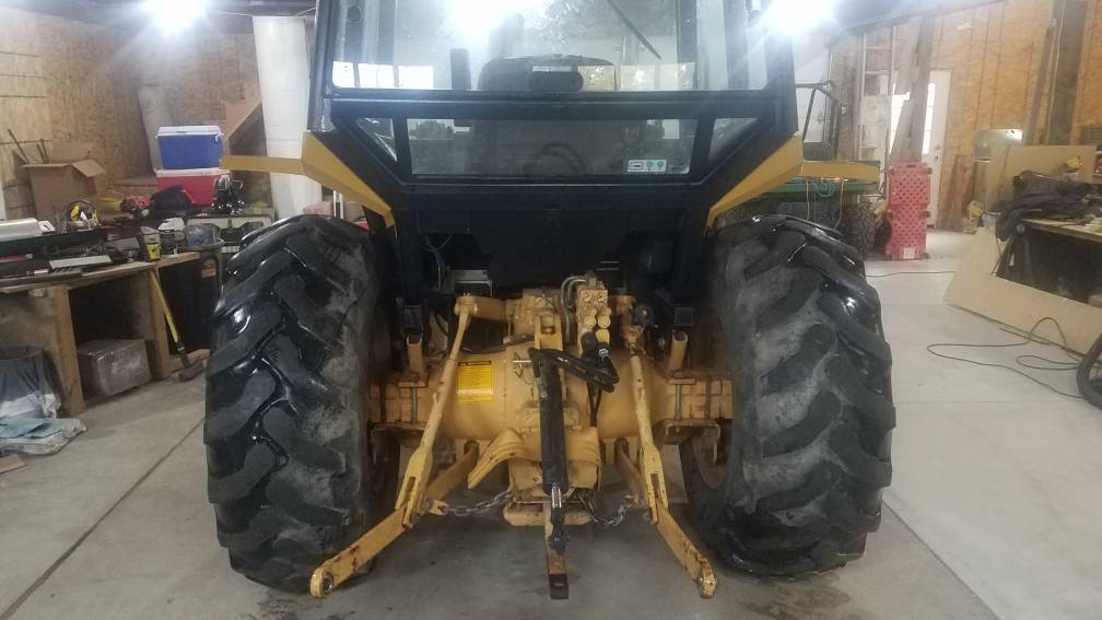

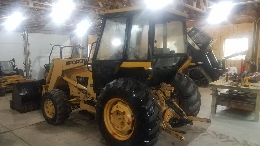

I just sold my Ford/NH 545D industrial Tractor/Loader. It has a shuttle lever with a torque converter. Not clutch operated... No clutch to be found. They don't make them anymore. I think 2001 was the end of the line.
Easy to operate... Not as easy as HST but not bad. Crazy strong loader. 20181027_111811.jpeg20181027_111647.jpeg20181027_111616.jpeg

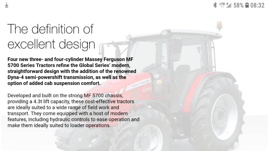

The MF DYNA4 is a powershift transmission, shifting gears. The Vario is driven by a hydrostatic motor.
