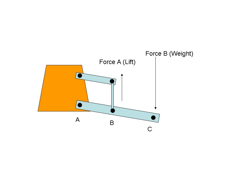

madslick said:
To calculate the new weight rating with your attachment, compute the torque generated from the attachment as a function of the weight of the attachment (COG) and the distance the COG is from the Lift Pins.
Derate lift capacity by the torque.
Wrong. The torque is on the tractor frame. The hydraulics apply lift to a parallelogram linkage. The implement does not pivot wrt the tractor like the liftarms do and thus lift diminishes only a small amount with distance behind the lift eyes. This amount is attributable to the imperfect geometry of the linkage.
larry
   / which model lifts 2500+ #18
larry
Ha ha, ok,
Please see the attached pic.
If joint A is fixed (Analysis by reduction), the Force (weight) applied at Joint C, reduces the lift capacity by the Lift force as a function of the length and position of cog at Joint C.
M= F x d ( in perpendicular cases)
The Lift arm linkage can be reduced to a perfect perpendicular case by disecting the vector into it's vertical (y) and Horizontal components (x) and analyzing the vertical component.
SOH CAH TOA
Again, my original statement stands...
If you don't agree please try to prove your point.

   / which model lifts 2500+ #19
madslick said:
Ha ha, ok,
SOH CAH TOA
I dont follow your prose - you seem to have left out point B of the diagram. The diagram will suffice however to suggest that your two posts are not coherently joined. Werent we talking about a 3PH? Since, once we add the 3rd point, it is a parallelogram linkage, the force at points C [the lift eyes] will be applicable to the implement, lifting it straight up without pivoting it wrt tractor. Note that there is no torque at points C since they are pivots. Consequently, regardless of where the weight of the implement is concentrated, if that weight is less than the force at points C the tractor will lift it. If that weight happens to be too far back you will have to add front ballast to the tractor or the wheels will come up.
If all you were saying is that the force applied at point B is reduced as you move out on the arm to point C, I agree. My point is that the force reduction [almost completely] stops at C with a 3PH. Thus implement COG location affects only handling, not lift capacity.
larry
   / which model lifts 2500+ #20
larry
Crapiola!
I forgot the Top-link...
That explains our Differences.
Ha ha ha
At least my picture was able to identify the fault in my analysis...
NO TOPO LINKO!
Thanks Spyderlk
Later...
