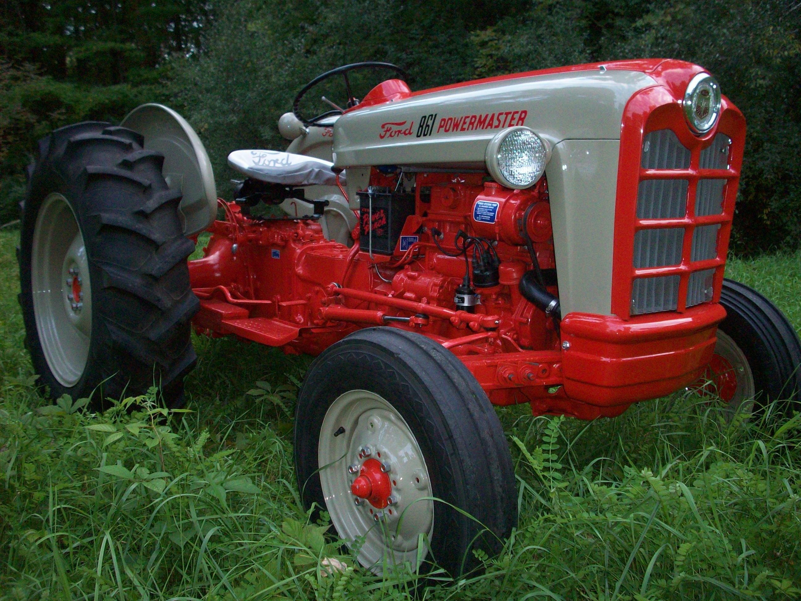

This is my dream Ford tractor. Someday I will have one.

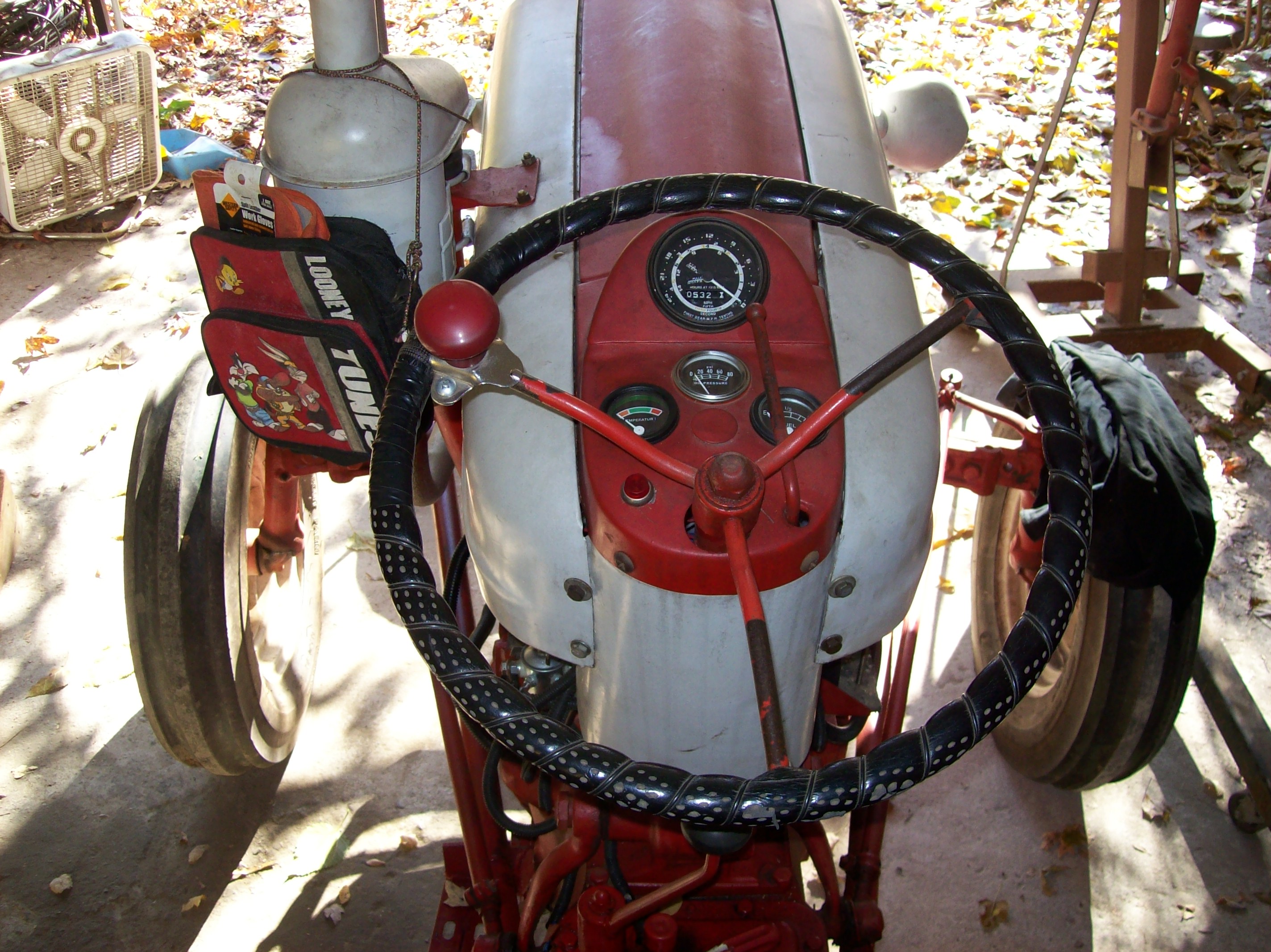

I had a 1949 8N for about 16 years. My father in law convinced me to get one. A darn good little tractor for it's size and simple to work on and easy to find parts. In that time I had a chance to figure out what Ford I wanted that would better fit my needs and decided I wanted an 861 or 661. To my luck I found an '59 861 Diesel for sale a few years ago. It had some hidden surprises for me in the first 2 hours extended operation that cost me extra money in parts & my labor. I am still happy with my choice of The 861D model, now that I got most of the problems fixed that the seller failed to disclose. It has the 5 speed transmission that first gear is much slower than my 8N was. Someone can slowly walk beside this when in first. It has the dual clutch live PTO that can quickly be changed to a normal acting clutch with the change of a pin on the clutch rod. I love the fact that it is a diesel and I no longer have plugs, wires, points, condenser or a carburetor to fiddle with. It has proven to be much more dependable than the old 8N gasser. It is heavier and stronger than the little 8N was too. While it is a little more rare than Ns, I can still easily get most of the parts to keep her running long after I'm dead and gone. And it has the Red Tiger overhead valve engine. The N series engines were more like the early Ford car A model flathead engines.
I can see why! That is just a beautiful machine. Proof of how superior American engineering and manufacturing once was.....
Thanks. That helps a lot. There's a 641 close to me I went to look at earlier today. I'm going to post a picture as ask the community about the Sherman Combination Transmission. Is there a difference or is it the same as the Sherman Hi/Low transmission?

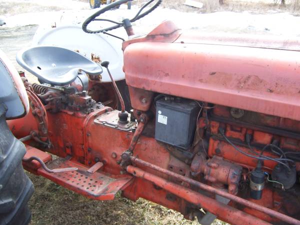

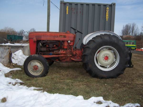

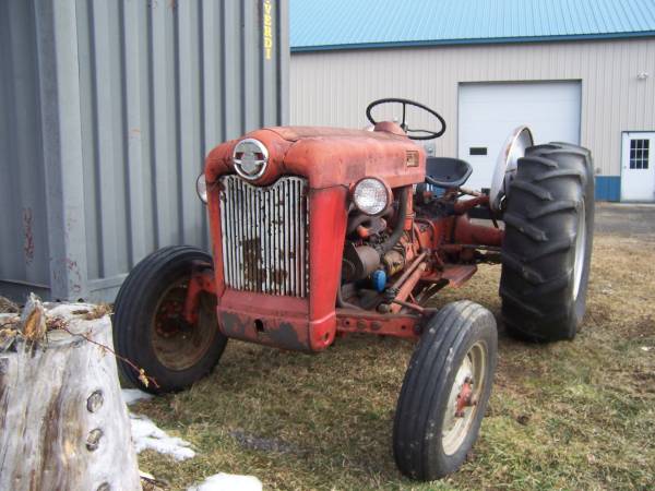

This is the one I looked at today. The unit is purported to have a Sherman Combination Transmission. You can easily see the lever on the left-hand-side of the unit under/to the rear of the air cleaner canister. Is that in fact, proof that this unit has a Sherman Transmission and if so, what, if any is the difference between the Sherman Combination Transmission and the Sherman Hi/Low Transmission? Any help would be appreciated.
I have never see any of the Sherman options. The tractor may have had power steering or both radial arms were robbed off of that era of one with power steering.
