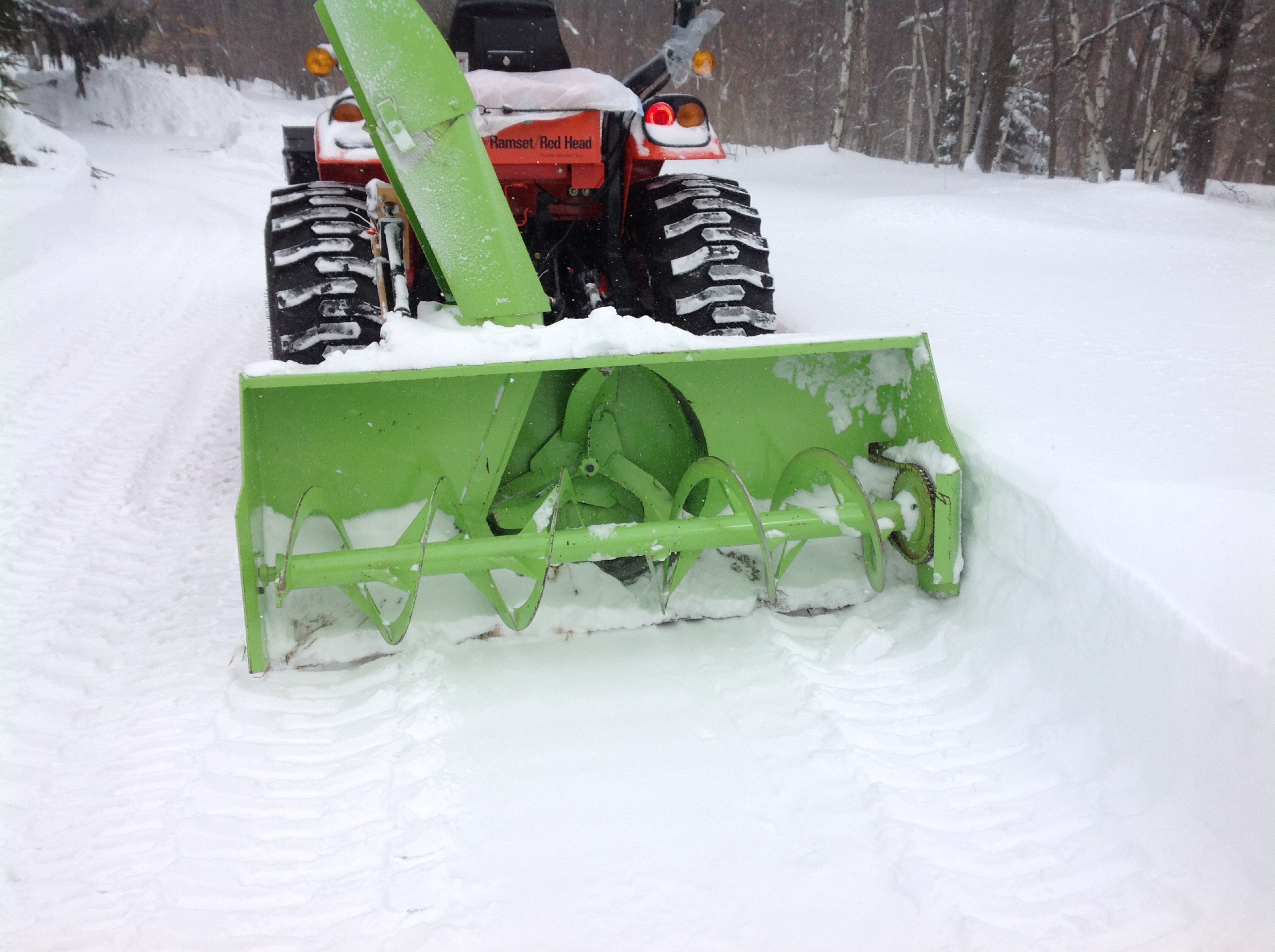

Chaos, I would suggest blocking off part of the drum on the chute side like in the pic I posted. On my blower this piece is welded and I can still can remove the impeller if needed. I have seen some blowers with 4 and 5 blade impellers that have this piece removable. Look at some pics of blowers to get some ideas.
X2 on extending the blade length with some steel.

Thank you Amvcane. What year/model is your beast? Some great looking powder for NEPA, what year was that?
I like your idea. Looking at newer machines, I was actually toying with placing/fabricating a piece on each impeller blade; in addition to the "extensions". Mounted on the "upper/discharge" side of the blade, like a wall that also acts like a scoop. Seems many of the newer models have that modification on their impeller blades.
Good idea but in one of the pictures it appears the impeller is 2" to 3" narrower than the housing so adding that plate will probably have minimal effect. If the impeller blades were widened to fill the housing then adding the plate would help a lot more.
   / Which Side Of The Impeller, Does It Matter? #27
Snow is from March 15, 2017.
The blower is a 1995 Schulte 6200. Bought it about 5 years ago. Still had the original shear pins in the auger and drive shaft...and still does.
Reb, I see what you mean about the depth of the drum vs. the width of blades. Wonder if the fan is a replacement from a shallower drum depth blower.
