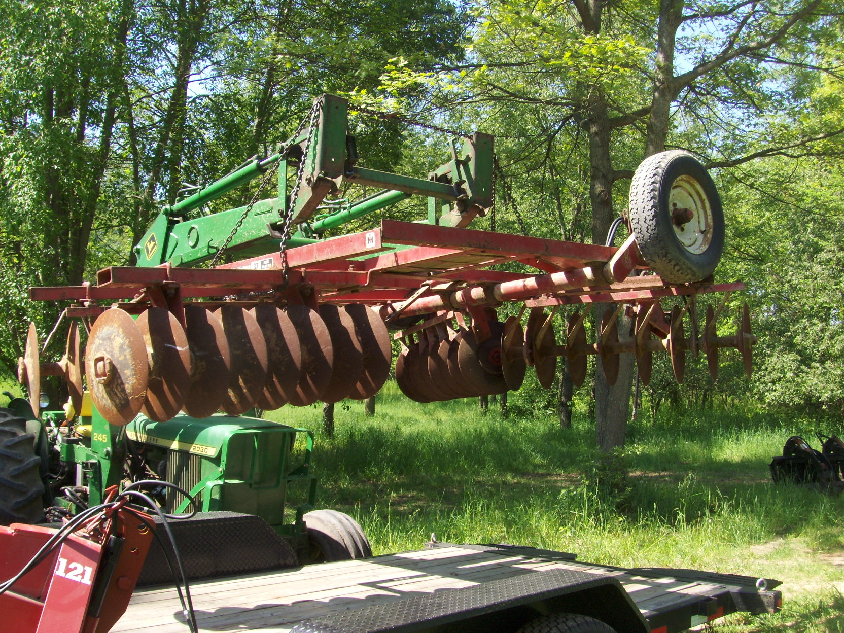

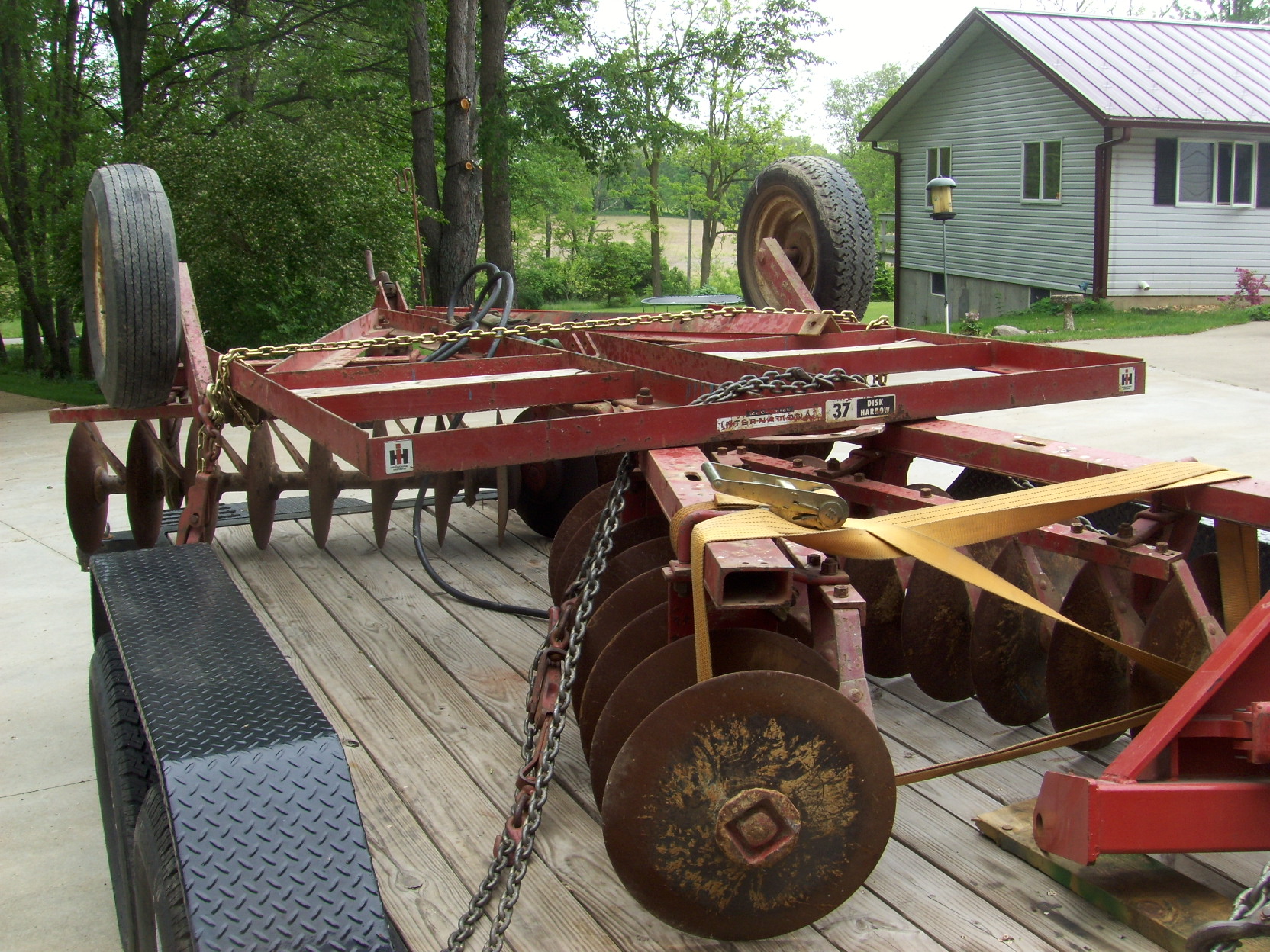

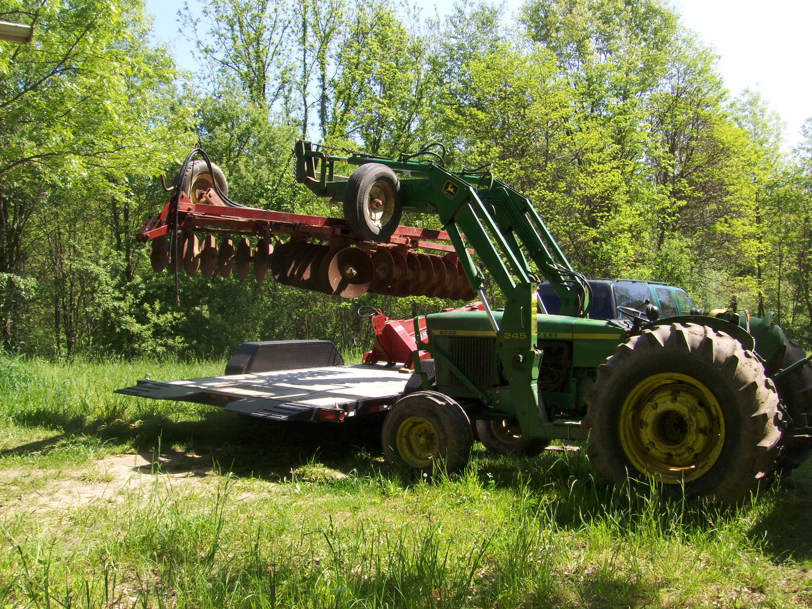

In my state you can't haul over 8'6" wide without a permit. Maybe your state is different. As for two trailers, in my state the first HAS to be a fifth wheel. There is a total length too. I would not get the 3pt hitch disk. I would also not get the 10' disk if I plan to transport it. I would try and find an 8' drag style disk. That's what I wanted. I ended up with a 10' only because I inherited from my FIL two states away. I took it apart to the point is was legal to haul. They only had a skid steer to load it. The skid steer barely could pick it up. I had to back the trailer under it. My JD2030 was able to unload with ease.
Another reason I would get the 8' is you may have to take it down two tracks in wooded areas on the property to get to areas you want to make food plots.
