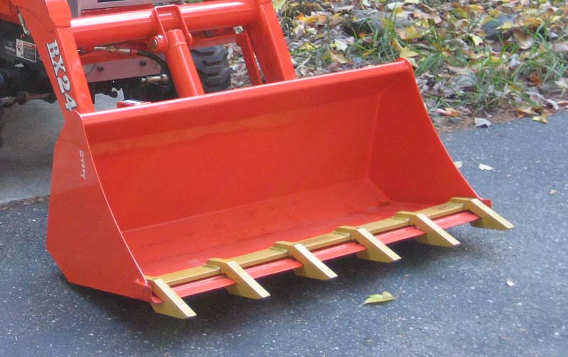

When we just spec'ed out our new BX24, I looked at Markham, but my dealer is now a Gearmore dealer, and they were able to match the Markham price for a 6-tooth Gearmore bar ($185). It does not require any drilling, being held on by 4 large set screws, with I kind of like.
So far, it has worked out pretty well helping dig into the hard rocky clay that passes for soil where we live.
