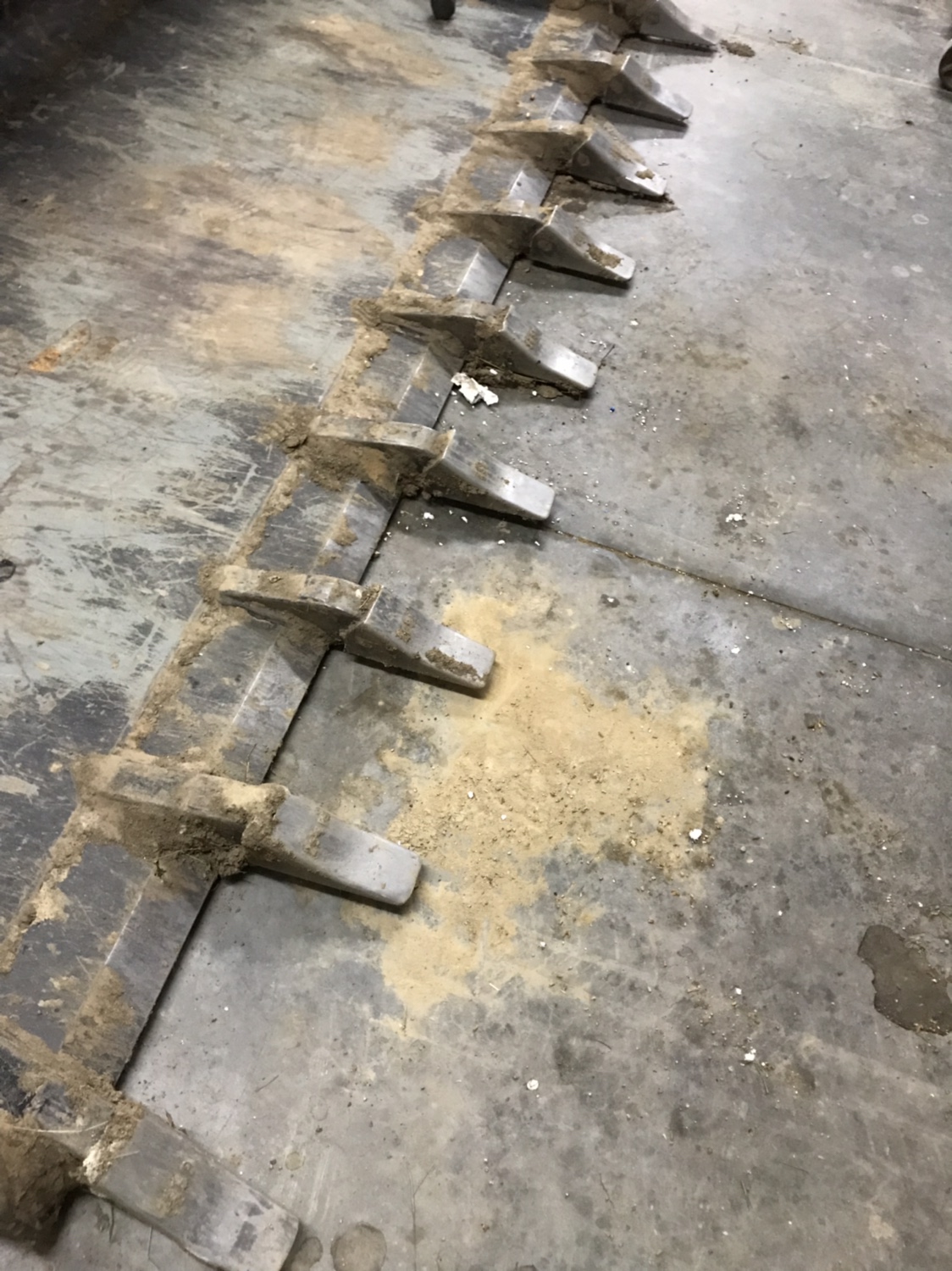

The Titan bar with the rolled up teeth is trash. They won’t cut with the bucket level. You have to roll the bucket down to engage the teeth and then it’s too aggressive. Second major flaw is the teeth are too big. Teeth are supposed to be sharp. Here’s what a tooth bucket is supposed to look like. IMG_7242.JPG
