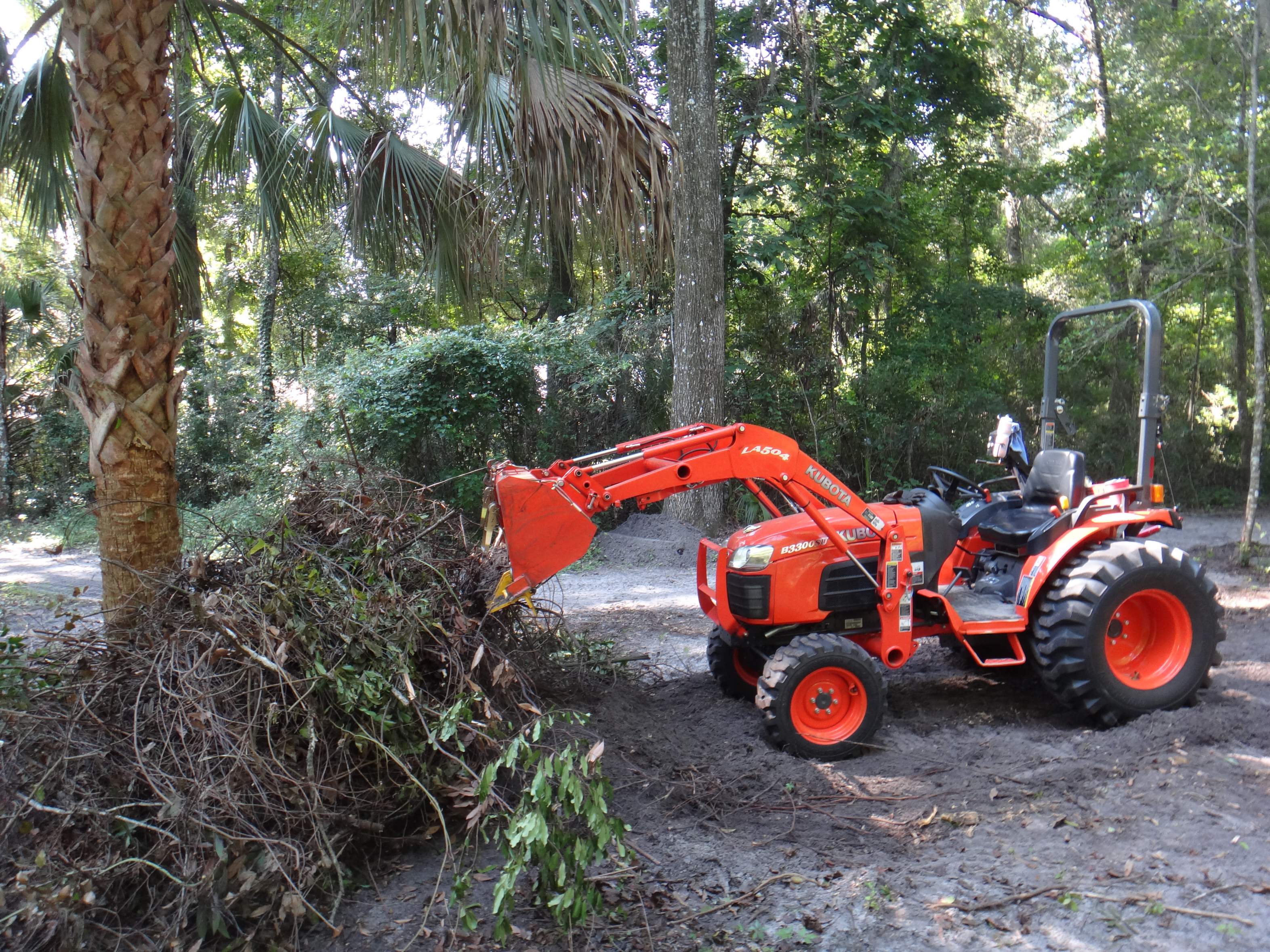

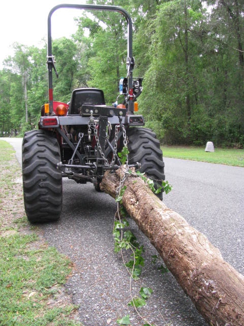

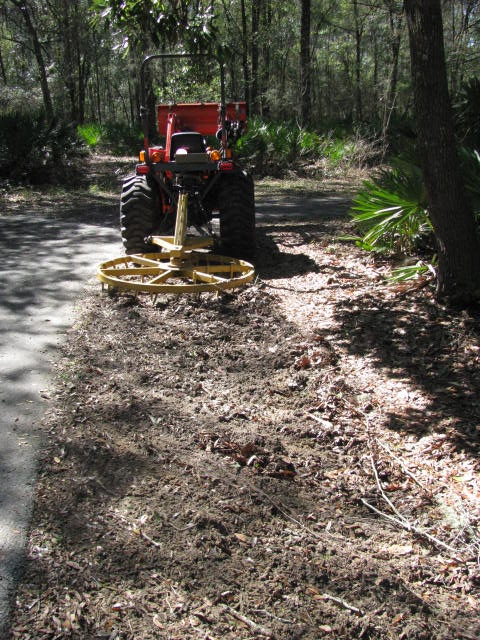

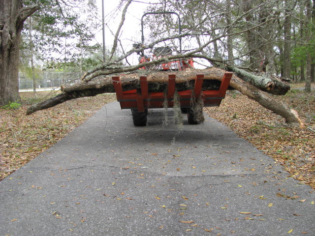

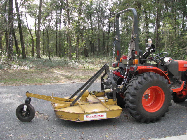

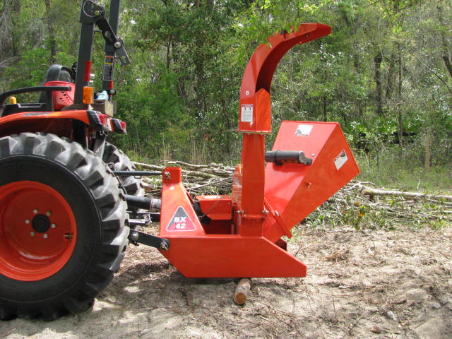

Look at the Kubota B3300SU tractor/loader PACKAGE. The tractor is either the same or VERY SIMILAR to B3200, however Kubota packages B3300SU with FEL, HST, 4-WD and everything else you need in a PACKAGE at an "all-in" price.
Personally, I think you do need additional power of the larger tractor, which is still not very big. Everyone has a budget but it is worth streaching a little more not to be underpowered. When you get out to your food plots you will be very glad to have 14" ground clearance on B3300SU.
Test drive the B3300SU before you order.
