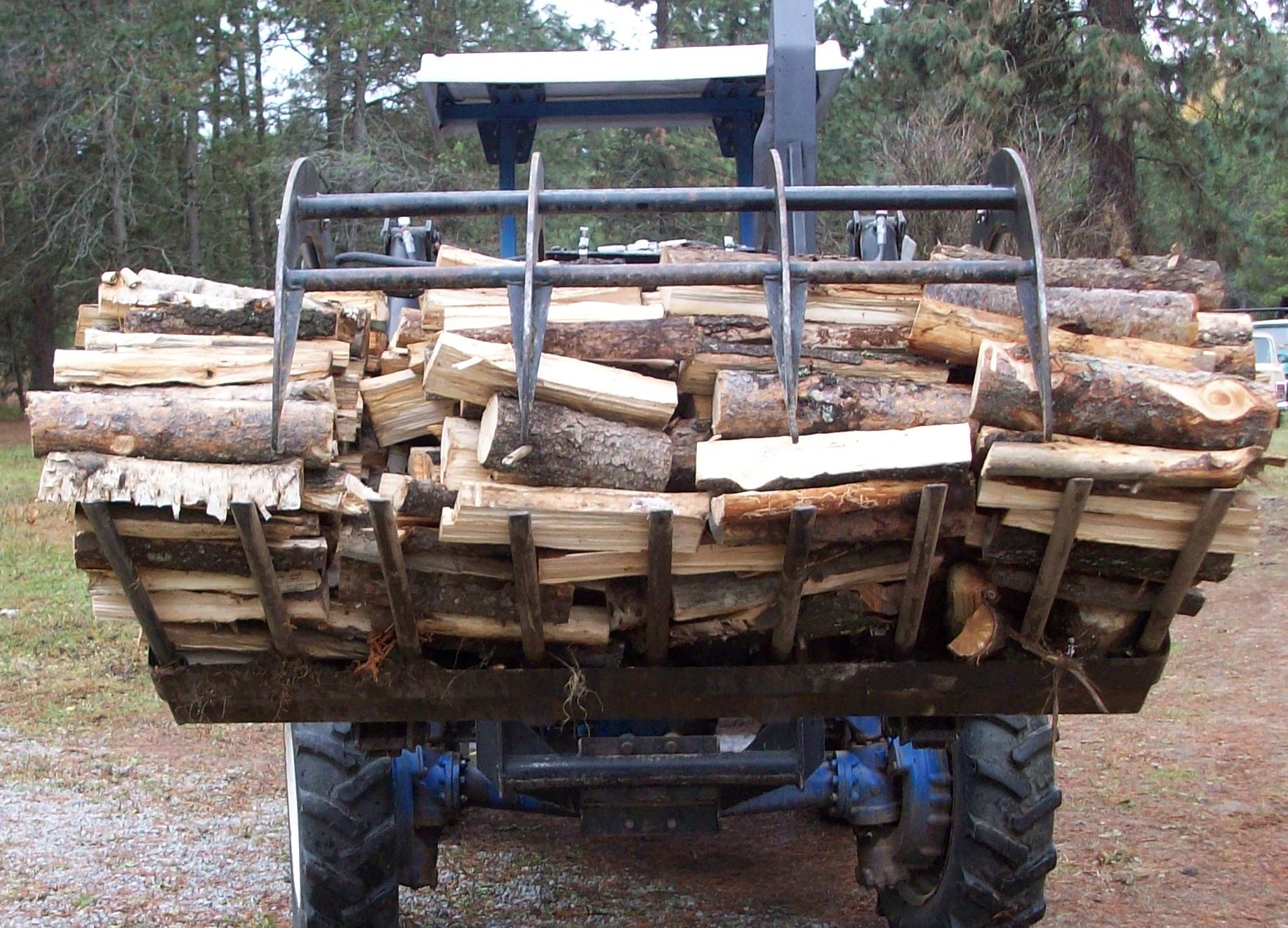

Congrats on the new grapple:thumbsup: that was a good idea on the extra tines to keep the wood stable.. If you heat with wood and move the split wood sometimes with the the grapple more tines will really help rhino-wood 002.JPG even with 9, I have to get a little creative with the stacking, but my wood stove likes 16 inch pieces.
Working out your tines/width you should be at 8" spacing just like mine, should work great especially if you cut the wood a little longer...

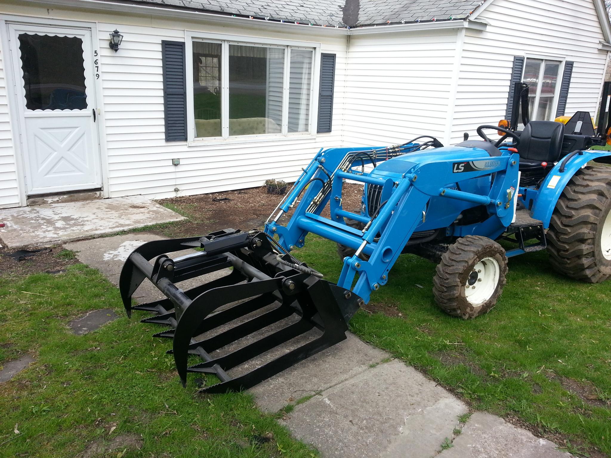

My grapple arrived today (well I had to go to the terminal to get it due to several shipping snags) I am happy with how it looks so far. I do wish I had opted for one that had more tines on the upper lid, but I figure I can always make something to bolt to it (for 'back raking').
What grapple did you end up with?
   / Which type of grapple is best suited for... #170
Those gussets on the upper arm tines look strong enough to bolt something to each side to cover the middle gap.
I don't think you will be back raking with the upper jaw tines. Try tilting the open grapple to full dump position, I am guessing that your bottom tines will touch the ground before or about the same time you can get the upper tines to make contact. The upper jaws are not designed for that type of work. Instead, just "rake" backwards with the bottom tines. I do it all the time. Also, the bottom tines are designed for that sort of punishment. I would worry about twisting the upper jaw if you tried to rake with it. The upper grapple arm is really just for clamping a load in place. All the strength is in the bottom tines.
