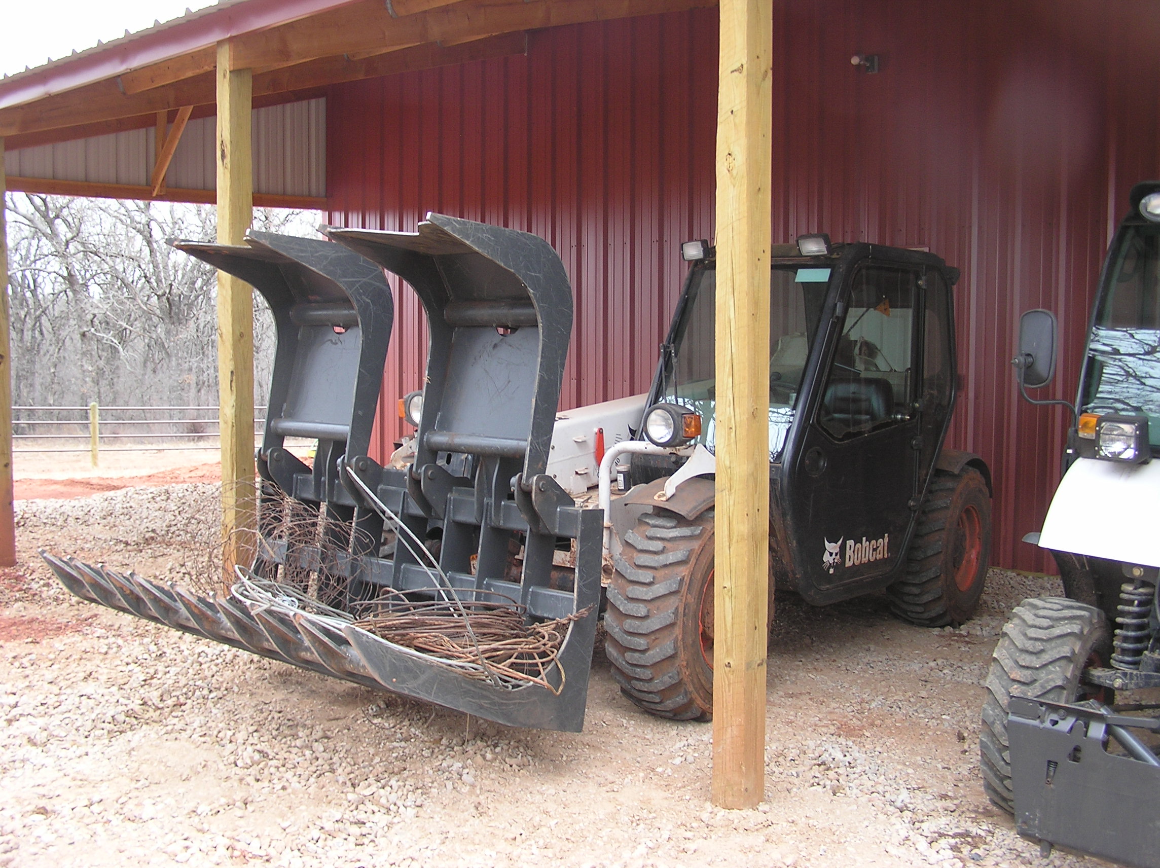

.....Curved bottom time tips would be my preference but I haven't heard anyone with straight bottom tines complain.

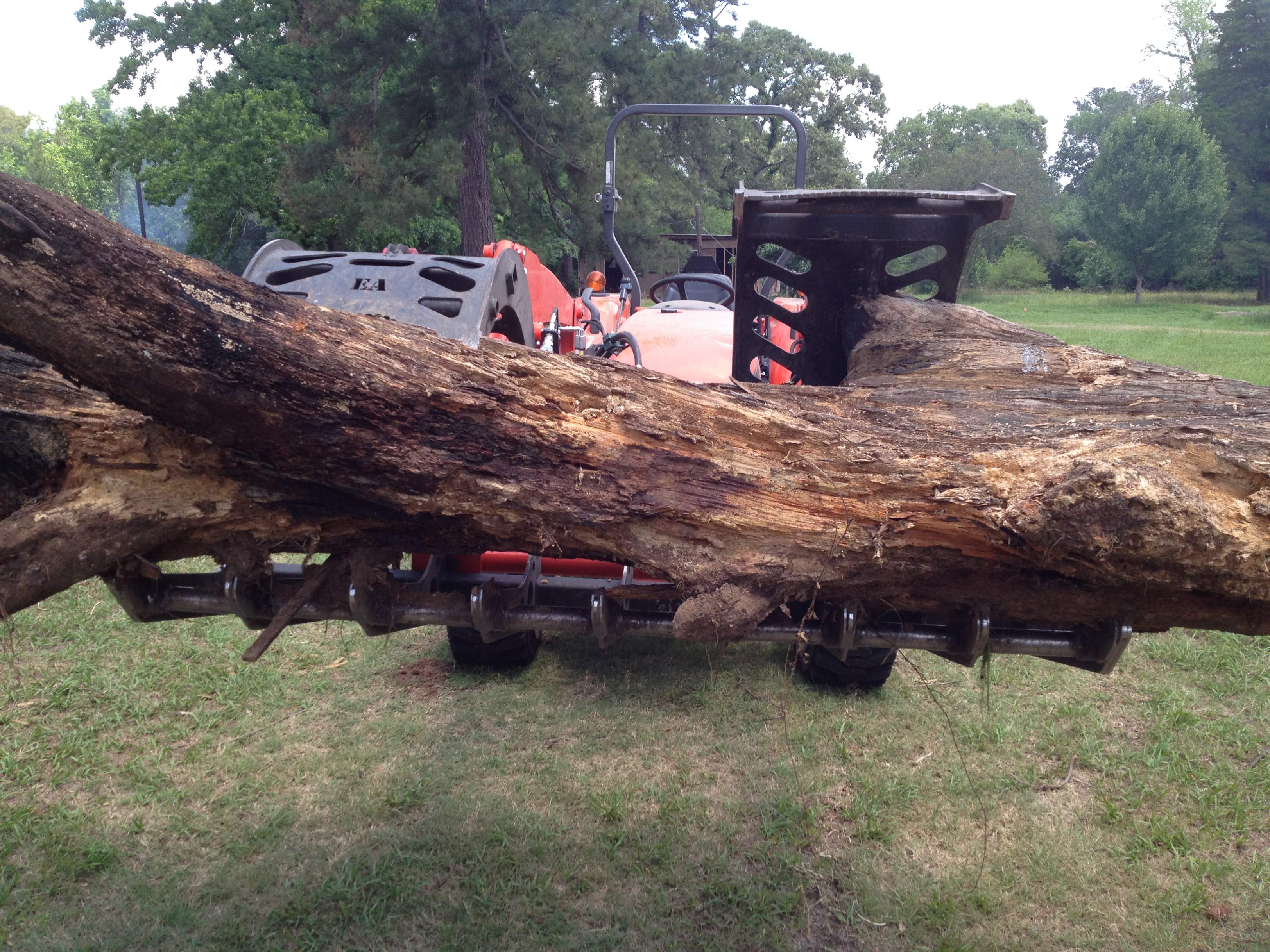

Straight works for me. With some sticks in it, and you tilt it, moving forward to get more, they slide up against the front teeth, that are angled up, and stay in the grapple.

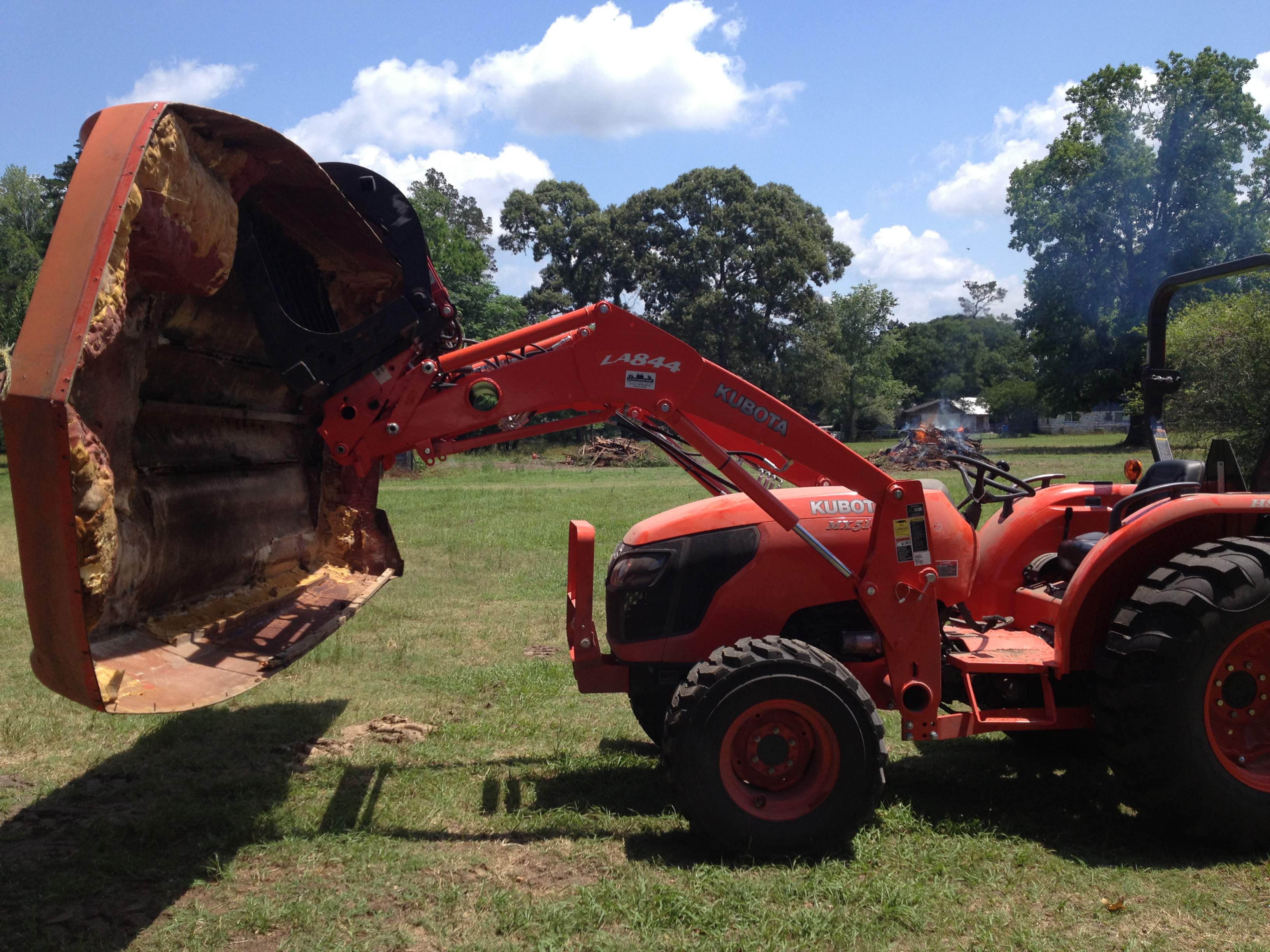

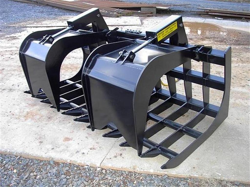

I went with the NAI 48" Light Duty Root Grapple.
My main decision factors were:
> Tractor is a Kubota L3540 w/ bigger loader (i.e. not too big)
> Maximize lifting capacity for moving logs
> Decent design & build quality
> Reasonable Price
It was $820 plus shipping (which was a decent chunk to Calif). I don't recall the weight, but it's one of the lightest. It has greaseable pins for all of the pivots.
I first used it to move brush to the burn pile and it worked great. I have also used it to move large oak logs and it lifts more than I expected. Like all other grapple owners, I'm very happy with it. :thumbsup:

Looks nice. Great price. The back is a bit shorter than mine which explains the slightly smaller max opening.
Happy grappling.

Caspar, when did you buy yours, I recently got a quote for $1016 plus $145 shipping. I noticed the grapple pictured in the link you posted has 7 bottom tines. Is the one pictured the 48" I thought the 48" only had 5 tines. I also noticed some photos so the bottom tines are straight while other are curled up, is this an option.
