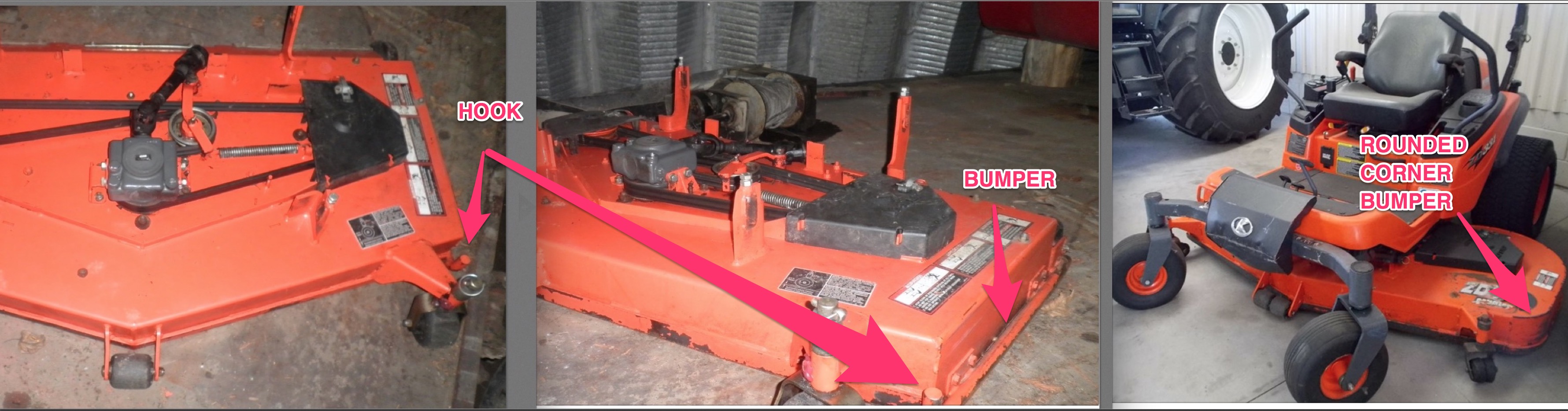

Hi JOHNTHOMAS , I have always used side discharge 3PH mowers but don't always like having the chute on one side.
When I bought my ZD I went with new. I originally wanted the rear discharge model thinking it would be better to let me cut close on both sides. The dealer sent me a demo model of each ZD to try on my lawn. I found that the rear discharge left a trail of clumps behind the machine. The side discharge spread out the grass clippings more evenly and left less clumps. I ended up buying the side discharge after the demo because I think it left a better finish.
Both models leave grass clippings to fertilize. The rear discharge just left more visible clumps of grass behind the machine.
With regards to the runners: Yes I have accidentally bumped trees, rocks and fence posts over the years. Based on the fact I know I'm probably going to bump something accidentally again in the future I like to see smooth edges on corders and bumpers on my equipment. I also like to see things like accessible grease fittings, sensible placement of controls, etc.
Here's what I'm talking about - look at the attached photo showing the side and rear discharge decks. The side discharge has a nice rounded front with steel flatbar bumper welded at the base. The rear discharge model uses a round bar that sticks out AND has a hook in the front. I think this hook idea is just bad design.
I guessBased on the fact I know I'm probably going to bump something accidentally again in the future I like to see smooth edges on corders and bumpers on my equipment. I also like to see things like accessible grease fittings, sensible placement of controls, etc.
I guess just a difference of opinion based on one trial vs several years of use. If I were buying today I'd buy the side with mulching kit and remove the side chute. What I did with my latest purchase of a BX2370 last year.
