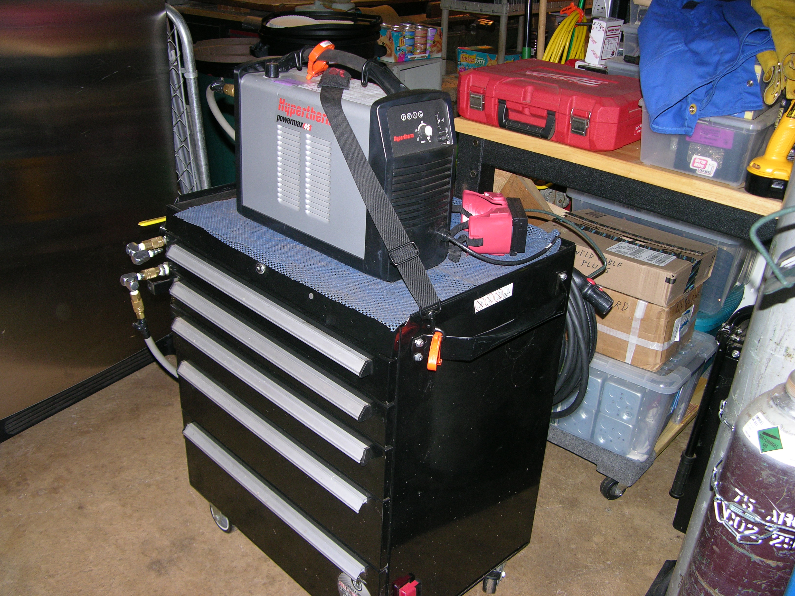

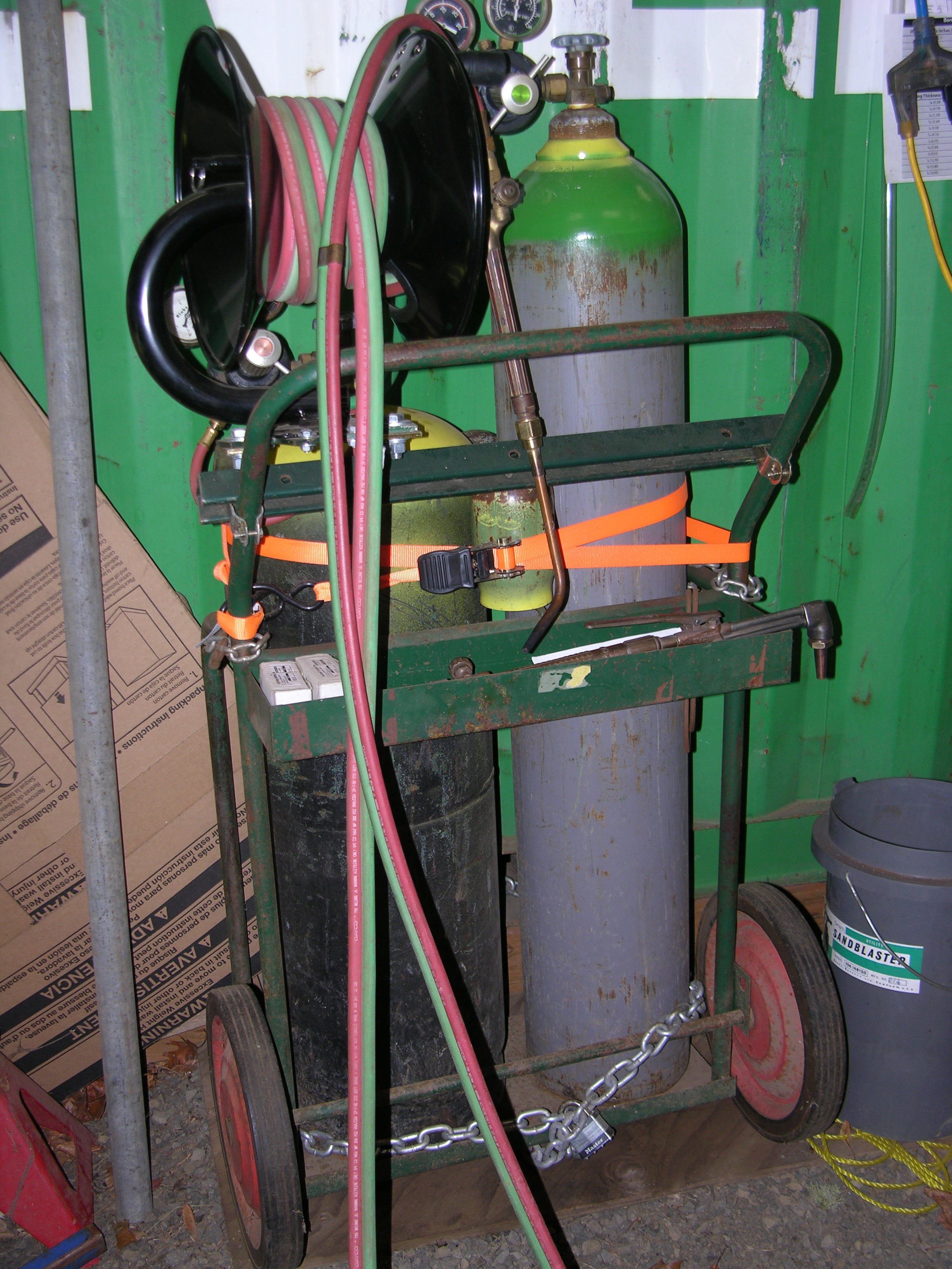

Obviously to each his own... small width plate can be easily handled with a chop or angled grinder with cut off wheel. Anything with a long cut or not straight... then plasma is your best friend. I admit... I am not from the O/A era so I don't have that to set aside. Yes I have used O/A for cutting but always my FIL equipment. When it became time to get serious with cutting, the plasma choice became obvious.

Cutting - old school vs. new school...
cutting stainless -
old school - don't bother; try it, you WON'T like it :confused:
new school - bring it on; if it's conductive, you can cut it...
Cutting thicker material -
old school - put a bigger tip on, turn up the pressure (tip about $10 on Ebay)
new school - buy a bigger plasma (from about $600 to a few THOU$AND)
Welding with same equipment -
old school (O/A) change torch tip, set regulators, grab coat hanger :) weld (no electricity necessary)
new school - buy a mig, tig and/or stick welder, plug in where plasma WAS ($300 - several THOU$AND)...
Heating, bending -
old school - rosebud, or cutting attachment (don't push the lever :eek: )
new school - use old school, or $$$ for induction heater...
Bottom line - BOTH have their uses, I wouldn't "kick 'em outa the shop fer eatin' crackers" :D ... Steve
