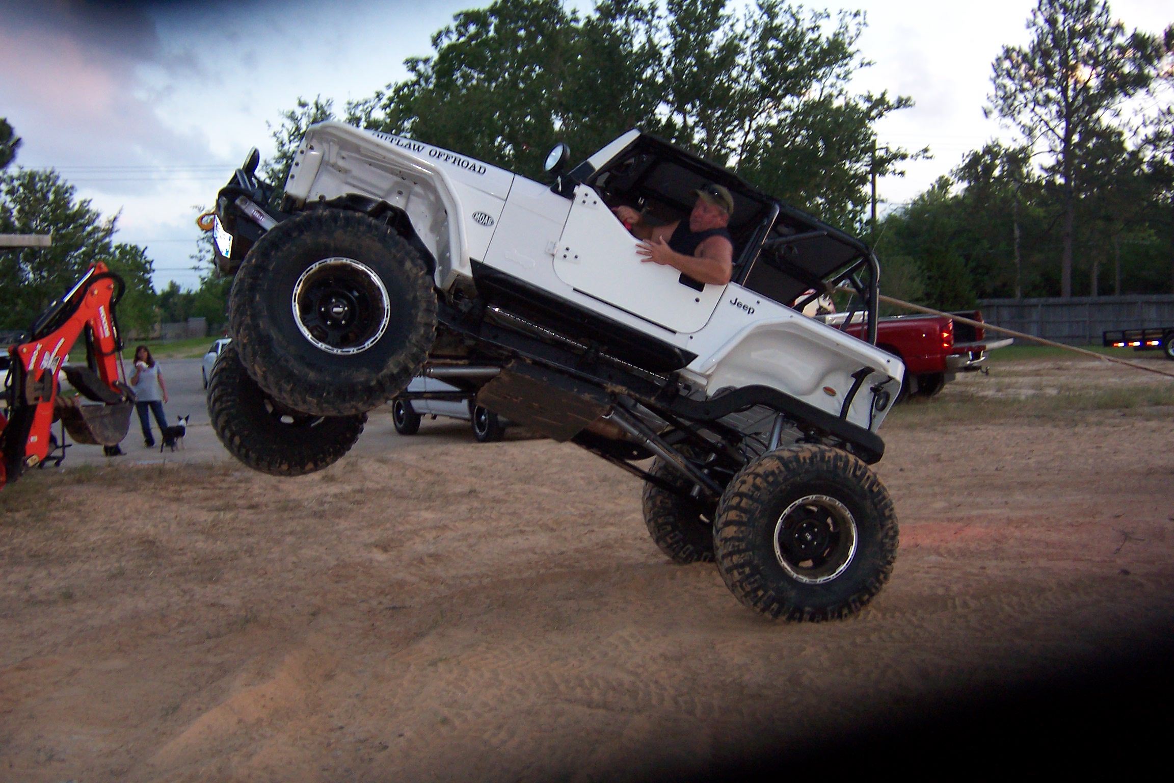

Hooking a strap to the cage is wrong on so many levels, I don't even know where to begin.
Agreed, but he did prove his point to a certain degree that the modifications to his factory cage did strengthen it quite a bit... The wheelie and pulling the H3 off the sand pile did no damage to the cage.
