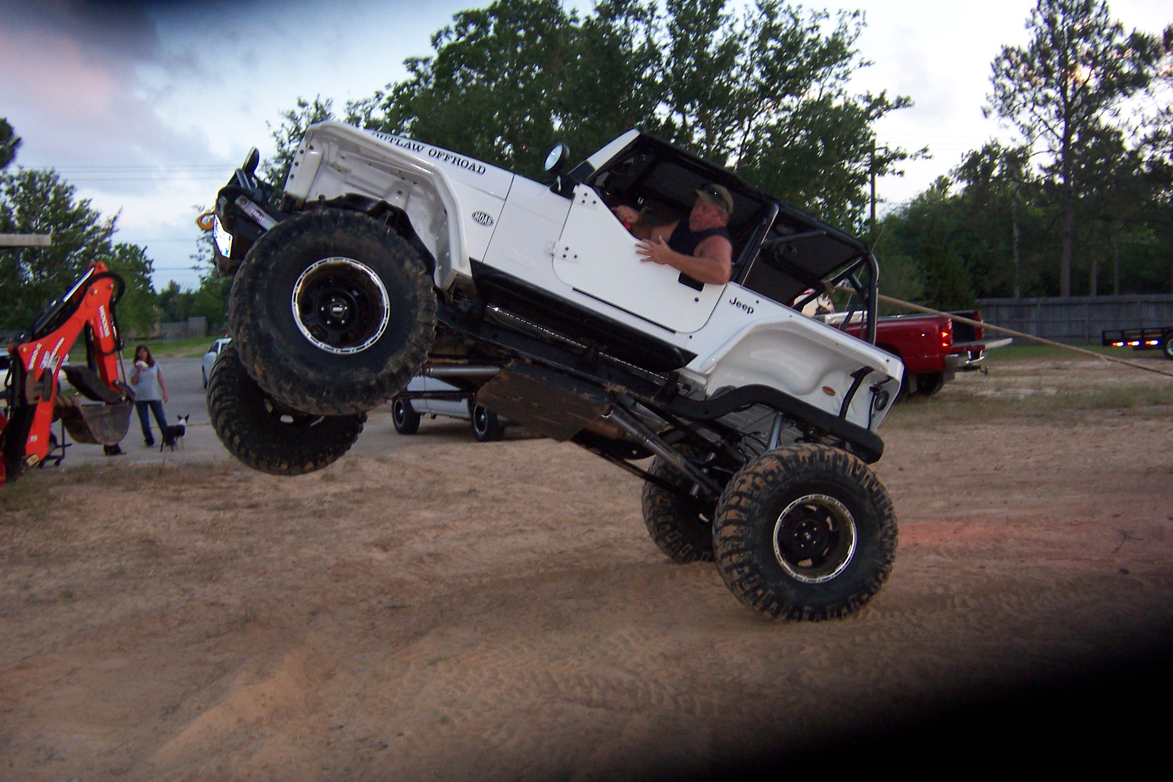

I wish the pictures off cheesey cell phone camera had came out better of my tractor against my buddies highly modified jeep :D
After a bit of trash talking ;) my buddy insisted his jeep would out pull my tractor, him having lockers front and back gave him a bit of advantage. So to level the playing field I picked up a full bucket of sand with the FEL. We hooked the strap up and I drug him around the sand covered hard gumbo field like a play toy:D :D
After listening to him complain about the sand I politely dump the sand and hooked back up to him... To my amazement it was a draw, He was spinning all 4 13.50" x 37" Baja Claws wildley I was in double low barely spining 3 tires, and yes I do have the dreaded R4's...
Heres some pics of the jeep and where not to hook the strap to...

Hooking a strap to the cage is wrong on so many levels, I don't even know where to begin.
Agreed, but he did prove his point to a certain degree that the modifications to his factory cage did strengthen it quite a bit... The wheelie and pulling the H3 off the sand pile did no damage to the cage.
