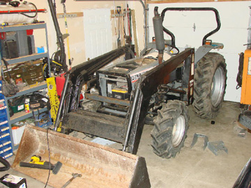

White fieldboss 2.jpg Welp fellers, here finally is a picture of the old girl, My Field Boss 37 (Iseki TE4370), in one of many states of repair:rolleyes: I am having one heck of a time figuring out why this PTO wont work. Maybe someone in computer land can help. Ok, this is what I have done so far: There is a gear shift lever that mechanically engages and disengages the drive gears for the PTO. This is working... The PTO spins freely when disengaged and does not when engaged- makes sense right? Next, there is a switch on the dash that controls a solenoid that provides oil flow to the PTO control valve. Switch in on position, I have 12 volts at the solenoid and I can hear the solenoid pull in.Turn switch off solenoid returns to open. Next, there is a clutch lever on the trans case that controls oil flow to the PTO control valve and the rate at which the PTO engages. The lever when moved forward, pushes in a plunger on the valve assembly and I presume alows oil to flow. The plunger appears to be going all the way in when engaged. Oh and of course I have checked the oil level. I'm not really sure what to check next. Any suggestions would be greatly appreciated. Thanks, Tony K. P.S. I have all the manuals for this tractor so If I can help someone else with a diagram, Part# etc. please let me know.;)

:) Well I found the problem or should I say problem's. First of all I pulled the filter and found it was completely coated with some sort of slimey film. It was so bad I'm suprised anything hydraulic worked at all. So I boiled it clean and reinstalled it thinking this was the fix but The PTO still would not turn. So then I removed the valve assembly and found the valve for the PTO was bound up so I tapped it out with a straight punch and hammer, removed the small amout of corrosion, removed and cleaned all the spools/ valves re-assembled it and re- installed it and alah - peanut butter sandwhiches the PTO came back from the dead. So, now all I need to do is load - test it and hopefully that will be that.:D
