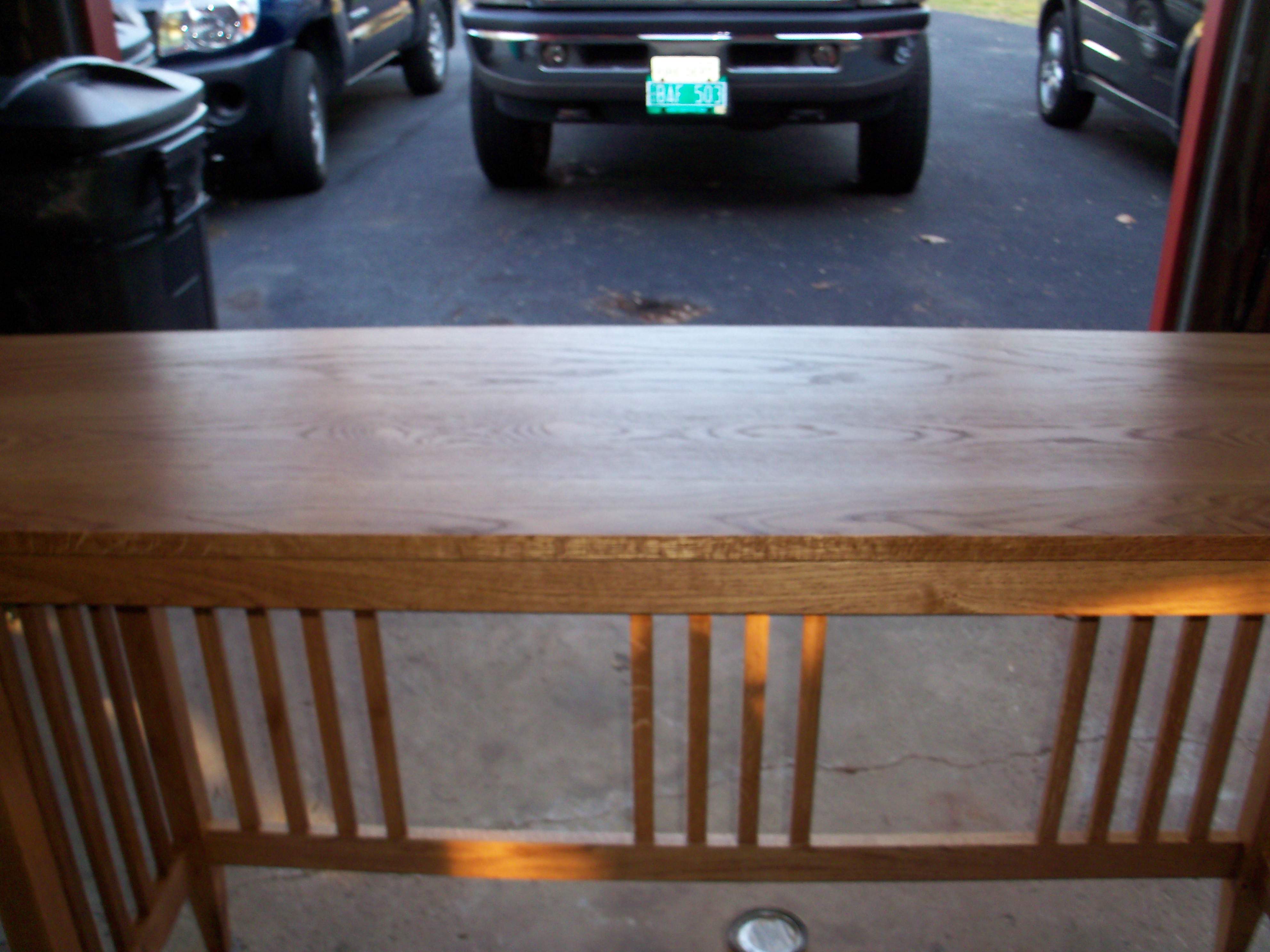

Good Afternoon Guys,
Cliff, good to hear you on along with some of my other TBN friends !

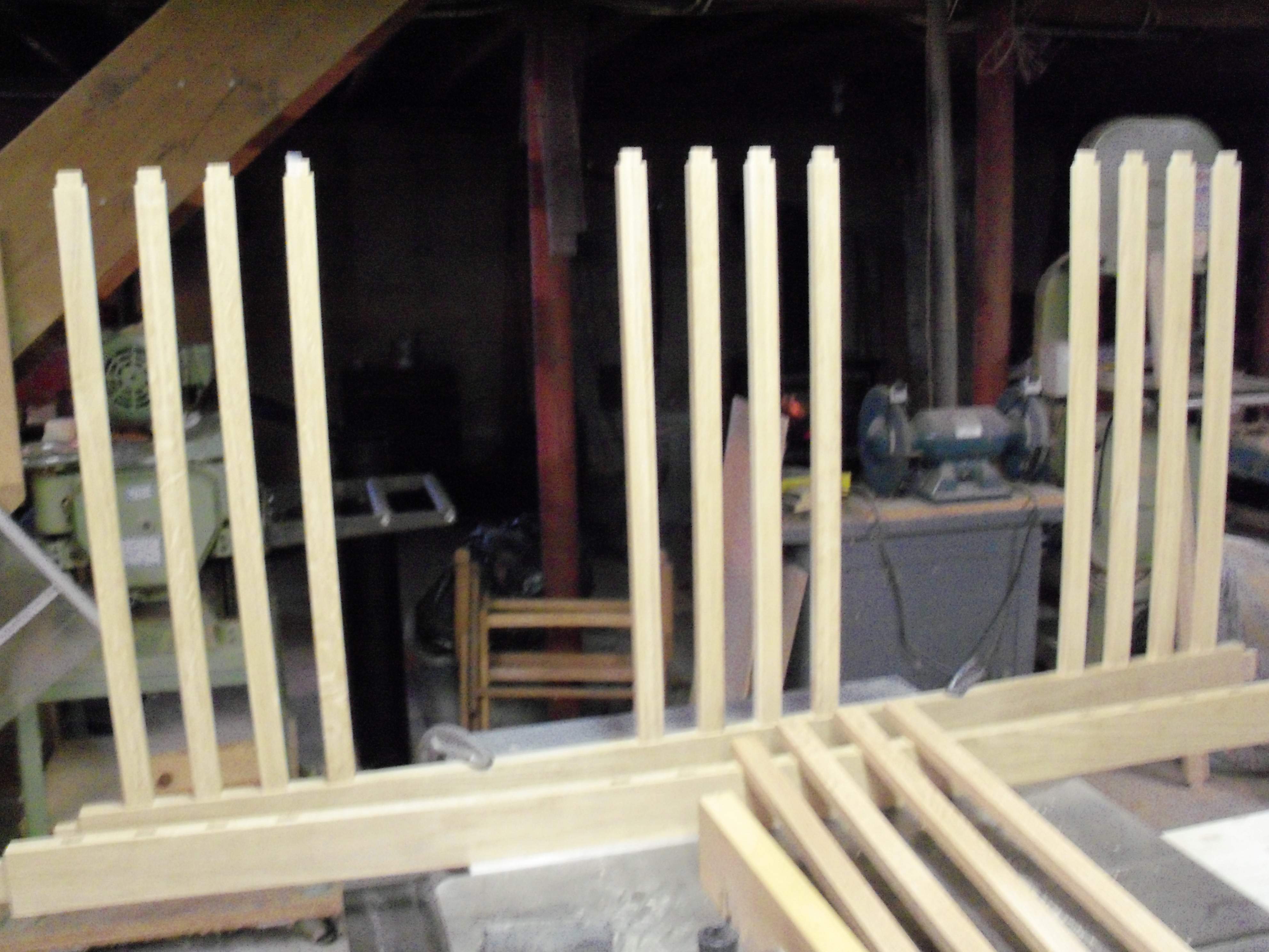

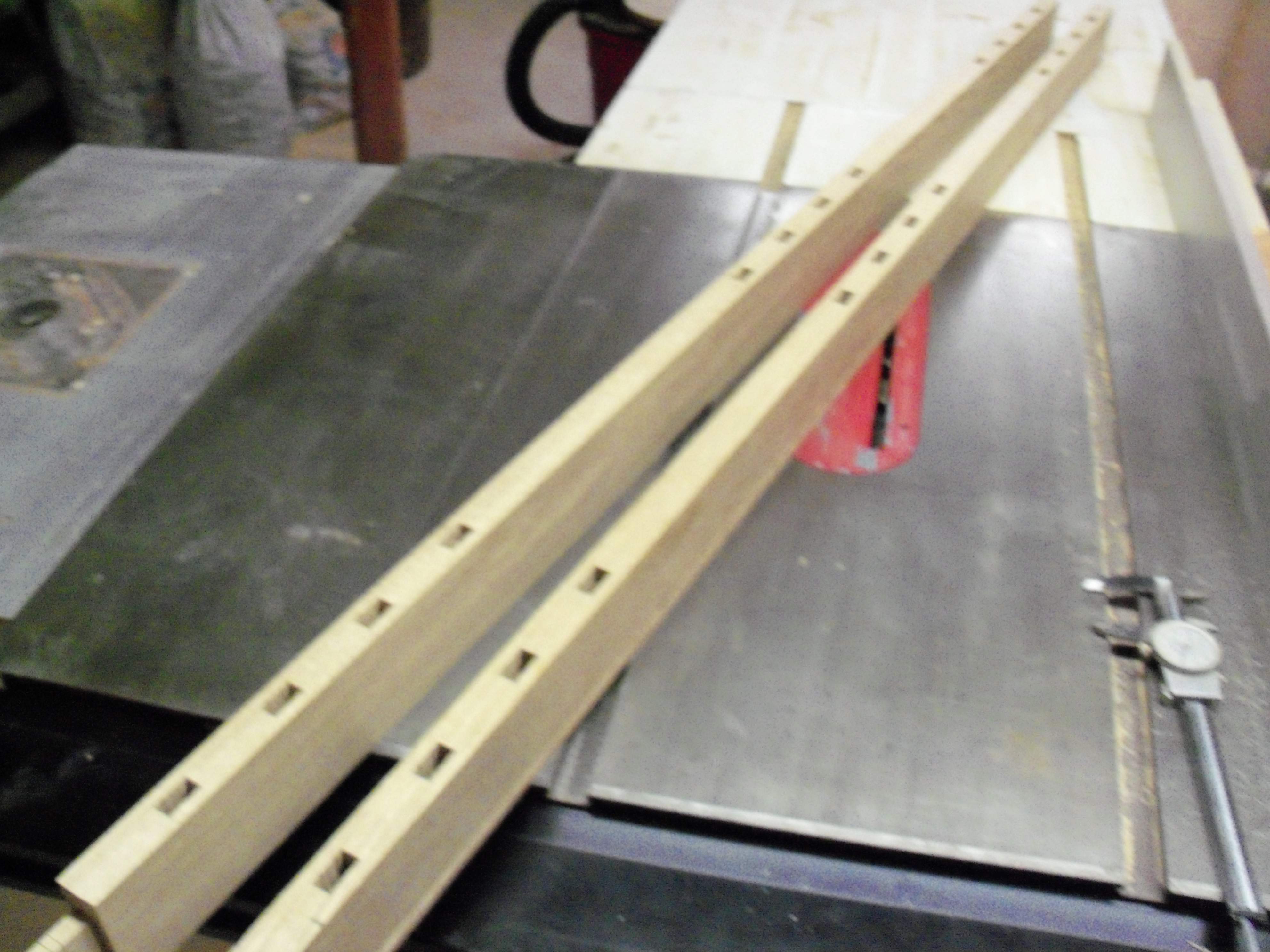

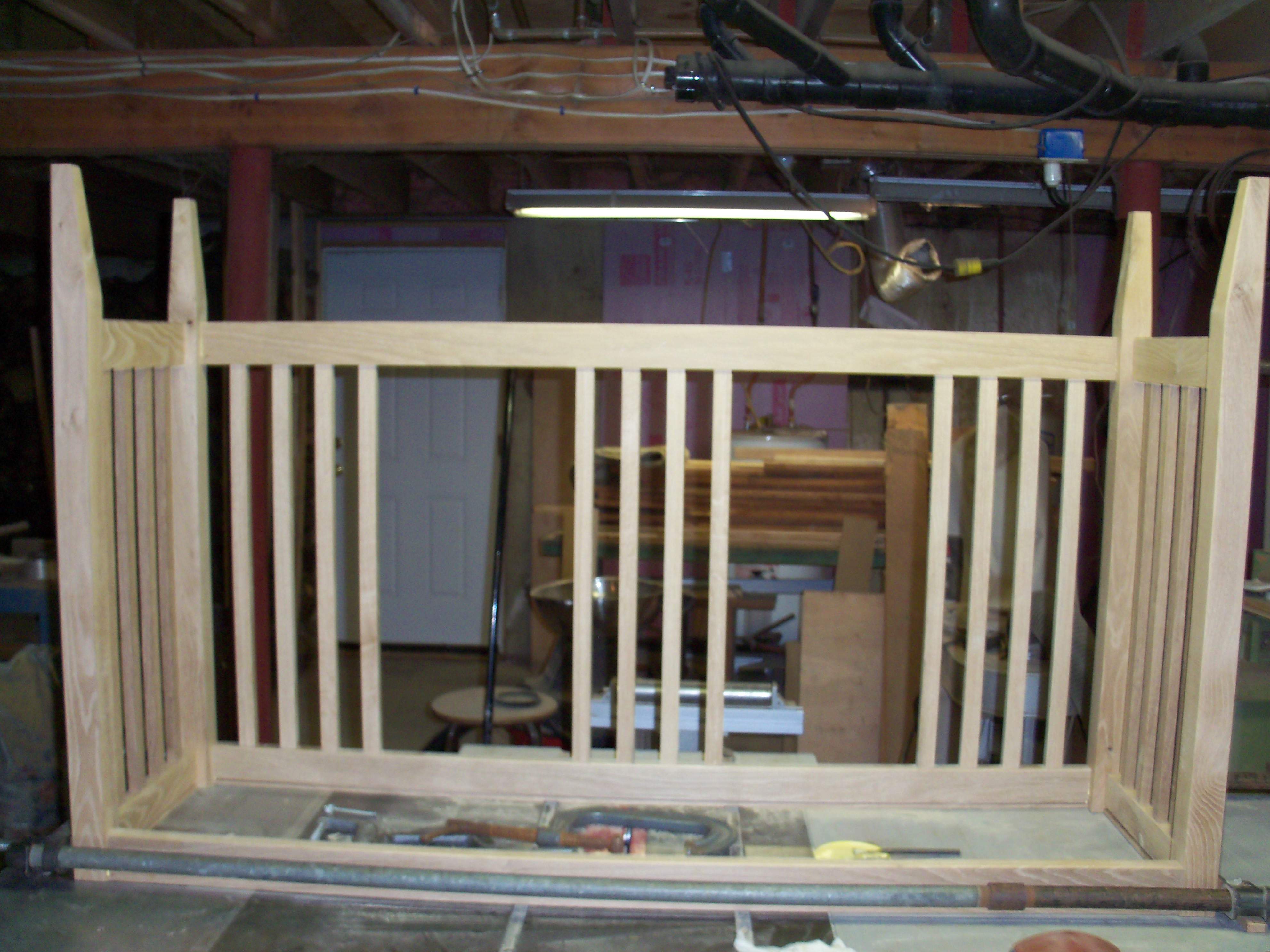

I had a chance to get some more work done on the table. I layed out the long rails between the table ends and cut all the mortices. I believe on a previous post I wrongly mentioned that the slat tenons were 1/4", sorry that is incorrect, they are 3/8" along with all the other mortices in this project ! They are 3/8" by 3/4", and all the slats are 5/8" by 1", which makes forming the tenons quite easy because all the relief cuts are 1/8".
I milled up the stock for the slats and mistakenly grabbed a piece of oak that didnt have the same coloring as all the other slats... So I had to do that whole operation over again, kind of a pain but the coloring difference would have really stood out like a sore thumb.....
I dont think I mentioned it earlier, but when I glued up the ends, I try to be very careful on the amount that I use. Excessive squeez out on the joints is a real pain to clean up, and really isnt necessary for a strong joint. If I do get a small amount, I use a dampened rag, and after the joint has a few minutes of setup time, I will use a single edged razor for final cleanup.
If your not carefull when doing this, when you attempt to stain your piece, the stain wont penetrate that area, making for a sloppy job...
I fitted all the slats in between the long rails, and then checked to see if the ends would fit properly. All table surfaces will get dampened lightly with a sponge to raise the grain, and then sanded once again. And then everything will be finished sanded. Im not quite to that point yet...
Here are a few pics to bring you up to date...
I decided to use three equally spaced slat formations on the back rail, rather than slats all the way across. If you recall, there will be three matching stools, so something to break up the monotony of nothing but slats...
BTW I forgot to mention that since the 1" side of all the slats are cut from flat sawn stock they reveal some very nive ray pattern, the photos dont pick it up but Im sure when the piece is stained it will standout...
