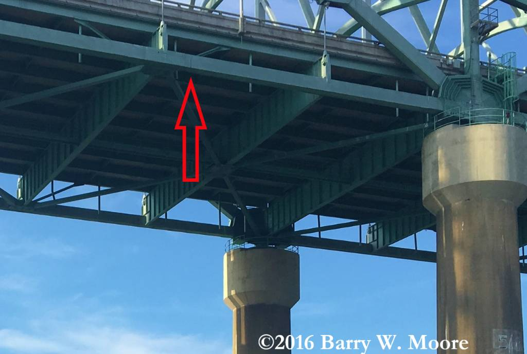

   / Who Broke The Bridge? #100
Picture from '16 here:
It's fairly large, so I don't want to embed it.

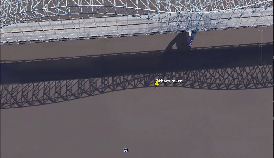

Picture #1 Photos of the Hernando de Soto bride, captured by Memphis resident Barry Moore during an August 2016 canoe trip, suggest the fracture in the steel box beam began much earlier than previously acknowledged.
Picture #2: Based on the meta data from Barry Moore's submitted photo taken in 2016, the Commercial Appeal input the coordinates (35° 9' 13.40"N, 90° 3' 40.00" W) into Google Earth to find approximate location that the photo was captured.
