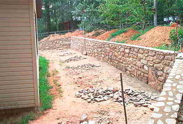

   / Who else likes rocks? #64
I thought I would post a few pictures of the finished stone wall my father-in-law and myself built.
Mike

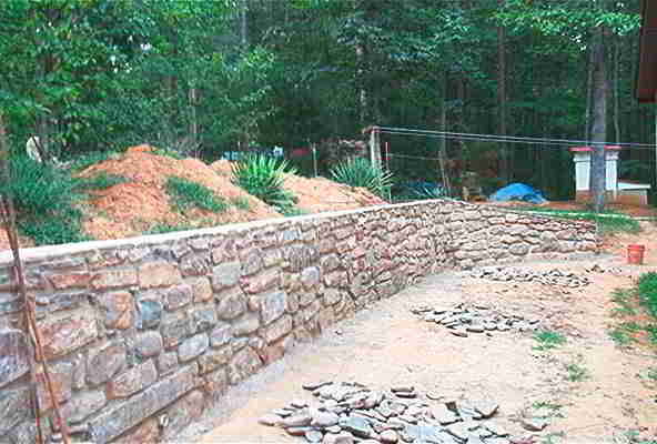

   / Who else likes rocks? #65
Picture #2.
Mike

   / Who else likes rocks? #67
Very nice!!!
#69
That's a beautiful wall Mike. Congratulations to you and your father-in-law. Really nice to see one done right, by folks who care. I love the way you incorporated the larger, odd shaped rocks in the composition.
Thanks for posting the inspiration.
Dave
