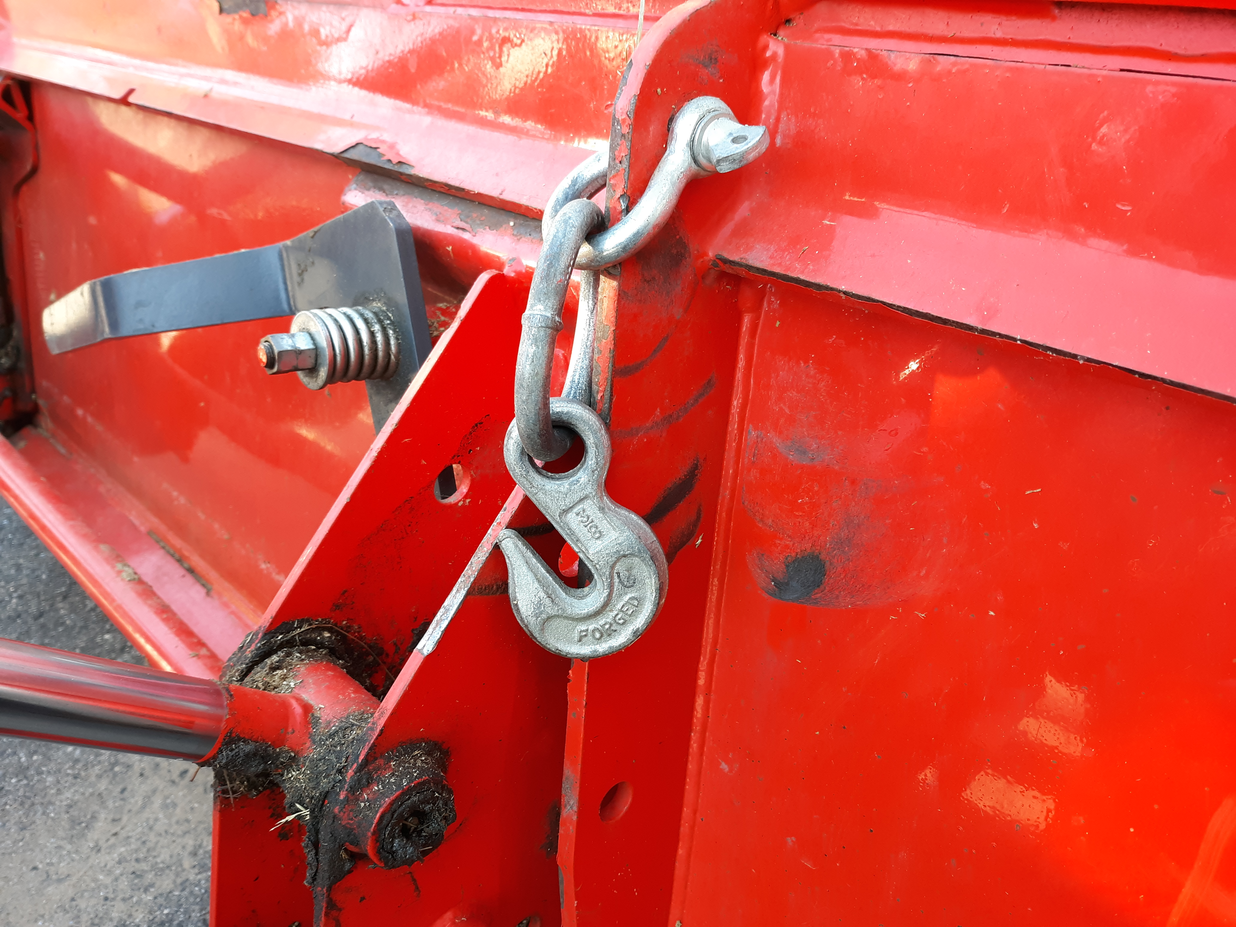

   / Who has installed Bolt On Hooks to their LA1065 bucket #6
Peter 315, I like that attachment method, simple and sturdy. Thanks

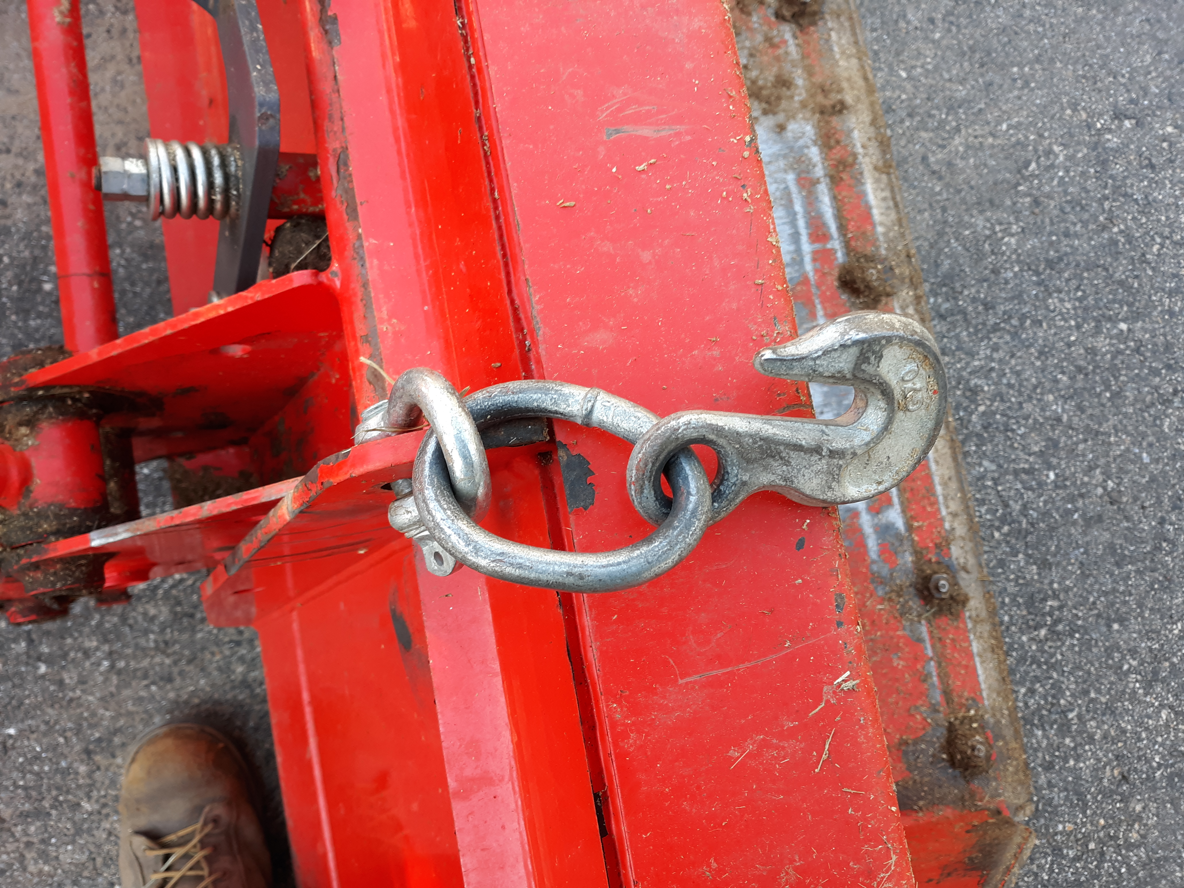

   / Who has installed Bolt On Hooks to their LA1065 bucket #8
