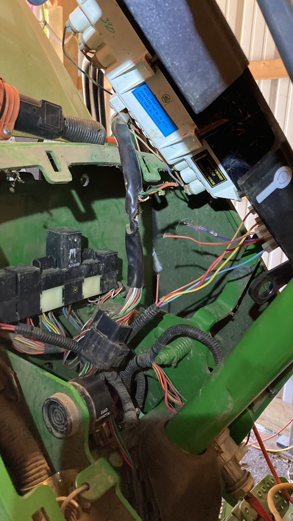

Mice got into wiring behind my tractor’s instrument- gauge panel cluster. Tractor is a Deere 5075E, Tier II, OOS.
They got a couple wires from a big harness to spade terminals on the light switch. I think I can easily butt splice them back together.

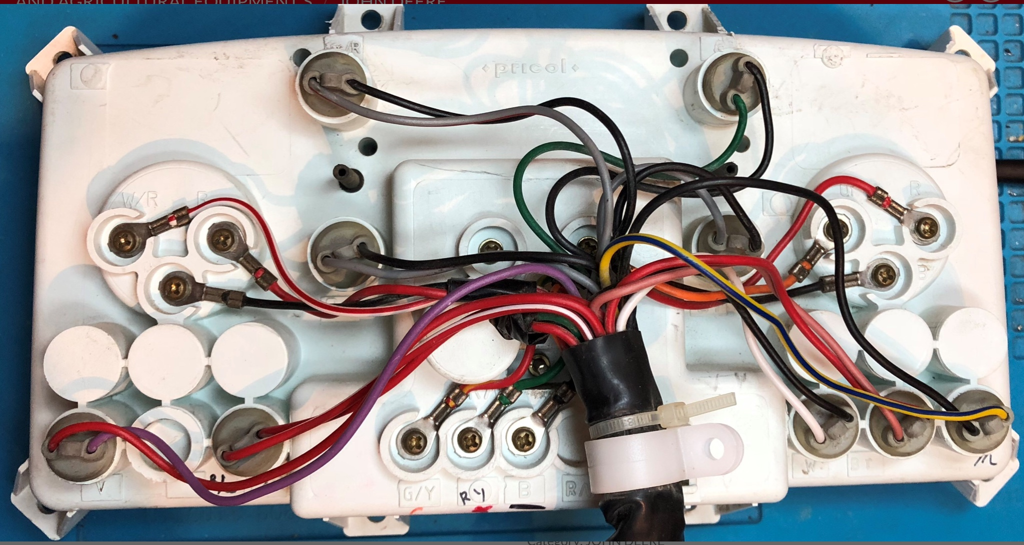

Mice chewed about 6 wires on a (pigtail )wiring harness/connector cable. Cable is about 12” long, about 18 conductors, and goes from a connector that plugs into main harness, to the back of the panel cluster (part #RE252154). Cable has lamps that go into cluster and wires that terminate on cluster (See pic #2).
I called various sellers, near and far, and nobody can tell me if cable comes with RE252154 panel cluster or can be bought separately.
Who knows a seller or salvage yard that might sell cable?
If the pigtail cable has to come with a panel, I’d probably only buy panel to get cable if it’s cheap. Otherwise, I think I’m splicing. Any tips?
It’s like nobody nowadays can actually go look at the things they sell. There’s only information on their screen or you’re S.O.L.
2nd pic is from the internet.

Only have the two wires to the light switch patched so far.
On the panel’s cable I can match the 8 broken wires colors to their counter part. But the panel side has 10 broken wire ends??? Two extra reds. I’m guessing (!) they all get connected together?
