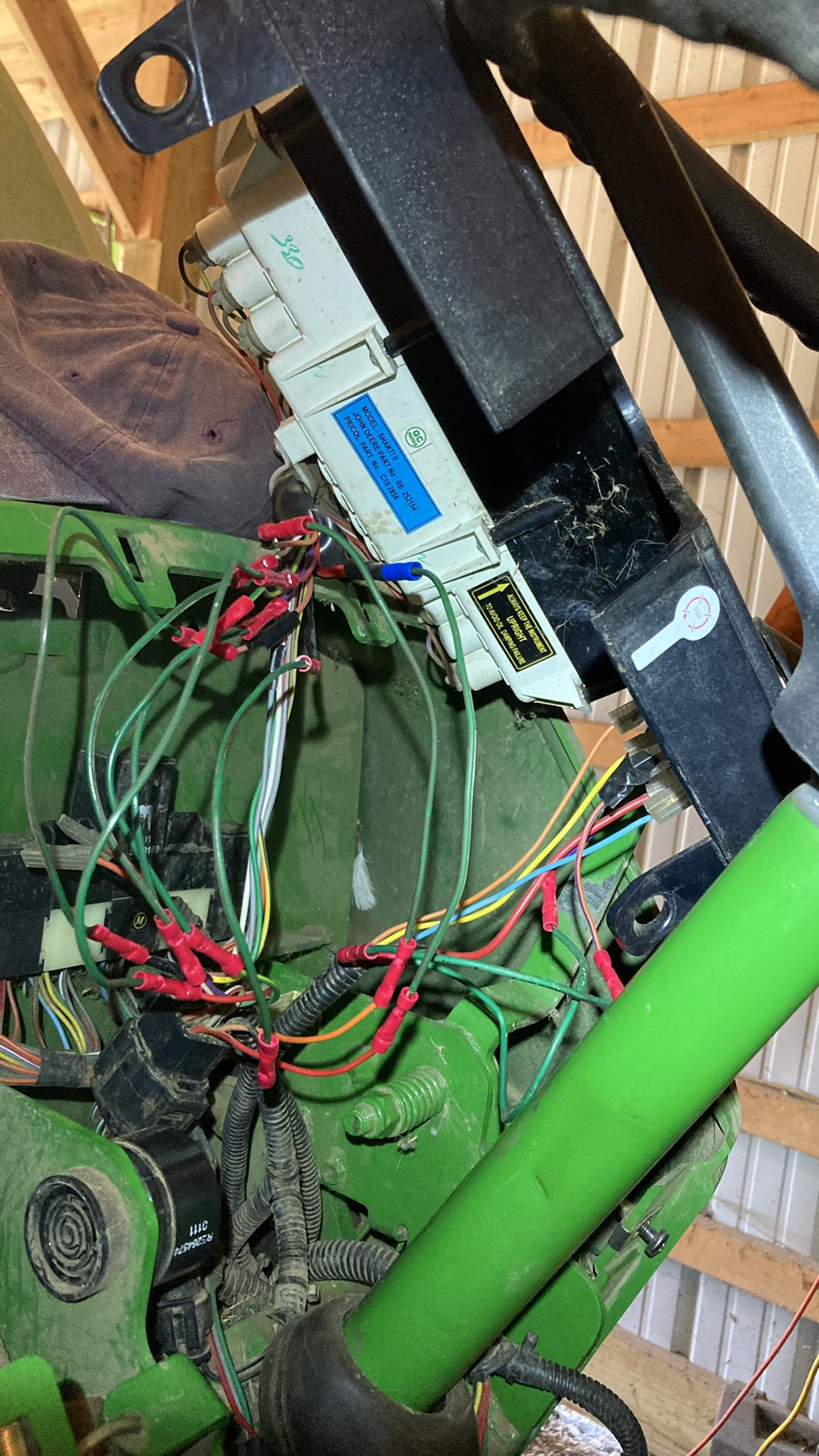

Mice got into wiring behind my tractor’s instrument- gauge panel cluster. Tractor is a Deere 5075E, Tier II, OOS.
They got a couple wires from a big harness to spade terminals on the light switch. I think I can easily butt splice them back together.
Mice chewed about 6 wires on a (pigtail )wiring harness/connector cable. Cable is about 12” long, about 18 conductors, and goes from a connector that plugs into main harness, to the back of the panel cluster (part #RE252154). Cable has lamps that go into cluster and wires that terminate on cluster (See pic #2).
I called various sellers, near and far, and nobody can tell me if cable comes with RE252154 panel cluster or can be bought separately.
Who knows a seller or salvage yard that might sell cable?
If the pigtail cable has to come with a panel, I’d probably only buy panel to get cable if it’s cheap. Otherwise, I think I’m splicing. Any tips?

2nd pic is from the internet.
View attachment 693619View attachment 693620

Sikeston MO has Worthington Ag Parts and All State Ag Parts. I've never dealt with either but both are right next door to each other. When mice and rats ate my Kioti wiring I just butt spliced it all back together.

Splice it, it was: Coming off the panel was 10 cut wires connecting to 8 cut wires. Coming off light switch was 2 cut wires. That 42 wire ends to strip, and making 42 wire connections on 20 butt connectors . Make your own jokes on where this is a pain.
What’s some good tips on keeping mice out. Dryer sheets, poison, spray with bleach (bad for electric connections?), traps, leaving panel open in winter.
The #*&%’ers have a whole mow of hay 10’ feet away to nest in. I know it’s 2021 and we’re supposed to be all kumbaya with animals, but I want to kill every last one of them rat ***tards!
