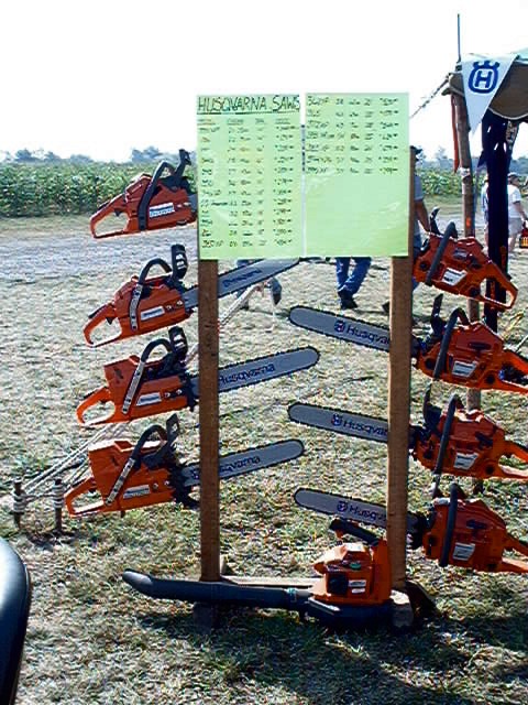

from Empire Farm Days booth...Husky pricing {must enlarge or have eagle eyes /w3tcompact/icons/smile.gif?}...
