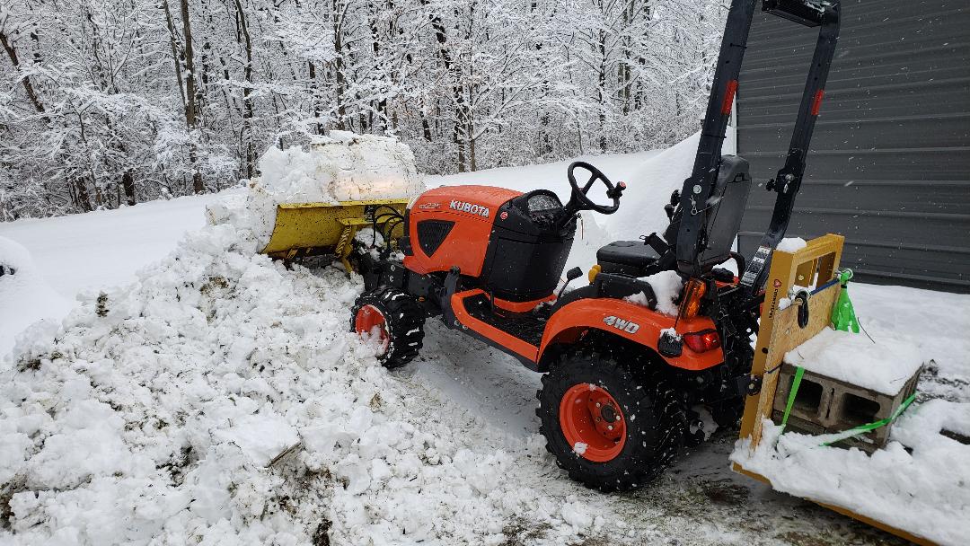

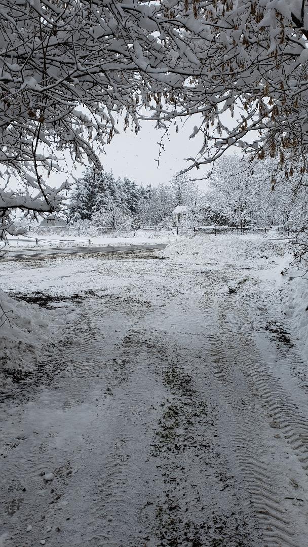

Well, for those that wondered... here is how the JD 54" blade turned out on my BX23s. We got a foot of snow last night, plowed with it today, worked flawlessly. Not one single issue.
Checked everything all over after plowing, everything held up very well. No bolts loosened up, all the welds held perfect on the additional plate i put in for bracing and to attach it to the kubota.

Posted couple pics for yah... the JD 54" blade worked out awesome Tom, couldnt ask for it to work any better. I am VERY happy with it!!! Thank you for the kind words too.

Thanks ruff. We got a foot of snow last night, i wasnt sure how it would do, but oh man, this little BX tractor is a monster...lol. I thru my carry-all on the 3pt hitch, added some concrete blocks, and away we went.
Not once did it spin a wheel the whole time i was plowing. I have a set of chains for it, but i wanted to see how it would do without the chains... turns out i didnt even need them at all. Rear tires are loaded.
This little BX tractor never bogged down once. It didnt care how much snow it was pushing. The snow was very wet too. I even got my wife out there plowing with it today...lol. (she loved it!)
